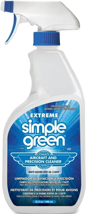

I use a 50/50 mix of simple green for all metal except aluminum.
It will wreck aluminum.

I think I'm good for aluminum. I have a rugged oculus (all stainless I think) 2 dead air Wolfman (wolfmen?) and a Huxwrx 762TI.
I saw simple green has an aircraft solution.  If I go with simple green I may get that to be on the safe side.

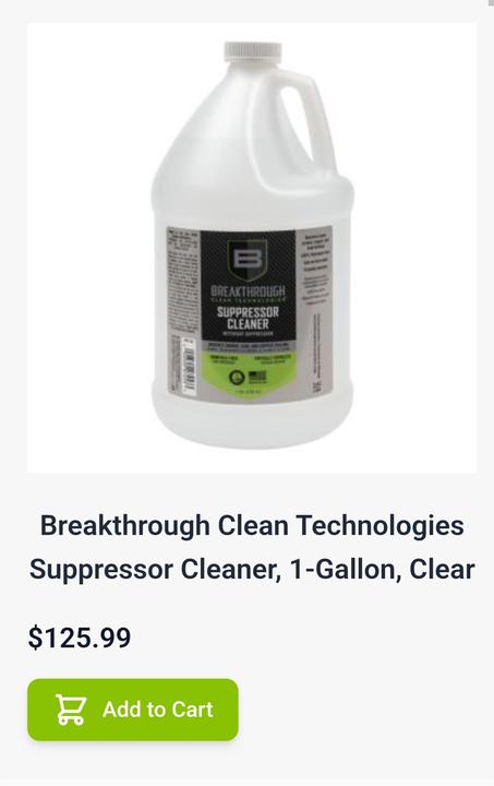

Hornady’s ultrasonic cleaner works well and has never damaged anything. Breakthrough suppressor cleaner works well too. If you’re using the ziploc bags, use name brand freezer bags. Glass jars also work well too.

How does the cleaner penetrate the glass jars or baggies? Thinking about getting my first cleaner.
7/27/2026 7:55:58 AM EDT
Just dump a gallon of  breakthrough suppressor cleaner directly in there.
Cans, baffles, AR BCGs, AR receivers, other bolts, 22LR receivers, 1911 top ends… that shit is amazing.
Solution in the bag/jar.
Regular water in the rest of the tank.

This right here. Breakthrough works a lot better at a higher energy state, but you don't have to heat the ziploc with BT itself- heated water in the tank is sufficient.
I have a deep sink with a faucet wand where I site my Hornady 7L , and I put in a gallon ziploc with about a pint of BT (enough to fully submerge the suppressor), let the water run and get up to temp, say 110+, and fill around it with the hot water, then start a cycle. Works great.
It takes away some of the visual impact when you can't see it.
7/27/2026 6:29:23 PM EDT
So, using these baggie methods with hot water and Breakthrough should work good on flow through suppressors without damaging cerakoting or the suppressors themselves?

7/31/2026 10:06:11 PM EDT
Yeah, the stuff works like magic, and magic sure ain't cheap.
Its chemical cost is about $62 and it has to be exposed of by an industrial waste disposal company.  Even before it is used the only safe way to dispose of the chemicals is industrial incineration.

No. However if you’ll be using it in an ultrasonic, you can use the jar/bag method and minimize how much you use by not filling your whole tank with it.
