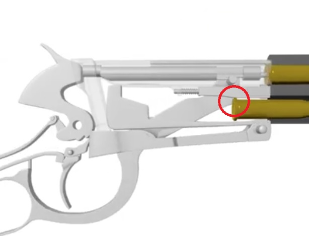

Not the best:
Winchester Model 1894 Rifle
Brought to you by Carl's Jr.
11/29/2025 8:27:58 PM EDT
[Last Edit: WantGrape][Edited] [#10]
Originally Posted By 0100010:
Not the best:
https://www.youtube.com/watch?v=h8Y_Q0NYWio
That makes it look like something on the lever is keeping the shell in the magazine.
11/30/2025 5:33:26 PM EDT
So the gate is the secondary stop?
11/30/2025 8:42:17 PM EDT
Gate when lever up, catch when lever down.
12/1/2025 9:28:50 PM EDT
[Last Edit: WantGrape][Edited] [#14]
Ok I'll order a new gate. If I can even find one.
ETA I thought about it and now Im not seeing how the loading gate can hold the shell. Like ok maybe it holds it, but what would cause it to release the shell to allow it to move all the way to the rear? Like the gate doesnt move. Unless it's the gate in combination with some other part.
