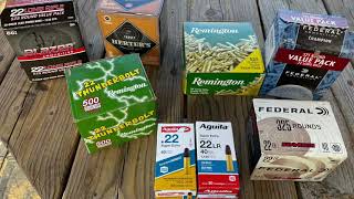

Most any full-auto .22 conversion can be finicky, and the Uzi version is no exception.  And it seems what might work for one doesn't work for another of the exact same brand/make/model at times.
Lots of good info on how to tune an Uzi .22 conversion here.
As Dakota_Don notes, you need to go figure out what ammo your individual kit likes.  And then keep in mind, ammo manufacturers tweak their products over time.  Federal Bulk Pack ammo used to be my go-to Uzi .22 ammo, but around 10 years ago I started running into problems with this ammo, not only in the Uzi, but in other short-barreled firearms.  Since the ammo had been good previously, I assumed it was still fine.  I went through different mags, springs, and anything else I could think.  I finally tried a different ammo, and it was like night and day.
For my Uzi, the "crappy" Rem Thunderbolt or the Rem Golden Bullet both perform marvelously.  Here's an example:
And here was some testing with various types of ammo.
"Bulk Pack" .22LR Full-Auto Testing
