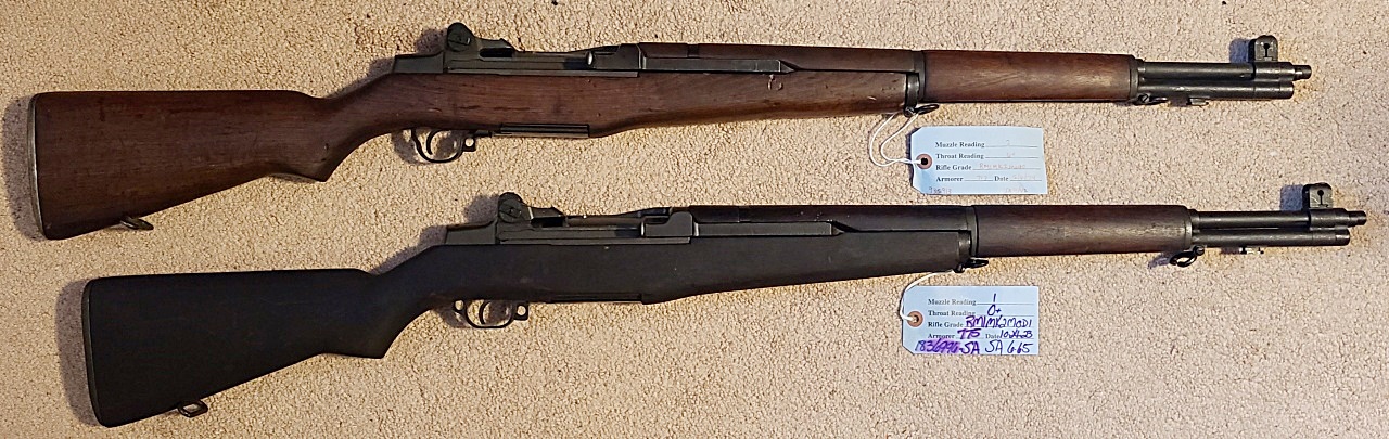

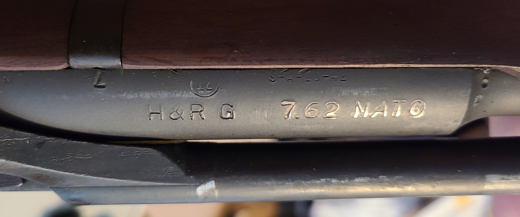

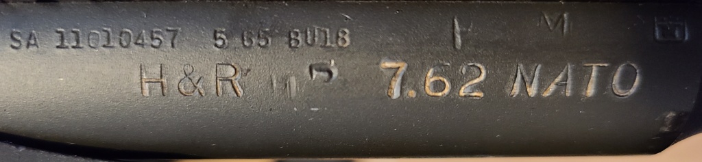

My 2 Navy rifles.  Top is a Mod 0 with what seems likely to be an original receiver/barrel combo from 1942, converted by H&R with the insert.  Bottom is a Mod 1 with a practically new 7.62 chamber barrel (also H&R conversion).
Mod 0 barrel markings
Mod 1 barrel markings
Hope this helps!
Rob
