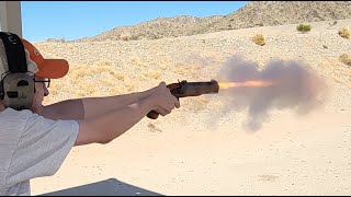

But a buddy of mine, a real gunsmith, thinks about what-if games, like what if I run out of percussion caps but I still want to shoot my favorite muzzle loading rifle?
The answer nobody asked for, but it's really cool. Got to fire it too - the time from pow to bang is VERY short.

Oh, OK, like when he made this one? He had a barrel stub left over after saving my son's rifle from Bubba, and a few locks to play with, so for grins and giggles he built this for fun. I liked it so much I bought it from him for my son. He made the trigger guard, nose cap, sights, (that rear sight was a single block of steel), ramrod, the whole thing, just as a rough cut lark. This was just a way to kill time.
But it was sister to another he built the same way, again, same time, just a barrel and a lock. The curved grip was odd, but comfortable.
The earlier trigger guard - it was not comfortable, so he made his own.
Some more making of pictures.
Front sight.
These are the parts he started off with to make both pistols. The one I have is .54 caliber - I think the other is .50.
And the stocks are made from this block of wood from his mesquite tree in the back yard.
