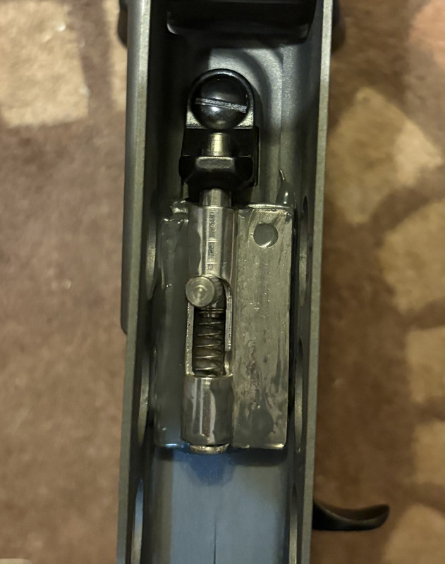

I decided to pick up one of SPAS-12 clones. Made in Turkey. Looks amazing. Digging the two tone look. First time shooting it ran perfect on pump mode.
Semi-auto mode functioned properly once you got it loaded. Unfortunately sometimes it would double feed on the initial loading. Worked better when I tossed a round into the chamber and hit the bolt release and then loaded the rest in the mag tube. Ran birdshot and buckshot just fine.
Mag tube holds 5 rounds. Has a couple of things limiting the capacity. You take apart the mag tube extension. Removed the plug using a flat head screwdriver. Then used a 6-1 screwdriver hex part to remove this rod inside the mag extension. The spring looks too short though. So I ordered a couple extended springs. Was able to install a Wolff spring without cutting it. Not easy to get it in there though. May have to trim it. The tube now holds 8 rounds so that's cool.
Playing around with the folding stock I realized when it's folded you can't use the hook as a carry handle because the stock will unfold accidentally. On the original there's a latch locking into the rear sight and it's a solid carry handle. On the clone it relies solely on the stock button which isn't enough. Update: Just realized it is unfolding so easy now because the rear pin loosened itself. I tightened it up and now it's not unfolding as easily. Still don't trust it though.
May try and make my own latch for the rear sight at some point. The rear sight is about 5.5mm in diameter. Ordered a couple spring pin latches off Amazon. I'll see if I can install one onto the folding stock properly.
Overall it looks amazing and gets lots of compliments at the range. Going to try it again tomorrow with the new larger mag capacity and see how it runs in semi. I also tore it down and cleaned and lubed it well.

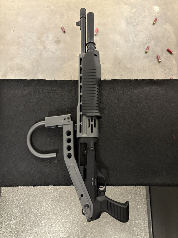

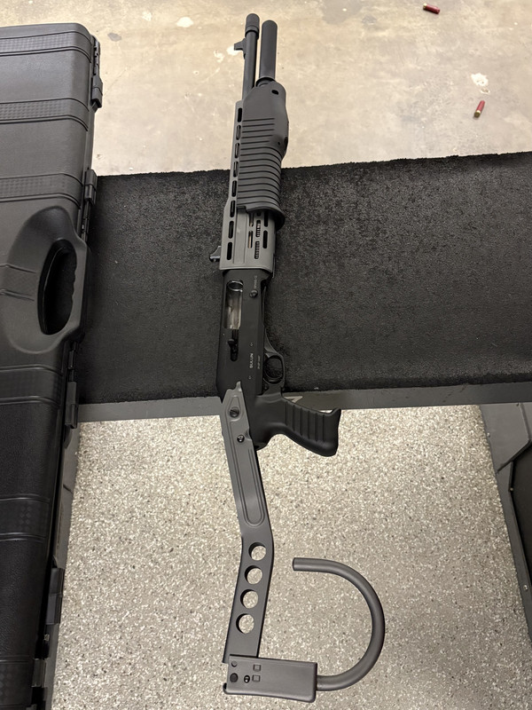

Ok so I took it shooting again. This time with slugs!! In pump action the recoil was harsh!! Had to pick my face off the metal stock because it was digging into my cheek. In semi-auto the recoil was far more manageable.
In pump action it was completely reliable. In semi-auto it was jamming a lot more often compared to birdshot and buckshot.
After shooting I noticed the detent on the hook was missing!! It must have fell off due to the harsh recoil from the slugs!! So no one handed shooting until I fix it, ha
E-mailed Blitz Kraig and they answered me back quickly!! They are sending me a new stock detent to fix the hook. And a new trigger group to fix the semi-auto function. Said I need to bend the loading ramp to time it correctly. Said it might break, so that's why they are sending me a spare just in case. They also did in fact say a new stock upgrade is coming soon. I'll get a discount rate being a Gen 1 owner. I'll keep you all posted. Happy with their customer service so far. That's one thing the originals don't have, ha

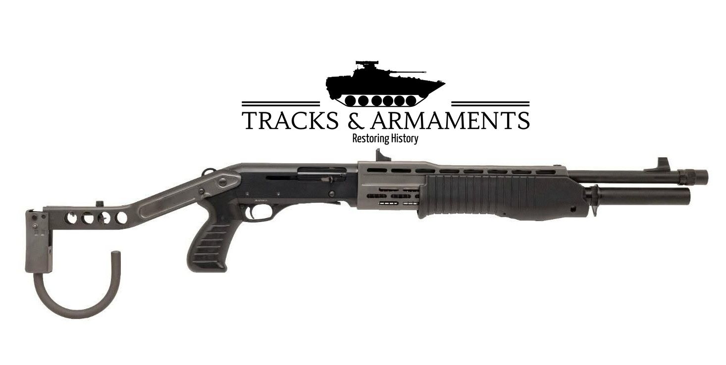

Evidently they are coming out with a Gen-2 to address some of the issues with the SPAS clones.
I am curious - were there any SBS versions of the SPAS-12?
I'd almost be tempted to mover the front sight back and live with the shorter mag tube
https://tracksandarmaments.com/products/Sulun-SLN-12-Gen-2-SPAS-12-Clone-12GA-p853039637

Looks good.  May have to actually consider one of these.

Speaking of Track and Armaments:
GEN 2 Sulun "SPASS-12" vs Original Franchi SPAS-12: A Detailed breakdown of the SLN-12
9/2/2026 6:53:21 PM EDT
Man that new Gen 2 version looks much better!! I might end up selling my Gen 1 gun and pick up the Gen 2 when it becomes available. Looks like I may have jumped the gun on this one, haha

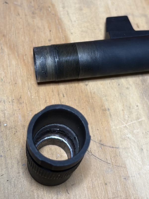

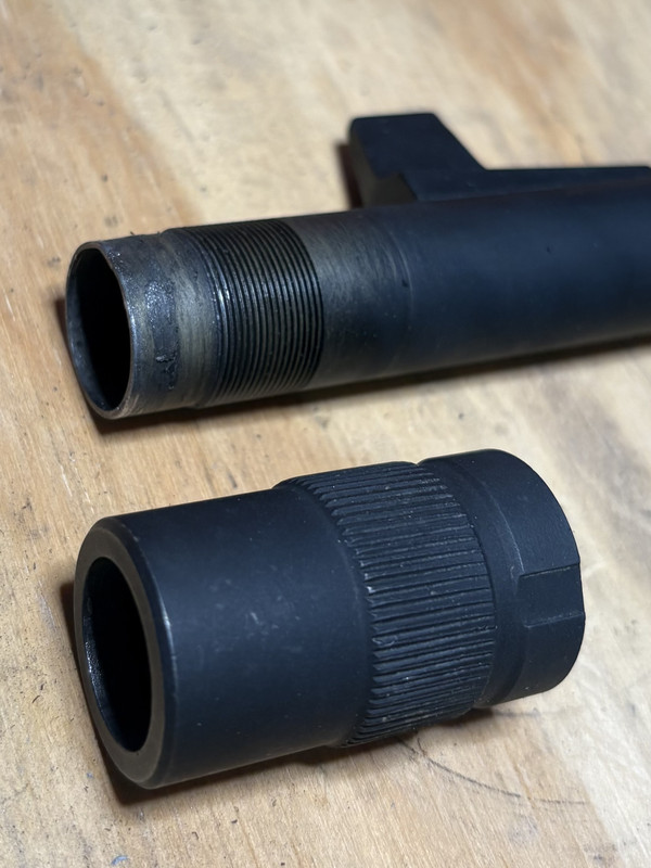

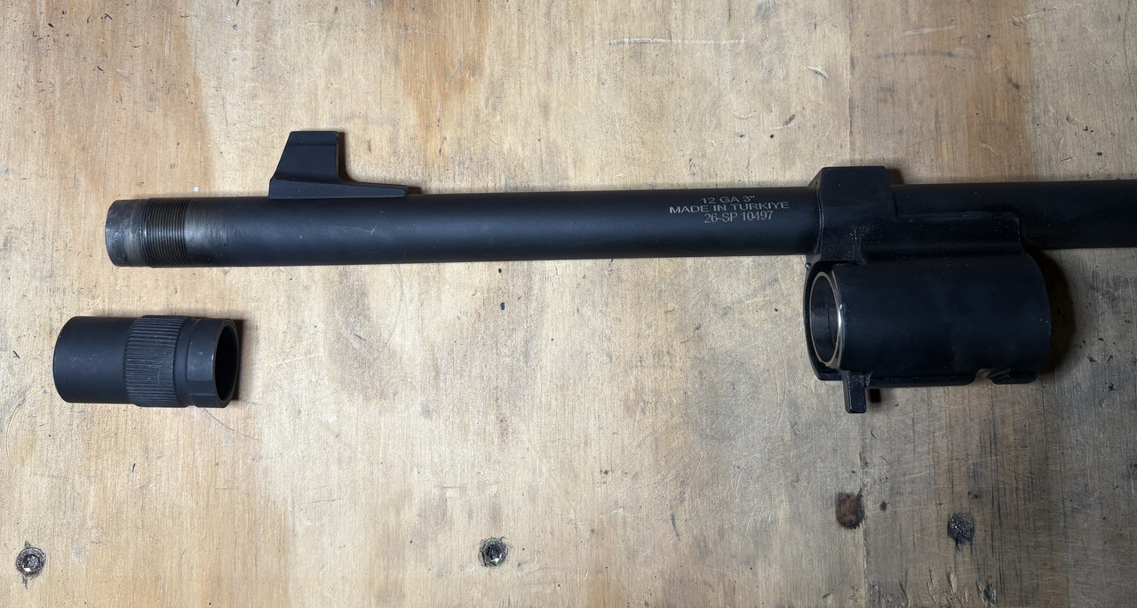

Current owners- What is the current muzzle device and thread arrangement?  I'm interested to make an SBS.  Moving the front sight back is relatively easy - BUT the muzzle will be a naked barrel!  What is the current muzzle device affixed to?  is it the barrel that is actually flanged and threaded or is it a separate flange? that is mated to the front  end?  hoping its the later so it can be moved back!
Also does it come with any chokes?

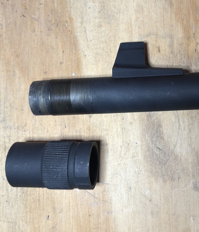

Need to use a little heat like a torch to remove the muzzle device. It's threaded onto the barrel.

So yeah had this pin come out of my hook after shooting. Put it back with some JB Weld. Gotta have this pin in there or else the hook won't work properly. Also noticed all the screws were coming loose. Loctite is a must.

Thank you - Is the muzzle device a choke or just a muzzle not that looks good?  I'd bet we could use a die and thread it for Saiga External chokes with a hand threading kit  If cut short : )
9/6/2026 8:41:35 PM EDT
[Last Edit: GunDisaster][Edited] [#35]
Not a choke, it's just a thread protector. No chokes came with the gun. I think it's just to give that SPAS look. The barrel is thinner at the muzzle before the threads.
9/7/2026 8:50:31 AM EDT
I had heard that the threads were not compatible with real SPAS muzzle devices like chokes, and now I see why. This barrel lacks the flange that real SPAS barrels have, and it also appears to lack the rubber o ring gasket as well (then again it has nothing for that gasket to compress against).

Any idea on the thread pitch?  Maybe (hopefully) it's the same as the Saiga-12 22mm x .75 thread pitch.  That way you can use the Saiga parts for it, everything from chokes to flash hiders.
9/8/2026 3:58:32 PM EDT
The Turks almost never use threads the same as anyone else.  But here is hoping!

Just cycling some rounds through it manually, I had some issues with extraction.
I ended up smoothing off the edge on the barrel where the extractor goes, that helped a ton.
Some more fiddling with it is needed, but it's pretty nifty.
Holds 8 rounds no problem.
So, cut down and thread to Saige-12 specs?
Being willing to die to complete the mission didn't mean He's a pacifist, just tougher than nails. see also J3:16
9/11/2026 9:38:52 PM EDT
That would be my plan.  I've done it on a few guns and use Saiga Style chokes and or muzzle device.  The thread kits are out there - just need to check the diameter of the barrel and turn it if its not close.
If I could find an adjustable choke, I'd use one and solder it on- not too easy to find old polychokes these days.
