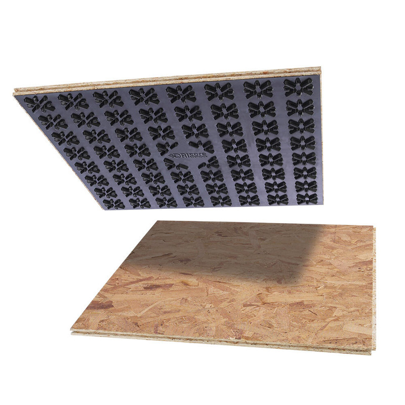

I sat mine on Dricore subflooring tiles. Water can pass right under them in the event of a water leak.
