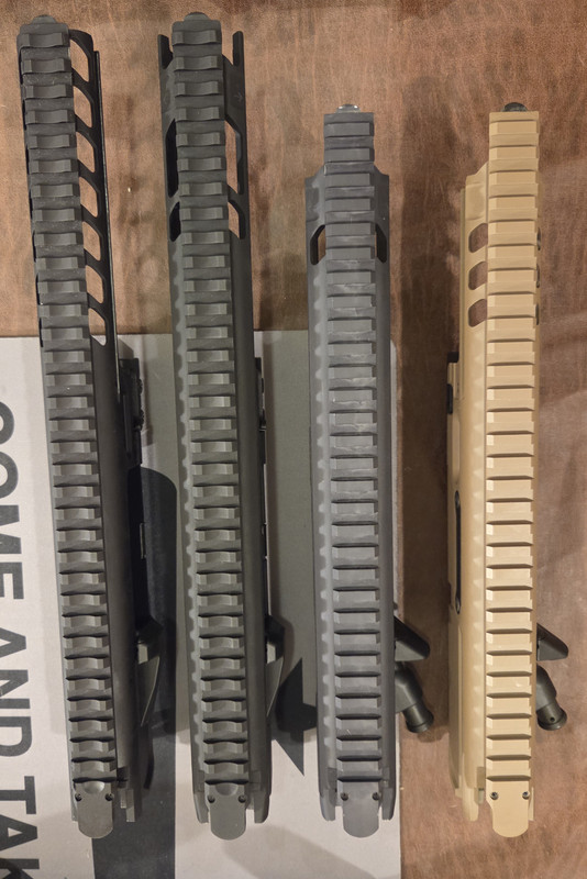

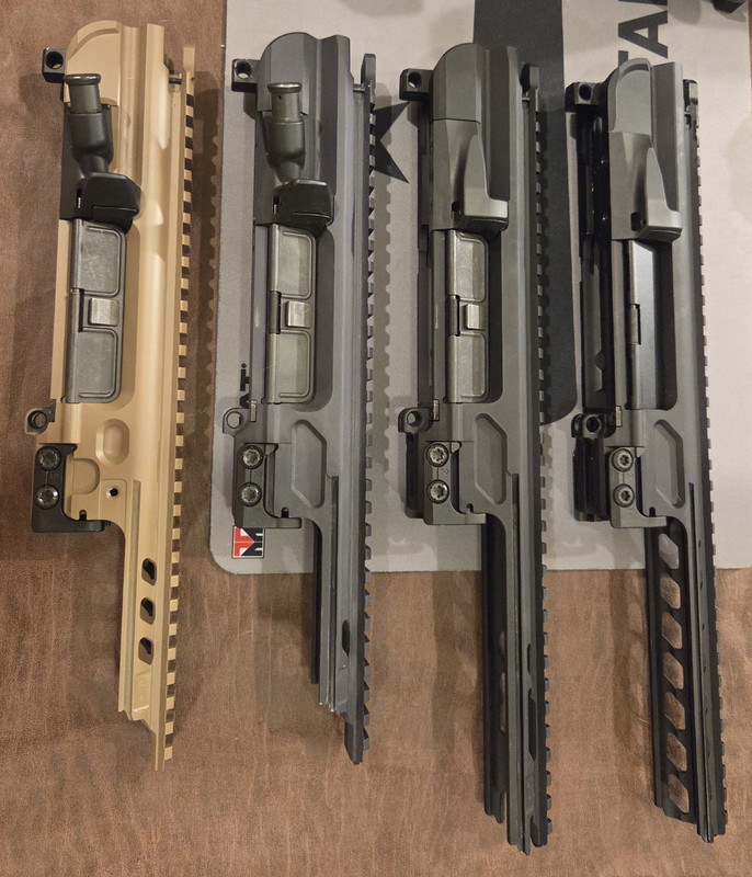

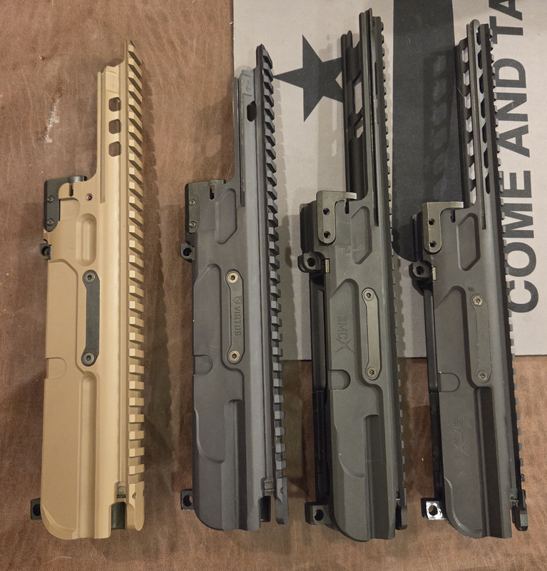

I took a few pictures of what Virtus and SPEAR-LT uppers look like on a standard AR lower. I didn't see this in your first post and SIG themselves haven't really talked about it.
The Virtus and SPEAR-LT uppers are significantly "wider" and protrude out over the sides of the lower receiver when using a standard AR. I have not run into any function issues using either upper on the AR lower, however, the forward assist housing screws are clearly visible when mounted on a standard AR lower.
MCX VIRTUS [LEFT] - S&W MP15 [RIGHT]
MCX VIRTUS UPPER on MP15 LOWER
MCX SPEAR LT UPPER on MP15 LOWER

1/16/2026 10:40:39 PM EDT
Upper Generation Comparison - Gen 1, Gen 1.5, Gen 2, Gen 3
I'll try and take better pics another time but, for now this should do.
3/9/2026 8:17:22 PM EDT
There's an additional transitional upper for the gen1 with 4 slits (plus the adjustment holes).
It's pretty rare from what I've seen looking at public photos - maybe overrun from contracts?

5/4/2026 5:29:36 PM EDT
Hmmm... I'm not sure because I've never seen that upper in person or picture. The Gen 1.5 in my pics was from a true Gen 1.5 MCX. It shipped from SIG on an M400 lower w/ MCX adapter. I sold the M400 lower and adapter and put the upper on a MCX lower. I'm sure that'll make some collectors lose their minds!
I don't have the LT or Virtus uppers anymore so I can't do any further comparisons of all the different uppers but, I still have a few Legacy uppers and the 1.5 upper. I'll get some better pics of the two side-by-side and post them here at some point.
5/7/2026 6:00:00 PM EDT
[Last Edit: cmcflex][Edited] [#49]
I have such an upper (ETA: maybe it's just a legacy, as I see a few of them on Google photos). Got it off Gunbroker several years ago from a guy parting out a MCX. Used as a LFaux base (though I have the SRD762-Ti Long Boi with a Lancer handguard and Gen 2/Virtus internals):
