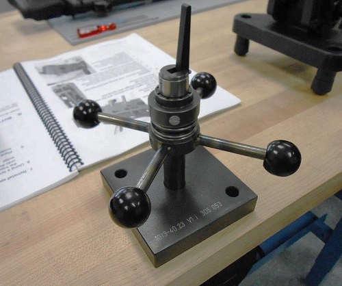

Not to hijack your thread, but along that vein, have you ever seen the contraption they use to wind the spring for the locking mechanism on A3 stocks?
And thanks for posting your progress on the project.

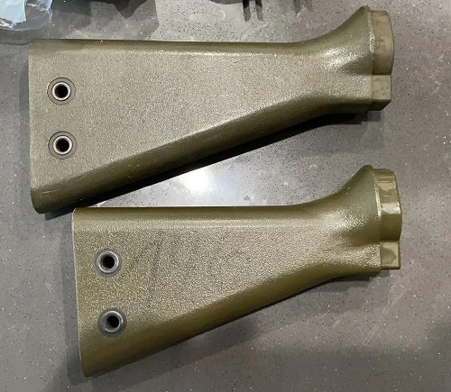

So here it is mocked up side by side for comparison.
Happy so far, now to see how it fits.

So here’s the final result.
I painted all the furniture to match. The stock had the ferrules masked up, a couple light coats of bedliner paint then semi gloss WW2 OD green.
This paint is almost an exact match for HK OD. Yeah I know Cerakote and or Duracoat is more durable this was cheaper and I didn’t have to crack out the airbrush. Come to think about it in the Army I never even saw a spray gun. In fact we painted the tank with a paint brush (good times).
