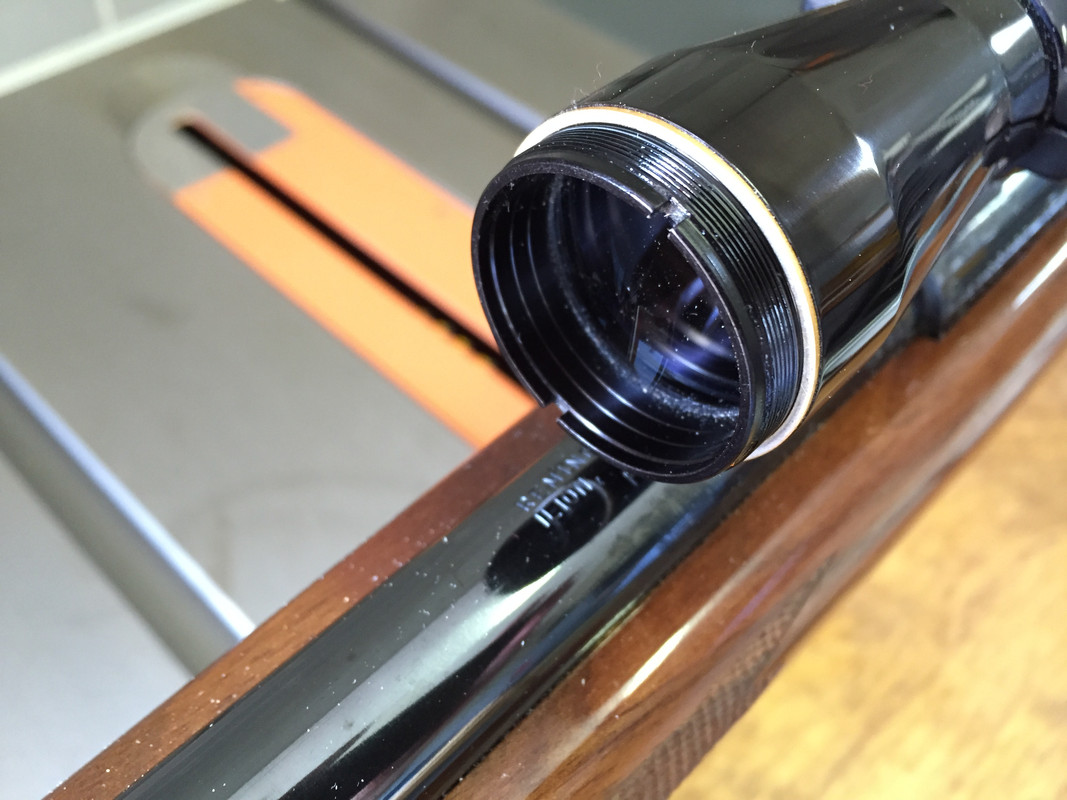

Mock me now, thank me later...
I know it's a little silly, a lot un-tacti-cool, and slightly gay (and not in a good way, like that brave woman Caitlyn Jenner)
This is an idea I came up with because I have too many rifles with too many different scope set-ups to keep track of...I know, white people problems, right?
This is not for your Tier 1 HSLD operators or your low level Fudd with a 30-06 with a bead sight. It's for guys like me. Maybe you're like me? I dunno, so here it is...
Every scope is a different height above bore, and I zero different rifles at different ranges and I can't keep track of them. I know there are apps on my phone that do that stuff but I don't want to rely on tech or anything that can crash...so this is what I came up with to give me the basics for a particular rifle. I have the rifle's scope height above center bore, and then bullet drop for various distances. That's it, keep it simple.
10 pack of luggage tags off eBay for $4.99

Some centerfire variable power scopes with fixed 100 or 150 yard parallax can be converted easily to rimfire parallax.
This older Leupold is an example.  The front outer ring can be removed.  It's just a cover.  The objective lens assembly remains sealed.  Once the cover is screwed off is revealed a slotted ring that can be screwed in or out.  This is the parallax adjustment.  You can set for rimfire by putting the scope on its highest setting and pick out an object 15-20 yards away.  Turn that ring until the object is in clear focus.  Then, move your eye laterally toward the edges of the FOV and see if the point of aim changes.  Continue adjusting until it doesn't move.  Reinstall the outer cover.  Done.
