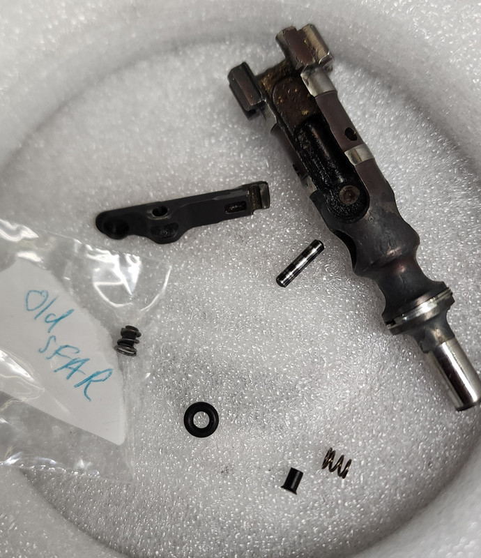

Here's what I've learned owning an SFAR. (20" 6.5 CM - no supressor)
1 - It's not smoothed or worn in, and you have to do that yourself.  It will take a magazine or two before the gas settings settle in, and a few hundred rounds to really wear the bolt/reciever smooth.  Which means their drag behavior changes.   I don't mind, as in practice all this really means is you start at a high gas setting and then throttle back - depending.
2 - the handguard and gas-block are not compatable and will strike each other when fired, wrecking accuracy.  Plan on replacing one or both, or hogging out some metal inside the handguard.  I replaced mine with a more gneeraous PSA handguard, and hogged it out some too.  The gas block actually is pretty good, but it's too fat at the top for the handguard, and will contact.  Fortunately, AR15 handguards are cheap, and it takes common AR15 handguards and their barrel nuts.
3 - While I like the factory gas block, the HB Industies replacement valve isn't a bad call.   The factory one ran everything at 2 or 3 (out of 3 settings),  the new one runs everyting at 4 and 5 (out of 5 settings).  Yours may differ.
4 - THE BIG ONE, extractor tension is too low.  Mine would fail to eject a lot, especially after a few hundred rounds.  Replacing the springs (and rubber o-ring thing) fixed that.
I just run a few hundred rounds through mine at the 1000 yard gong range witout issue.
It's a great gun, but it's also Gen 1, of a great gun.  What Ruger Gen 2 (if the do one) needs to do is
-Fix the gas-block/handguard mating issue
-Polish the reciever a bit more on the inside
-Redesign the extractor to have higher tension and be more agressive.
-(maybe) polish the chamber a bit better before maloniting it.
All of those you can address yourself.  And wear in.
To say the M1A gas system is better, isn't something I'm going to agree with.  But yes, on a gun of this nature, you're going to need to figure out what gas system works with what ammo.  RDB too.  I don't consider that damning and worthy of dumping a gun over.
If your gun is jamming - how?  Is it not fully ejecting the spent casing?  Pull out your bolt - how easy is it to move the extractor with your finger?  It shouldn't be easy - replace the spring-set on the extractor from an AR15 bolt-build kit, if so.  If you are getting feed failures, that might be undergassed, so up the gas setting.  It also could be your magazines, try different ones.  PMags tend to do pretty good for me.
At some point I might put in an H-Buffer; but I'm slow to do so.  It's remarkable how much milder and more pleaseant the recoil behavior is with the SFAR compared tomuch heavier AR10's, and I attribute a lot of that to the light BCG.  Which would imply increasing weight (Such as a heavier buffer), ,might increase jump, which I'm slow to do.  Haven't tested that, so maybe that's not right at all.  But if I were to do any more adjustments to my SFAR, that would be the next one to test, is a heavier buffer.  Right now I don't see the need.
If all this seems unacceptalbe to you - I get that.  Keep in mind, this is a latest generation Gen 1 release of a game-changer that obsoletes all other AR10's, and I paid $900 for mine brand new.  I'd be posting very differently if this were a $4000 LMT.   To me, this trade off is perfectly acceptable and I now have a great gun - that I paid very little for, and used spare parts for any and all "upgrades" that I did to it.  I love this gun, and shoot the Hell out of it.
