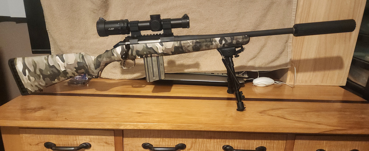

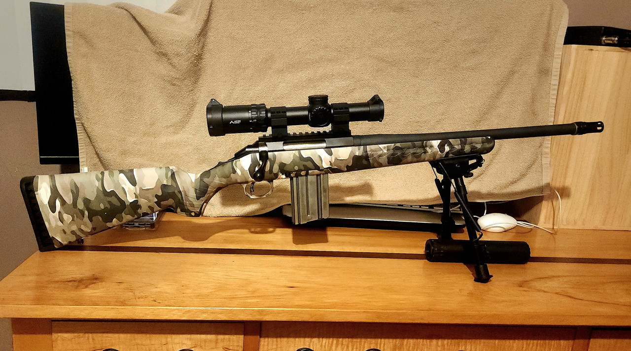

Traffic jam in front of the gun shop. Went in looking for a toy. Specifically a Ruger American RAnch in .300 Blackout.
They didnt have one but found a cammo one at a distributor. $575 out the door price. Gave him money and a week later it arrived.
Put on a  Primary Arms SLX 1-6 Nova
Wolf Pack Armory PLan B flash hider
Pen spring trigger mod
Wears a YHM R2 most of the time -  So quiet I worried I had a few squibs if it werent for the slight recoil
Yeah the original Colt mag worked fine though I dedicated LAncer 20 round transluscent smokes for it. I just think the Colt 20 looks cool in it
