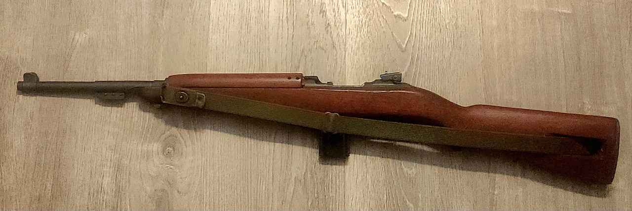

I recently came into an M1 Carbine. Its a Blue Sky import but its in very nice shape. .barrel and bore look great. Blue sky wasn't stamped with the  force of Godzilla so barrel isn't oval. I'm ok with it being a BS import. Got a decent deal on it.
I just wanted a shooter and something like what my grandpa carried in WW2.
Its got the typical refurbishments like the type 3 band and lug, adjustable rear sight and lever safety.
He was in from North Africa all the way to re occupation of Berlin. So I figure he probably changed units a few times and probably turned in and was reissued a weapon each time.
In pics I see the non bayo lug and possible the flip sights. But those are early war pics. Is it possible that he had a type 3 band and adj sights in 45?
Leaning to making it look like what he had in the pics.
Is it hard to change out barrel bands and sights?  Just want it to look closer to what he had.  I want to surprise my dad with it for Christmas.

The front sight is easy.  Easier if you have the puller.  Press out the cross pin and use the puller to pull the sight off the barrel.  The T3 band can then be removed and replaced.  Most repro T1 bands are garbage and do not work well.  A T2 works much better and repro's are abundant, usually made from cut down T3's.
Chances are when you pull the T3 off it will damage (scratch) the finish on the barrel.
The rear sight is also simple.  It presses out from one side (forgot which).  Repro flips are everywhere.  Most adjustable sights were also staked in place.
The safety is simple as well.  Just held in by a plunger.  Repro push button safeties are everywhere as well.  Heck back in high school (80's)I made a push button safety out of a bolt shank for my carbine.
What you replace the old parts with is up to you but I would base it on the serial number and maker of the rifle at least.

Late war Winnies could have come with a T3 barrel band.  IIRC 6M-ish or higher.  The easy way to tell is to find the proof P on the barrel.  If you can see it with the T3 band in place then it came with a T3.  If it had a T1 or T2 originally and the T3 was added during the rebuild of 1947 then the proof P would be hidden under the band.

Its after 6,500,000  Researching looks like it very well may have had it the sights and type 3 band..

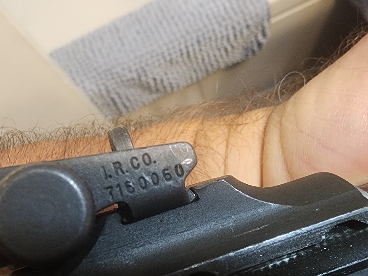

Receiver, barrel and type 3 band are all Winchester. I can see the proof (faintly) with the band on. Rotary safety may be correct but this particular safety isn't a Winchester one. Type 3 sights are made by International Register Co. Allegedly used on late Winchesters and extensively on rebuilds. Its got a Saginaw slide and Inland Hammer. Don't care though. I figured it a mostly rebuild being a Blue Sky import.
I am not going to change a single thing if this one could represent what he may have carried near the end of the war and into the Berlin occupation. All I remember him saying he carried a Winchester so this being a Winchester is a lucky win.

The safety would still not be correct as all WWII carbines had the push button safety.  All carbines late in the war got the adjustable sight but only Inland and Winchester got the T3 barrel band IIRC.

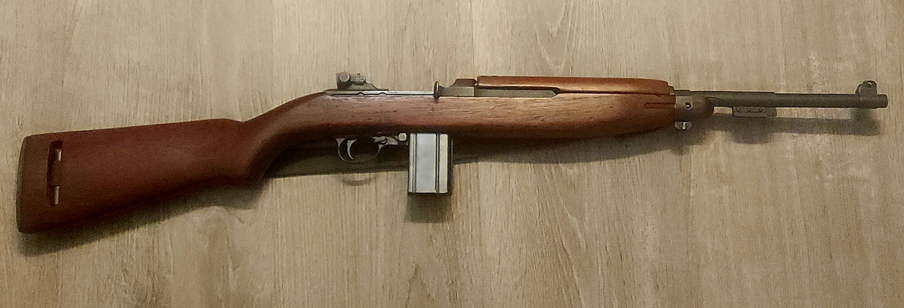

Also has a flat bolt, was thinking about grabbing a Winchester round one but I will need to find a way to headspace it. Is that doable?

Round bolts were conserved for M2 use well into the 1950s.

Appreciated. I made the mistake using ai to look up stamps and serials. Info seems to be all over the place. Claude an Gpt kept saying the round bolts started around 43 and 44 and being later serial the bolt could have been round from the factory. If this model came with the type 3 band. But like I said, the info I get seems to conflict with what people are saying.
If the bolt is supposed to be flat I'll leave it.
Its definitely a Hienz 57 though. Just trying to make it appear correct for its serial range.

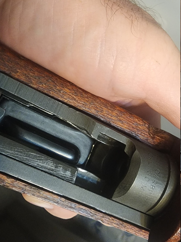

9/12/2026 12:57:55 PM EDT

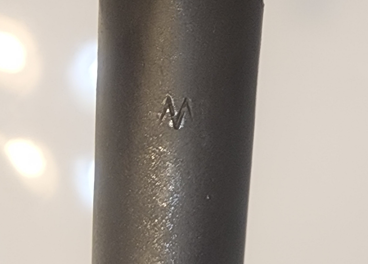

This on the barrel near the top.

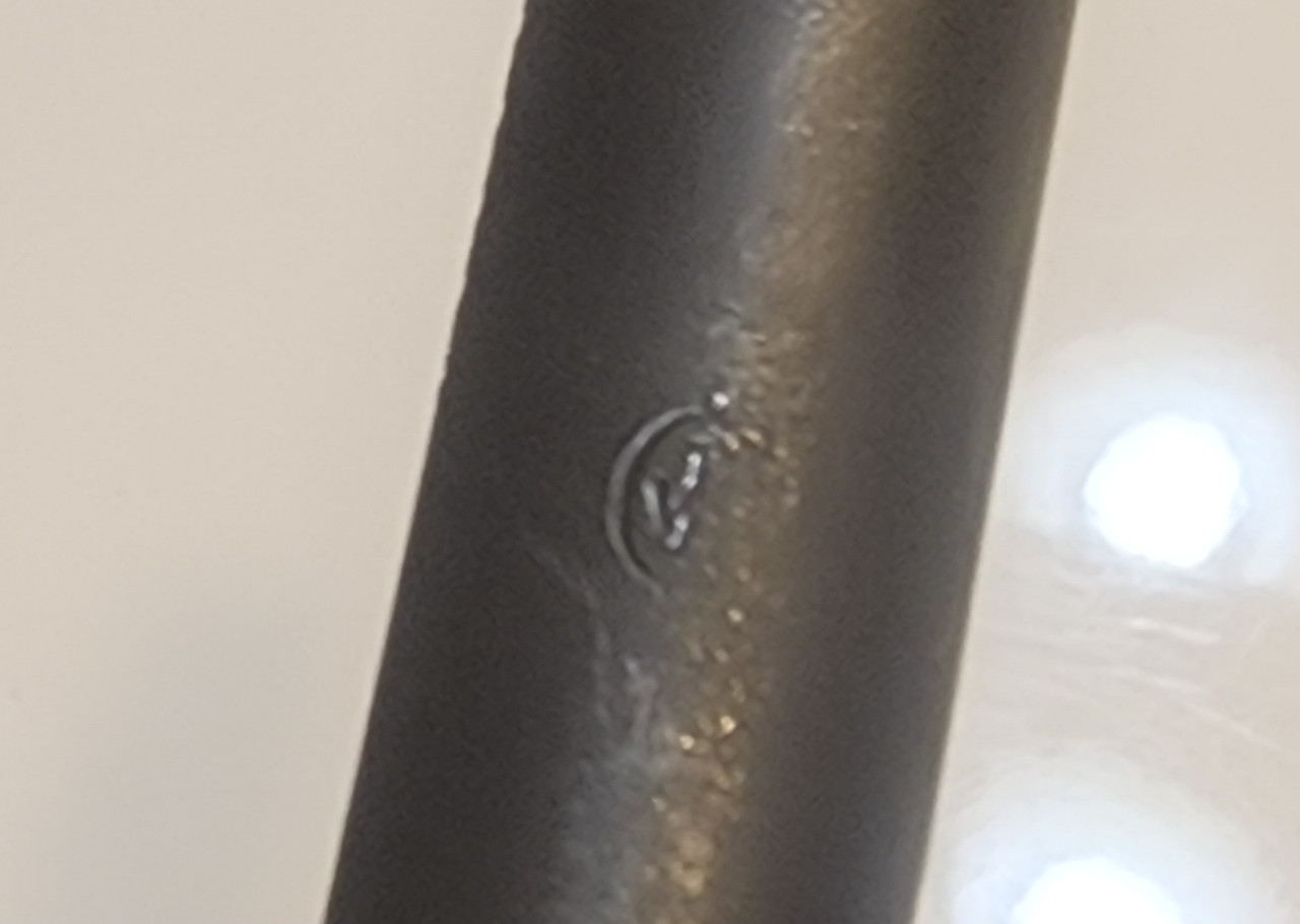

And just above the bayonet lug
I take it the W is Winchester.
The other marking is hard to make out though. Its between the W and the end of the Type 3 band

I appreciate the info. Any guesses as to which late a Winchester would have come with? Either or was the round bolt only developed for the M2.  Was the M2 in production in 44 and 45? Or are the dates Im getting pretty innacurate
If a flat bolt is what it came with ill leave it be

Yes, M2s were being built in 1945 using round bolts.  I have a “hand strike” Inland M1 from 1-45ish. Inland flat bolt.  I would “suspect” they tried to save the limited round bolts for the factory M2s until the supply of round ones allowed any carbine to get a round bolt during rebuild if warranted. Not sure that I’ve ever seen that the round bolt was actually any stronger than a flat one.
