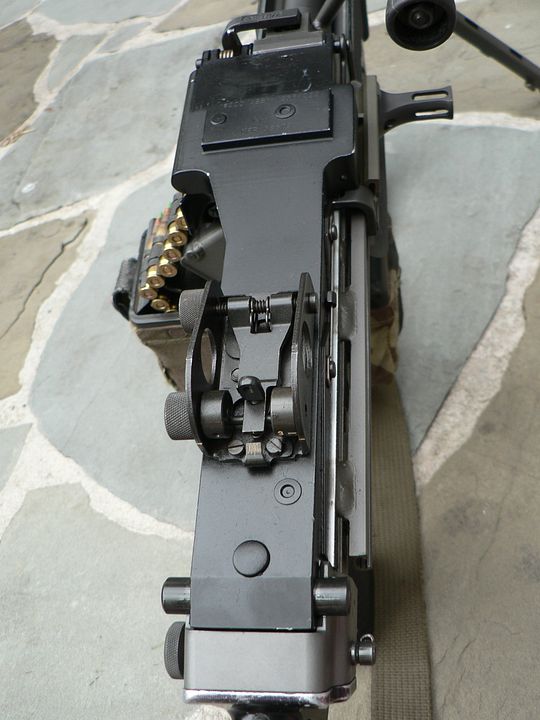

Let's take a brief look at the retro parts, shall we?  We'll start with the top cover:
Compared to a modern one, the rear sight is the same, but it's more forward on the cover because the only optic they originally envisioned was a night vision one and the only way to do that was to attach a proprietary bracket that would allow the use of an AN/PVS4 night vision optic.  In 1991, they redesigned the top cover to include a picatinny rail so that you could mount a daytime optic.  Although various units have been used over time, the original optic installed was the 4x ELCAN M145 shown below:

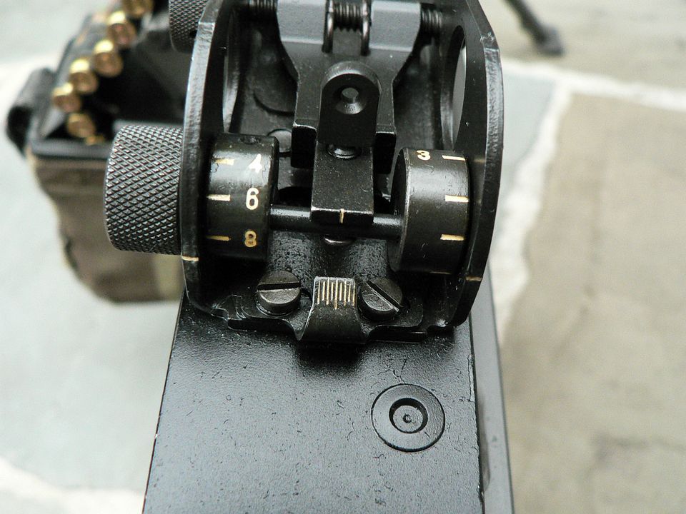

A picture showing how well the paint for the elevation and windage on the rear sight has held up over the years:

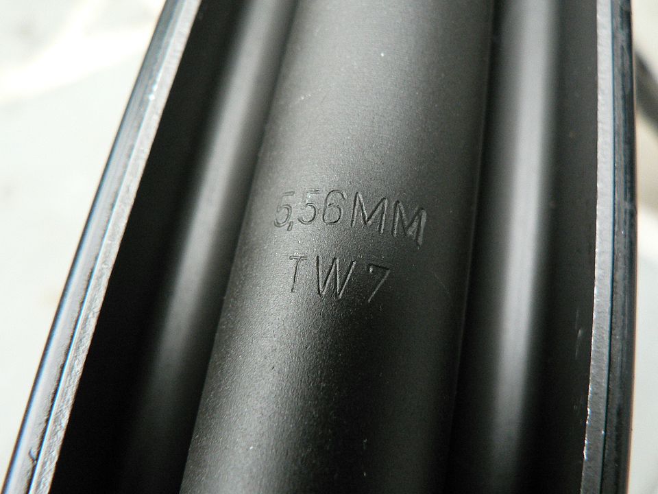

Early barrels had no provision for an upper handguard and the carrying handle was fixed.  Later handles would fold so as not to stand up so high so as to catch on things while transporting:
This particular barrel was NOS and has absolutely pristine rifling.  It's also made in Belgium and has the proofs to prove it:
"TW7" means it's a 1 in 7 twist rate:

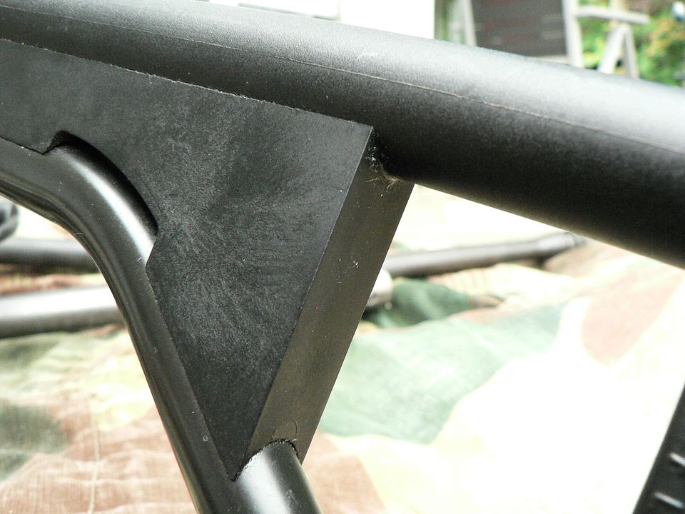

And now, let's take a quick look at the early stock:
The majority of this part is an aluminum alloy so it's fairly light weight.  The shoulder rest is spring steel and the webbing between the upper and lower stock tubes is plastic.  When the stock is being assembled, the upper aluminum stock tube passes through a plastic sleeve molded as part of the webbing so that you don't burn your cheek in hot weather or freeze it to the stock in cold weather.  The lower stock tube is just exposed anodized aluminum.
Early stocks had no buffer built into them.  The buffer was placed on the recoil rod assembly in the form of a bright yellow painted spring:
Part of the 1991 Product Improvement Program (PIP) was integrating the buffer system into the stock and making it hydraulic instead of a spring.  Here are the early and later stock/recoil rod assemblies compared (early stock shown is missing the plastic webbing):
This means that you cannot change out stocks without also changing out the recoil spring rod.  I've heard it said that you can't use the early system on the M249S but, when I install my early parts, the rifle cocks and dry fires just fine.  I have not live fired it though so I cannot say with 100% certainty that it'll work but I don't see any reason why it wouldn't.
Here, we see the newer stock at the top with its built in hydraulic buffer and the early stock at bottom with no buffer:
