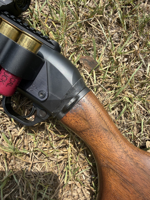

I had my Tac 13 adapter professionally scanned and had some printed using Nylon 12. A good durable nylon.
The fit is excellent, the texture is not far from the original and matched the Magpul 870 SGA stock quite well. The test gun stock.
I added a 10-24 set screw to the bottom tab to adjust out the small amount of play (in the original as well) and to hold the SGA stock higher in position.
I've run 900 rounds thru the V3 with this adapter installed for testing. Almost all trap rounds at 1 1/8 oz loads, 1200 FPS.
This adapter is locked in place quite well and has no side or top loading to do its job.
Check out the part pics and installed pics using the Magpul SGA 870 stock. Paintable as well so pick your pleasure.

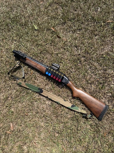

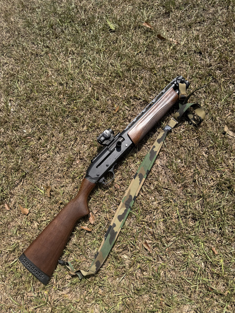

This V3 is set up with a Magpul SGA stock, my nylon 12 printed stock adapter, a 21" smooth bore Hi Viz barrel with chokes. As it comes from Remington.
This barrel is new, un fired, lots of oil. I wanted to show what it comes with.
The Hi Viz front sight, a white lined V rear sight machined into the rib, first post, chokes, and the same non venting gas plugs found on the V3 Tac 13.
This gun will end up being shortened. I don't want to cut this barrel as they are really hard to find, so I will use a 28" camo barrel I have, remove the camo of course. Or maybe not!!!
Overall shot of the V3 Field Sport as it is today.
The gas plugs.
Front and rear sights

This part actually was for sale, but no one in the US had one.
I found a dealer in Canada who had some but they wouldn’t sell or ship it to me - luckily I have friends in Canada.
My TAC-13 came with an adapter that had a mil-spec AR receiver extension screwed into it and a pistol brace attached.
I wanted to put a birdshead grip on it so I needed this adapter.
