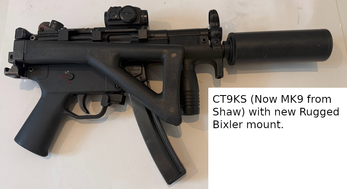

Since their website states it's hub mount compatible, I was under the impression that was correct.  I believe it arrived with a 1/2 x 28 adapter in a detachable hub mount.  Perhaps I am wrong.  I am fairly ignorant regarding suppressor mounts, so it's possible I am completely mistaking my terminology here.
I took the endcap off of it just now and took the 1/2 x 28 adapter out of it. My hub mount from my Griffin Bushwacker 36 screwed into the Shaw endcap just perfectly.
I have attached pictures of my MK9 purchased last year, with the Bixler mount, as well as the one I picked up a few days ago.
Ultimately, I want them both to have the Bixler style mounts for my MP5 clones, as well as possibly my 9mm AR.  I would also like to have hub mount caps for them, in case I want to try them on different guns.

Sorry, when I see MK9, I think of the original AWC MK9.  Sucks Shaw decided to re-use the MK9 name.  So yeah, the current runs are hub threaded.  I got an email back from them on Friday that they are going into production of Bixler mounts in September.  They will also be introducing a new compact Bixler variant and still sell the original style.  I like the original style better.  Depending on the can, it is noticeably quieter when the muzzle is placed further away from the blast baffle and with the OG design and small OD of the nut will fit under any AR rail in existence.  Which obviously may not be a thing if not mounting to an AR.

Got an email from Joe, he says a run of them is scheduled for Sept (as amphibian said above).  Got another email from Shaw, stating the Rugged unit will work.  I think I saw Amphibian test that one, though, and find it was significantly louder.
It's close enough I'll wait for Shaw to make their run, then buy a few.

I doubt your ear can tell the difference between mounts used. The rugged 3 lug mount is excellent quality and locks up very tightly.

I'm old and half deaf and I can absolutely tell the difference in the sound between the two configurations below:
Below is considerably quieter.
Again, this is suppressor specific.  Something like the Sub9 is designed to be used with their mount and probably sounds great.  In this example the muzzle is too close to the blast baffle and noticeably louder with the the RU3 mount.
