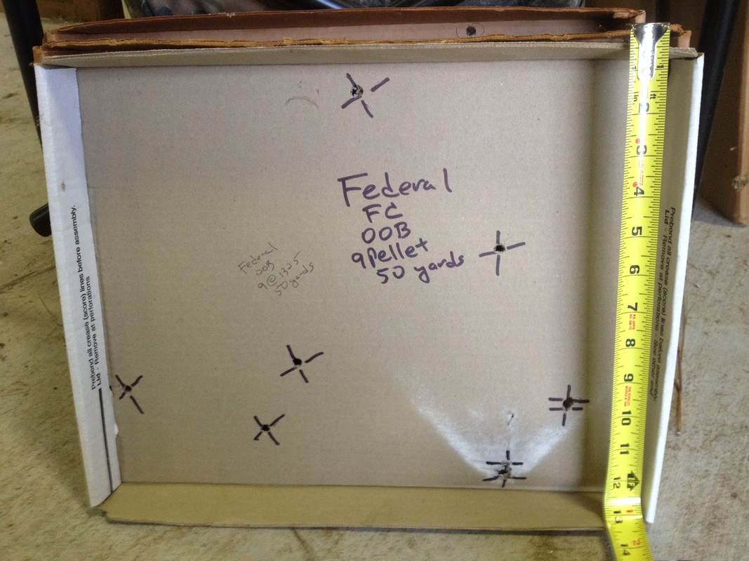

I had not had my M1 Super 90 out since I got an M4 a couple years ago. It’s a 20” cylinder bore with GRS. It was my deer gun with slugs for about 25-years.
Had some time to kill so decided to pattern it at 10-yard increments out to 50-yards. YMMV.

My 1301 with fixed cylinder bore choke will keep all 9 pellets inside 9" at 25 yards. I have yet to pattern my 870s.
8 pellet is supposed to pattern tighter and I have a case of it but haven't patterned it yet.

Federal Flite Control 9 pellet full power at 50 yards from Remington 1100 22" IC.
