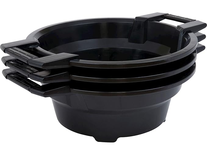

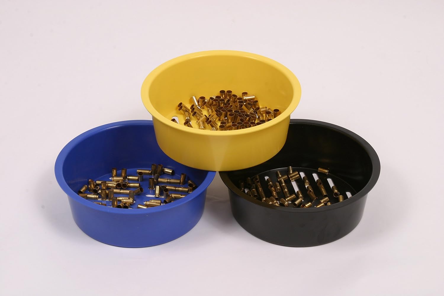

Enter the set from Shell SorterTM:
I ordered from Amazon, paying just over $50 shipped for the set of three.
They work very simple, the .45 (yellow) is on top, .40 (blue) is in the middle, and 9mm (black) is on the bottom.   The slots are cut to contain the calibers mentioned and the smaller cases fall through.

AJE - great review. As someone who uses them 3 or 4 times a week, I will add a few details.
The 38/357 do hang all the way through the 40 tray - only hanging by their rim. 10mm also stays in the 40 tray. As does 32 and 38 Winchester shorts - what a pain.
32 and 25 shells drop out of the 9mm tray. Sometimes the 30 cal also fall through.
Rifle rounds will quickly plug up the 45 tray. I pick them out first and then get to the pistol brass. The 223/556/300 black out also falls all the way down to the 9mm tray.
38 super is a pain to pick out of the 9mm tray.

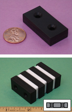

Yes they do. One other tip is to get a good magnet, and you can separate any steel cases while they are in the sorter as well. Something like this.
http://www.amazon.com/gp/aw/d/B009RLGDPE/ref=mp_s_a_1_2?qid=1433518793&sr=8-2&pi=AC_SY200_QL40&keywords=frankford+arsenal+magnet&dpPl=1&dpID=41dQeM4Cu9L&ref=plSrch
I already have one of those for the stainless pins in my wet tumbler.
Duct tape one of these to a broom handle, 26 pounds!
26 Pound Magnet

I started to get some of the brass through my tumbler today.
As I said in the "what you did today" thread, the belt on my small HF tumbler broke again.
Instead of swapping that out, I went ahead and upgraded by ordering the Frankford Arsenal unit for $165.
I expect to post a follow up next week with all the brass in the OP cleaned up

6/8/2015 11:18:46 PM EDT
I had 15 buckets of brass to sort.  I bought the colored sorters plus the .380 insert from Midway.  I Think Midway made them.   I wanted to use the trays sequentially all at the same time.  They nest.  However, they nest too tightly with not enough clearance between each tray.   So, I glued three wooden blocks to the outside of the two larger trays.  This holds the trays apart so that there is room for the cases to rattle around and go through the grid.  I stack the trays with the largest one on top.  Put three or four double hand fulls of mixed brass into the top and start shaking over a 5 gal bucket.  After shaking pull out the large rifle brass, large pistol and the 45 from the top tray.  Remove it and shake some more, pull out the .40, 10mm, 357 sig 38 and 357 from the middle tray.  Then check the bottom tray and make sure everything that is small has fallen into the bucket.  Dump the .223, 9mm and 380.  When all done clean the .32, 25. 5.7 and other reloadable brass out of the bottom of the bucket, recycling the .22 and dumping the dirt.  After pulling the .223, sort the 9mm from the .380 with the metal plate.  The wooden blocks allow processing a lot more brass per batch and get things moving down through the slots all at once better.  A very dirty job even though I wash brass when I bring it home from the range.  Lots of dust and dirt.  Probably not good to breath the dust.
6/8/2015 11:23:25 PM EDT

The hardest sorting problem is 9mm from .380.  If you don't have the metal plate that is an accessory to the colored baskets, you can try a technique that my son taught me when he was sorting and tumbling for a penny a case for a guy who was trying to make a living with fired brass from various ranges.  Put your mixed brass in a bucket.  Obtain a .45 acp sized plastic cartridge tray with square openings, size 5 wide by 10 long.   Dip the tray into the bucket and most of the openings will fill with cases.  The 17mm length 380 cases will easily show up as shorter than the 19mm 9mm Luger and can be removed into a 380 bucket.  Then most of the cases, which will be 9mm L. are dumped into a 9mm bucket.  The 2mm difference in length is hard to spot case by case, but the difference is easy to see in a group.  If you find any 9x18 Ultra cases, (rare) send them to me.
Great idea.
I found the same problem.   I solved it with the yellow basket by setting it crookedly on top of the others while pouring brass in from the bucket, but I couldn't do much to stop the bottom two from nesting together.

This is an old thread, so maybe it's time for a new review.
Weekend before last I bought about 100 pounds of brass.  Started depriming the .45 ACP cases one of the boxes, and I was not making a big dent.
So I bought a set of sorting trays on Saturday, and had all of the brass plus a couple of buckets already on hand sorted early on Sunday morning.  $20 for the brass, $40 for the sifters!
The trays work best for separating .45 ACP, and most of the telescoped brass has to be separated by hand before the trays can do their job.  The .40 caliber tray is not quite as efficient, that might have been due to the monstrous portion of .40 S&W brass in the mix, but it also holds onto the 9mm cases a little tighter.
One thing is certain, the trays should not be overloaded, they work much better with smaller batches, it's much tougher to get the smaller brass to migrate to the bottom if the pile is deep.
