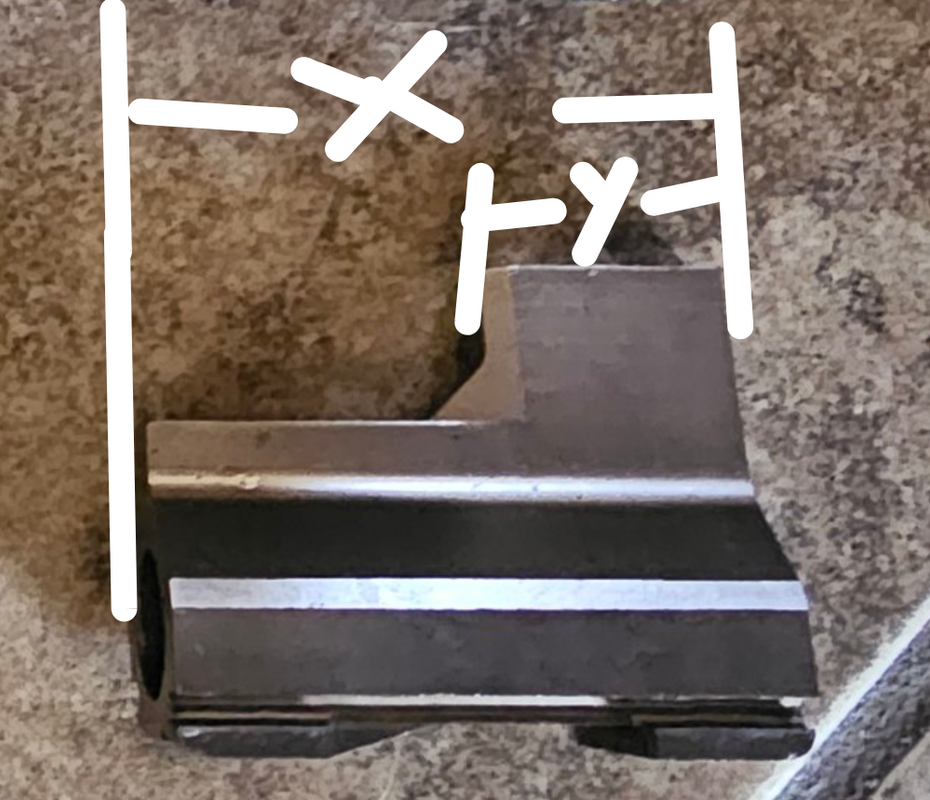

Originally Posted By HaveBlue83: I need x and y mearured with calipers or a mic. Thats first. https://i.postimg.cc/x1nWzyQV/Screenshot-20241209-150826.png Then id need a slide hammer, new or old, to R&D a print to make the OG style one. Then i could test on my buddies if im allowed. The second thing is whats the inside of the back of the FPin look like, cause this new slide hammer is flat faced it seems. So if i dont need to undercut the bevel on the front and i can keep more meat there, i would. Just round the edges. More mass. I plan to go back and look at his again and try to get a print of it but its nicer to have one in hand. sending a PM with my number, i can mike the post recall hammer. I have calipers and a SAW at my desk. |
| I will fish out my M249S and pull it apart to get any dimensions you want with calipers if you're serious about doing this. It's in the very back of one of my safes, so it takes some work to get to it. In fact you can PM me your number; it might be easier to just do a Zoom or google video chat to get all the info you want on the internals in real-time. |

Contact made with HaveBlue83 and the preliminary info he asked for has been provided. Also, while I had my pre-recall "Gen 1" M249S out for measuring some of the parts for him with calipers, I used my trigger pull gauge to check the pull weight out of curiosity. It's consistently a 7.0lb trigger pull, FYI. |

Originally Posted By HaveBlue83: Yep! I need to get the rest of the dimension on the old one but i think the rear chop mod to clear the buffer/ hard charging issue is the main thing, and the sear vs pushing the slide hammer back is the trigger issue...that im thinking over I feel like once the rear of the slide hammer is cut down the trigger won't be nearly as much of an issue, since it won't be pressing against the hydraulic buffer. the trigger spring feels like even less of an issue in comparison, it runs pretty light when it's separated from the gun. The sear forces a pretty small amount of rearward travel, even taking off a tiny amount of material should make a big difference |
Just popped the top cover on a 249s pre recall, yeah that slide hammer is tiny! Yeah i need to just machine off the back area so it clears, call it a day and see how that works. Someone send me one and ill do it for free, make it look factory and blue it up lol. Someones gotta be the guinea pig, and i dont have a 249 (yet), bit a buddy has one for reference |
