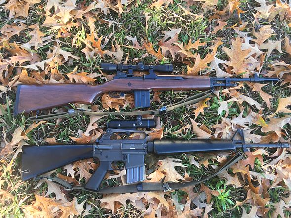

I have an early 180 series Mini 14 as well as a slightly later 184 series Mini 14 and a 187 series Mini 14 Ranch Rifle.
The 180 series was 2 MOA in factory form, in part because it has a lighter slide and bolt as well as an .052” gas port bushing.  With less reciprocating mass abs not being massively over gassed it has much less vibration, better barrel harmonics and much better accuracy.
Ruger then designed the select fire AC-556 for military use and IIRC a single foreign military contract.   They used a much heavier slide, a heavier bolt, and larger, heavier, deeper gas block as well as a deeper stock to hold it all.  They also used a .080” gas port bushing so all that extra weight also has excessive slide velocity.  I suspect it was for greater reliability when dirty.
Unfortunately, they decided to use the same AC-556 parts on the 181 and later series Mini 14s.  All that extra slide weight and velocity equates to poor accuracy in the 3-5 MOA range.  They also played musical rifling twists starting with a perfectly reasonable 1:10 twist, before moving to the poor choice for 55 gr and 62 gr FMJ 1:7 twist, before going to a more utilitarian 1:9” twist.   Consequently accuracy with budget 55gr FMJ range ammo can be really bad with the 1:7” twist examples.
I bought the 184 series after someone had cut it down to 16”, probably seeking better accuracy.  It shot 5 MOA 5 shot groups at 100 yards.
I improved the accuracy by:
- installing a Choate combination flash hider and front sight as both the Browning and A1 style have long been known to add enough muzzle weight to improve barrel harmonics.
- adding a SOCOM sized Accustrut, and installing it using an end mill to create divots for the set screws to make it a little more solid installation.
- installing a .045” gas port bushing to reduce the amount of gas and slide velocity.
- torquing the gas block screws to a consistent 20 inch pounds.
- installing a Mini 14 Shok buffer.
- installing a tech sights rear sight.  I also thinned the front sight to give the same sight picture as my M1A Supermatch.
The end result was consistent 1.5 MOA 5 shot groups at 100 yards with Hornady 55 gr FMJBT bullets.
I did the same thing with my NC state surplus 187 series Mini 14 Ranch Rifle and got identical accuracy, I also added a new stock, but that by itself didn’t improve accuracy, even though it was a snugger fit.
I used to bed M1As and M1Garands for other service rifle shooters as part of overall accurizing and I could probably adapt the process for the Mini 14 ( although figuring out how much down pressure to put on the barrel via gas block would be trial and error).  And frankly I am not seeing enough dispersion to make it worth while.  Both of my accurized Mini 14s shoot as well as my Colt SP1.
The 184 series now lives in a Sampson stock.
Replacing the gas port bushing is a 15-20 minute job if you go slow and don’t know what you are doing.
Just be sure to get the gaps between each side even using regular auto store or harbor freight feeler gauges and torque the screws to 20” pounds.
If your gunsmith thinks that’s difficult, he just doesn’t know what he is talking about.
