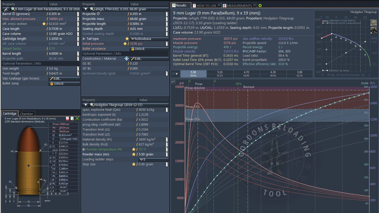

7/30/2026 11:51:54 PM EDT
[Last Edit: Trollslayer][Edited] [#5]
Where did you get those pressure specs from?
Lehigh says 5.1 gr (1420 fps) to 5.5 gr (1525 fps) of Titegroup.  <-- 4" barreled 9mm Luger.
How long is the barrel?
What is your OAL?  Lehigh says 1.105"
Here are some GRT results but there are several guesses in this run.  Note, GRT predicts 1525 fps from a 4" barrel, just like the Lehigh data.
