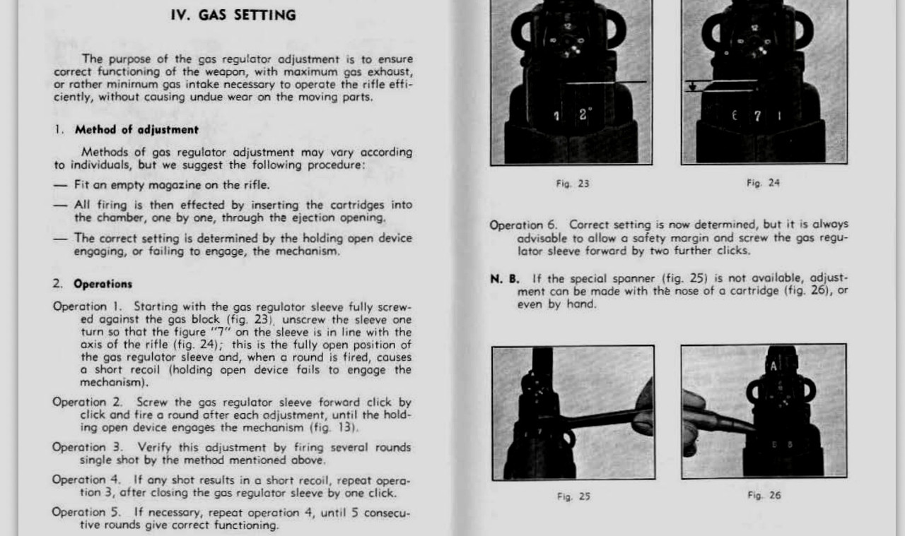

Also, what is the preferred method for getting the gas system adjusted properly?
https://www.ar15.com/media/mediaFiles/509384/4535-3775853.jpg
On my DSA Lightweight Tactical SA58, I start by dialing the gas aperture wide open (largest opening dial position) then fire a round, close one click, fire a round, close one click, until it starts cycling 100% of the time with a given ammo, then I go one click past that.  You can close the gas aperture further if needed, for dirty conditions, just bear in mind it will give you more recoil and wear things faster.  I would not close it all the way unless I was in a sand pit in the boogaloo.

This...   But a slight variation.  I forgot where I read it years ago.  Open the gas aperture.  Put one round in a magazine, let the bolt chamber the round, then fire the chambered round.  If the bolt doesn't hold open, dial the gas aperture down more.  Continue repeating until the bolt holds open after firing the round.  Then close the gas aperture 2 additional clicks.

That is my recollection as well.  2 clicks more closed than the lock back point.  Unless your life is on the line probably setting it just enough to lock back is fine.

I also use the "load one round in the magazine" method, when bolt locks back then close the regulator a couple more clicks.
Also look at the ejection pattern. If your brass is going into the next zip code with two extra clicks then maybe back it off one click.
Check rims of fired cases too. Generally two extra clicks is the sweet spot.

There is a specialized wrench for the gas collar, which engages into the collar slots.  It's convenient to have, but not necessary.  Can also use a bullet point or a brass punch.  Other times the collar can be adjusted by hand if not carboned up too badly.

The gas regulator can also be adjusted with a bottle opener like the kind is found on a Swiss Army knife.

Alright, I was able to use a dowel to rotate the gas collar. When I get it to the range I'll single load magazines and adjust the collar until the bolt locks back, then turn the collar another two clicks.

Then run several fully loaded 20 round mags through it to make sure your settings are good.

If just shooting for fun or target, don't turn the gas reg in more after the bolt locks open on an empty mag. Felt recoil is softer and less wear on the internals. 2 clicks more closed after lock open is the combat setting. I run all of my FALs just on reliable lock open and no more. My teen daughters enjoyed shooting the FALs this way. Smooth and light recoil.
