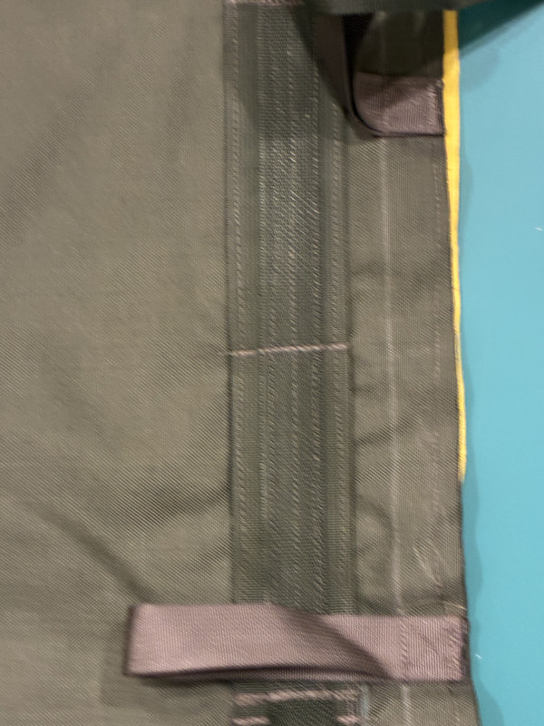

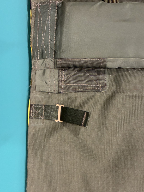

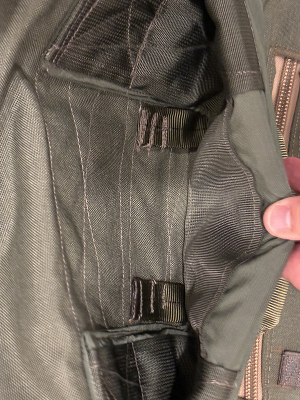

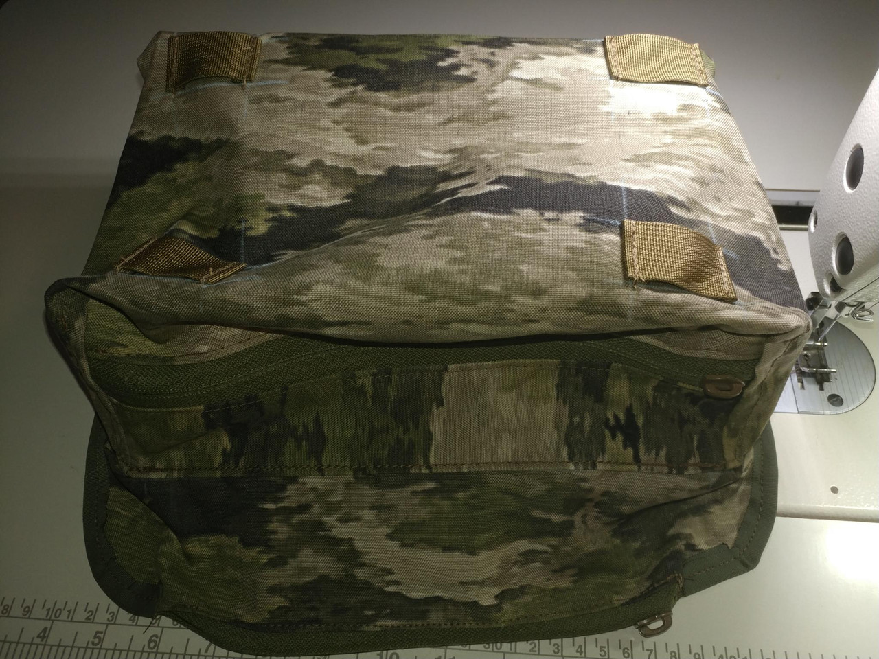

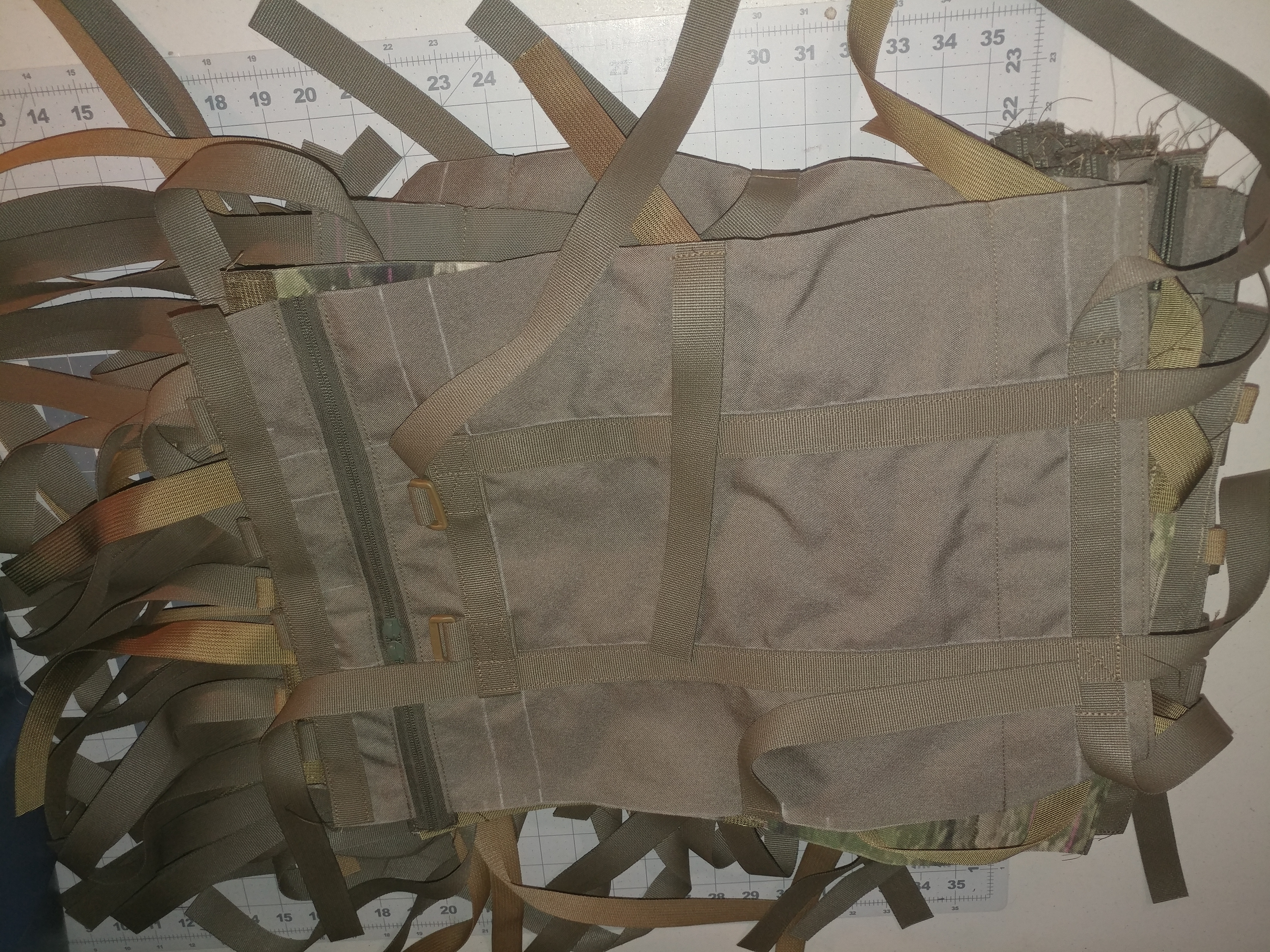

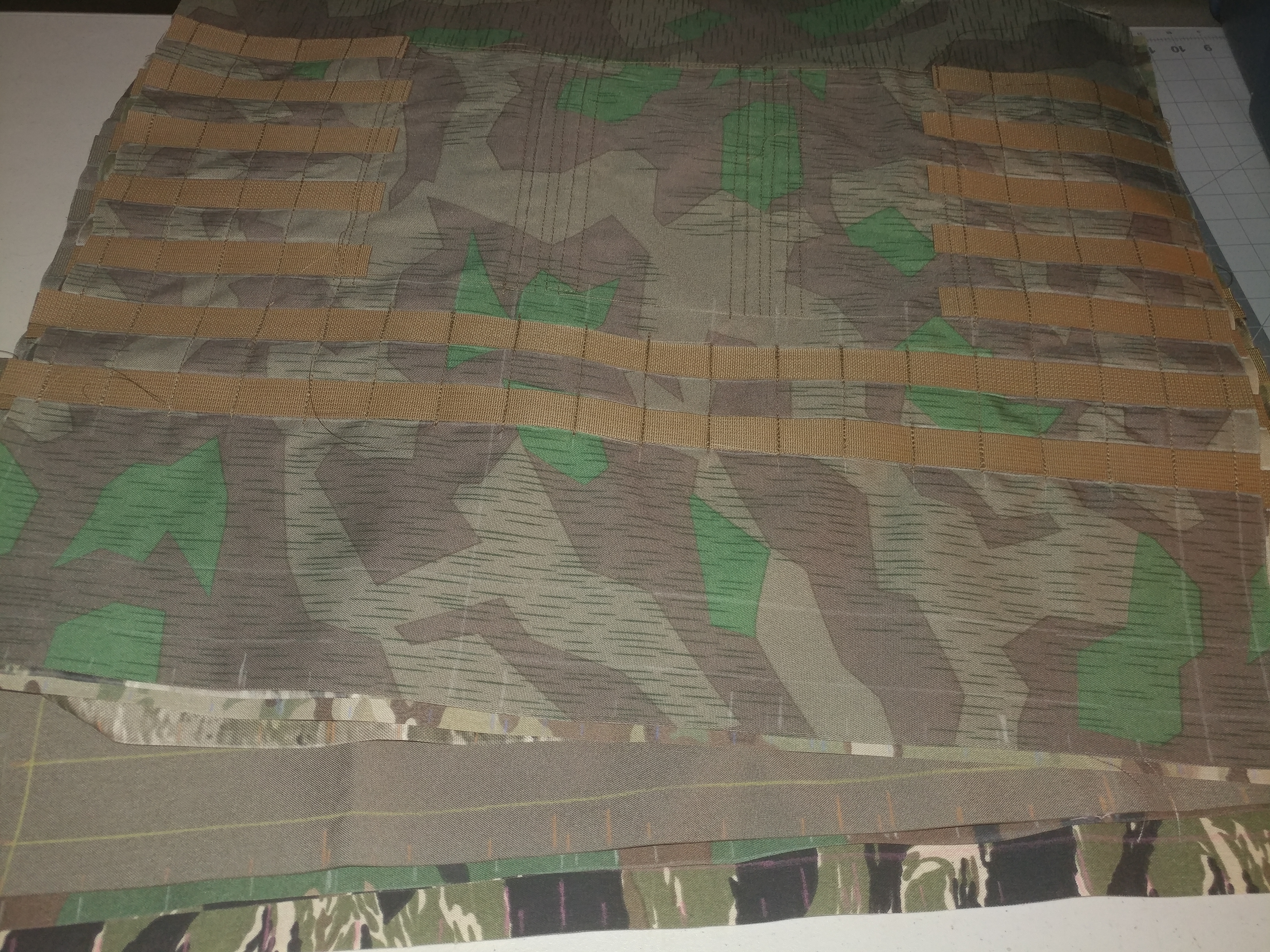

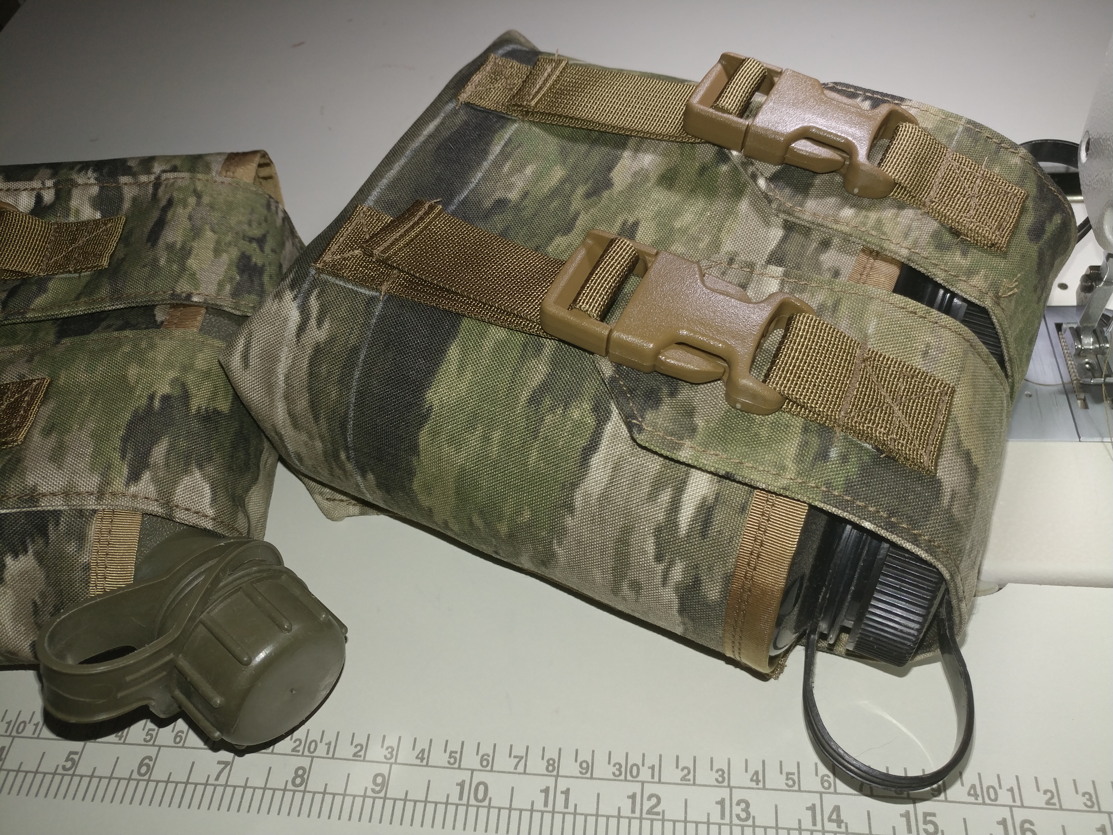

Quick update on the packs.
Pictures of the main pack front panels - still need to sew the pockets on, along with the bottom corner attachments.  (That splinter pack is going to be sick looking btw.  I'm super tempted to make one for myself)
I even went to the trouble of doing the inside webbing reinforcement like the originals.
Pictures of the back panels.  I need to sew on the radio pockets and the frame pouches on.  I cut those last night.
Also pictures of the pouches I made to go on my two packs.  They will go on the bottom sides instead of the bottom 3 rows of molle.  They are slightly upsized SAW pouches - they hold 2 quart canteens or 2 x nalgene bottles.  Or mags I guess.  I'm doing the rest of the molle as molle.  I think these side pockets are a good base add-on.
https://i.ibb.co/fzYd4v8X/1201251856.jpg
https://i.ibb.co/JjByQtrW/1122252321.jpg
https://i.ibb.co/vChtrDX1/1201251858.jpg
https://i.ibb.co/MDY3Vbvw/1130252324.jpg

Yea, I designed them to take molle on the back.  4 columns.  I've got the patterns all done.  If anyone wants a pair with their packs, let me know, and I'll make them after all the packs are done.  Message me and we can work out details.
And yea, I like them because they are multi-purpose.  Water, mags, belts of ammo, shelf for something like you said, GP pouch, etc.
If you don't care about matching camo or the ability to fit nalgene bottles, these are basically stripped down USAF saw pouches.  Just slightly upsized to fit 2 x nalgene bottles.  The surplus ones don't fit the nalgene bottles but WILL fit the 2 quart USGI canteens.  They only come in USAF digital 'tiger stripe'.  I wanted them to fit nalgene bottles (my main water carriage type) so I just made some bigger ones.  Plus they'd match the camo on the packs.  Looking drippy is half the battle, right?    (the funny thing is that if you know me, I'm totally into the 'mix and match camo' thing and don't really care about matching everything)

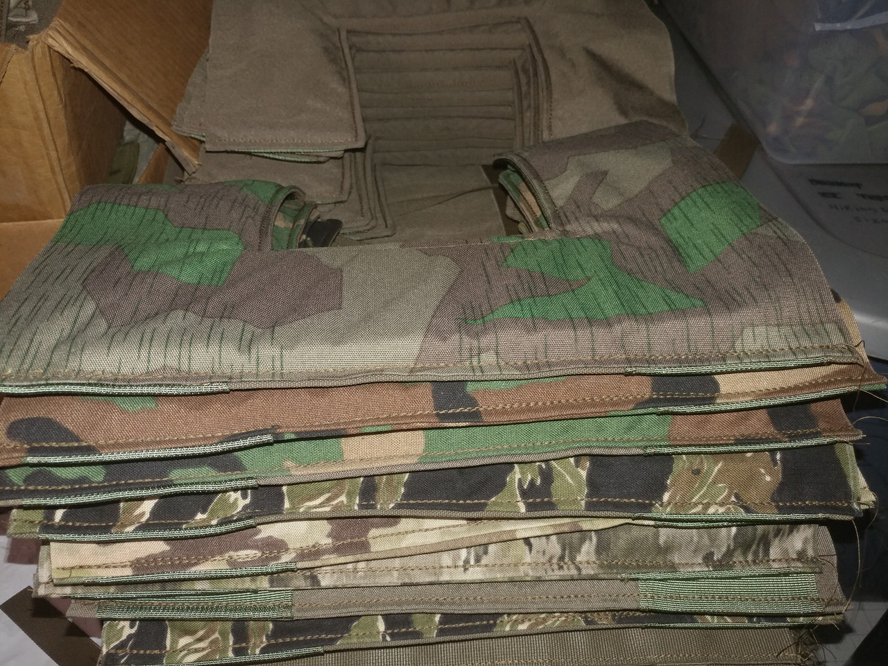

Stack of some of the frame panels (with the foam inserts) for the packs.
https://i.ibb.co/HLLJs2rk/1214250037.jpg
Pics don't load for me. Anyone else?
12/16/2025 11:05:55 AM EDT
Nope, not for me either.
12/16/2025 6:59:11 PM EDT
Fixed it.  Was having problems with the place I normally host pictures that night elsewhere, but I thought this one had worked.

It's probably fine - I'm surprised, the original alice pack only had one line of stitching on the outer face edges.  I went overboard and did 3 anyways.

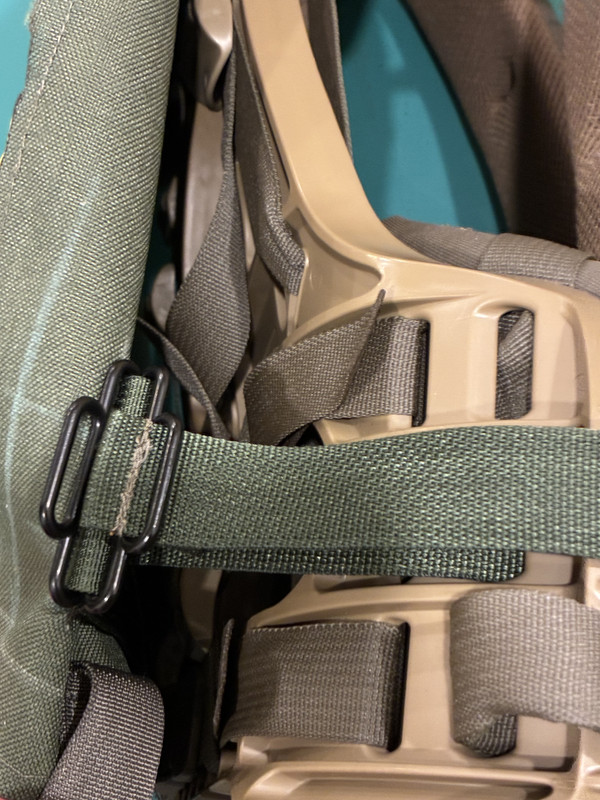

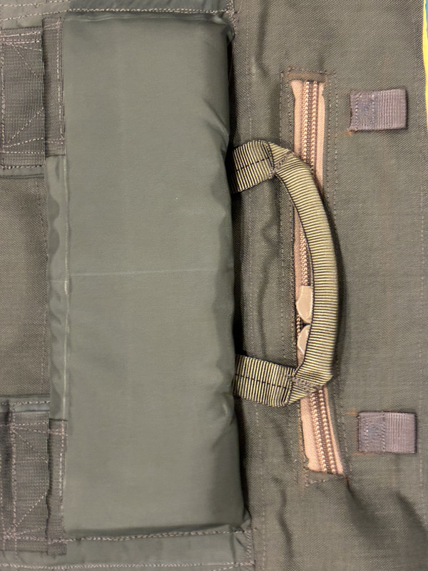

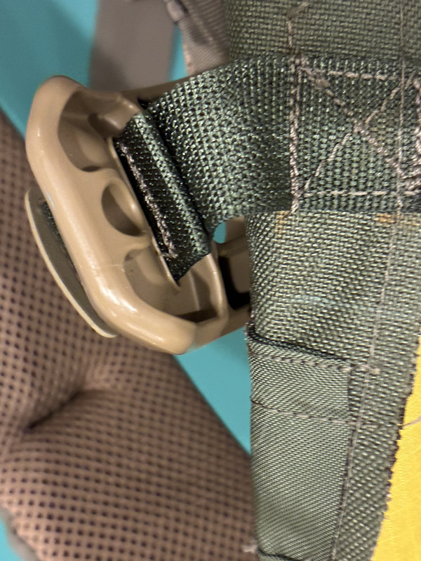

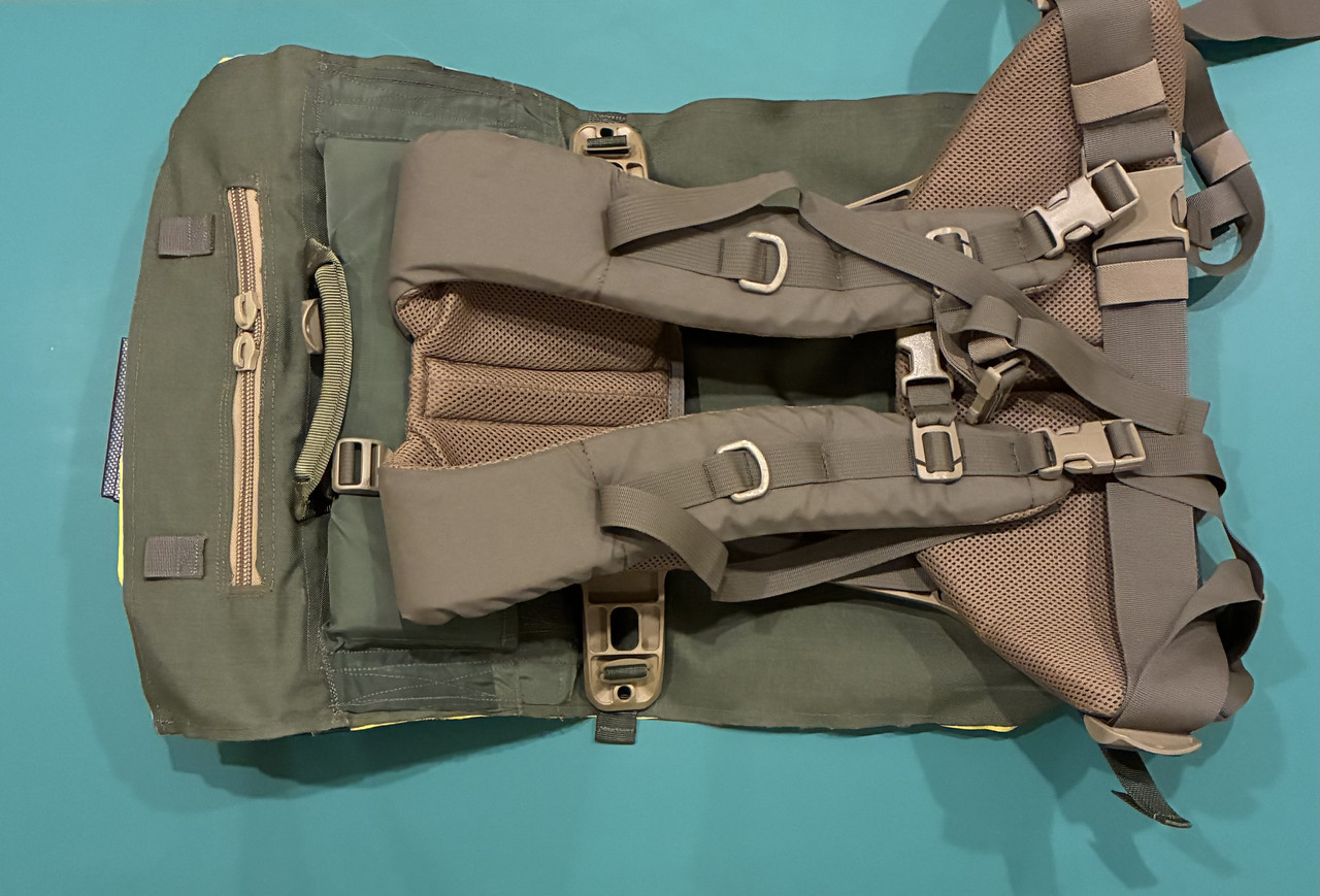

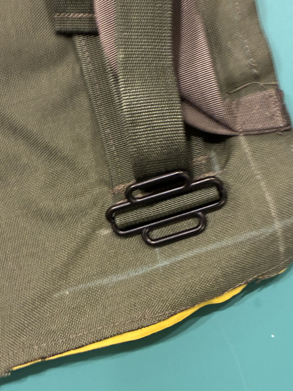

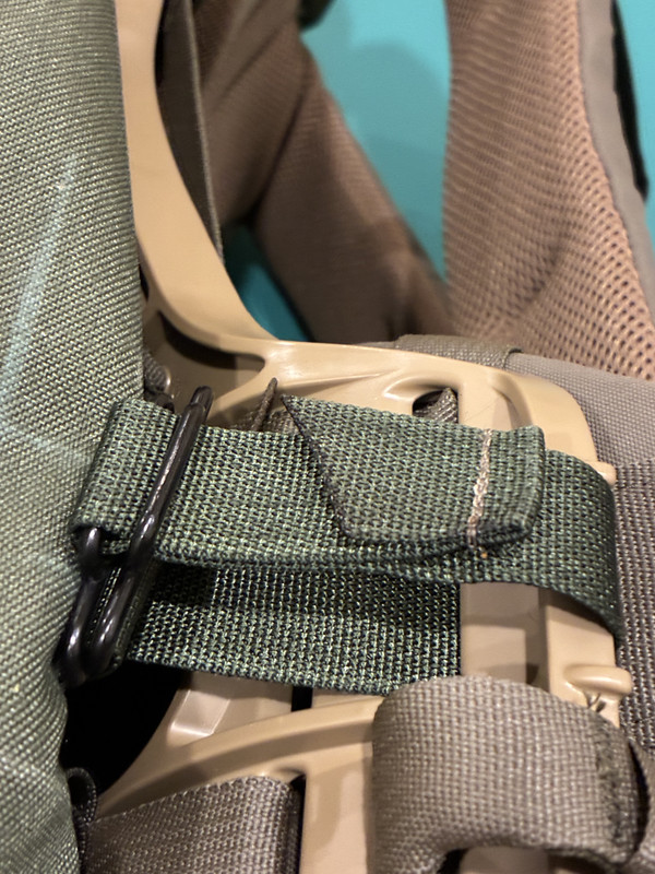

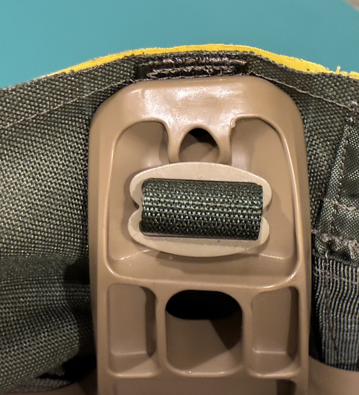

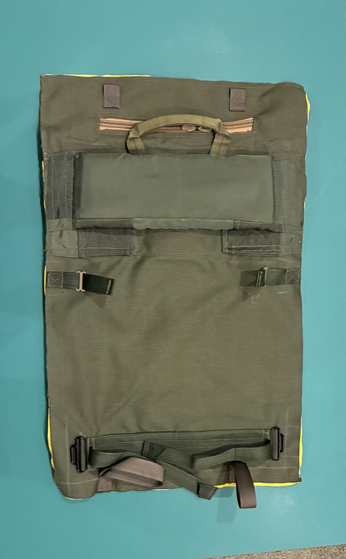

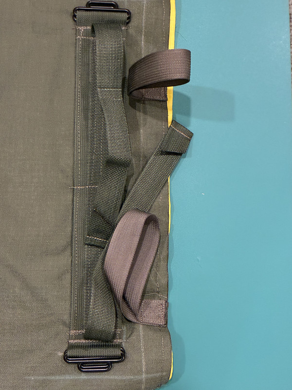

Started working on my second pack. Going to be on a 1606 frame.  Let’s call it a cross between an Alice, PLCE, and I guess a FILBE.  Started with the back panel because it has the most moving parts…..
General overview
Strap for top tab on frame
Straps for attaching to bottom of frame
The two loops at the bottom will be attachment points for the lid/compression straps. I have some nifty gated g hooks that will attach there. I’m going to loop those straps through the frame. This will help hold the pack to the frame and help keep the pack tight to it.
12/19/2025 2:40:11 PM EDT
Looks good so far man.  The second attempt at something usually turns out alot better, and you can see it compared to your first one.
How's the frame fit in the frame slot?  Did you get it where it's nice and tight?
12/19/2025 2:59:24 PM EDT
It’s snug, but. It overly tight. I probably could’ve sewed it an 1/8 inch tighter on each side.  Hopefully it works out ok. The straps for the top tabs should help hold it there. Plus the load lifters run through the opening.
The 1606 pad set came with a grab handle sewed onto the frame. But the fit was terrible with the load lifters because they all attached through the same holes. That’s why I made my own handle and sewed it to the pack.

Got the first lid done.  This is one with the claymore lid.  The regular ones will be the same, without the pouch on top, but with molle instead.
There are going to be a few tiny tweaks, but it turned out pretty well.  It's the same size as the regular Medium ALICE, but with 2 inches added to the depth.  The pouch is the same sizes as the various claymore lid pouches I've seen online have stated, give or take an inch or two. It's about the average of what I've seen.
I'm going to play around with how to attach straps to the lid.  Right now I'm running it loose, and am going to throw a couple triglides in there to let you guys dial it in how tight you want it (ie, make the straps adjustable).  I'm going to do one sewn down over the top, and one sewn down between the pouch and the lid.  If anyone wants something specific along those lines, let me know and I'll TRY and do it that way for your lid.
https://i.postimg.cc/C5dBhGrd/signal-2025-12-22-023714-002.jpg
Looks good, though if I had my druthers I'd probably take mine smaller than that. Looks like a top hat from this angle.
