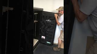

Just moved a 1000lb safe with a friend and PAID To move a 2000lb safe
Both doable
light 1000lb safe rolled on pipes and used the door open to "tip it" to get pipes under it. We used a pallet jack and tractor with pallet forks to move.
YouTube short of me by myself tipping an amsec BF6030 by myself after it was unbolted from the floor
How to move a 1000lb safe use door as lever(next put pipes under and roll!)
https://www.youtube.com/shorts/aXYa1-NHPno
and see 30 second in to moving the Amsec Bf6030
The Move is over, now living the Arkansas ozark's adventure in Homesteading!
PRO with TL30
Him and his wife used solid 1/4 metal rods, LONG pry bar, pallet jack, wooden blocks, and lots of adjusting. I paid them and they came from a few hundred miles away. No photos of safe and location
I paid around $600 and that included milage to get to me, getting it off pallet, moving it, and putting in new lock
