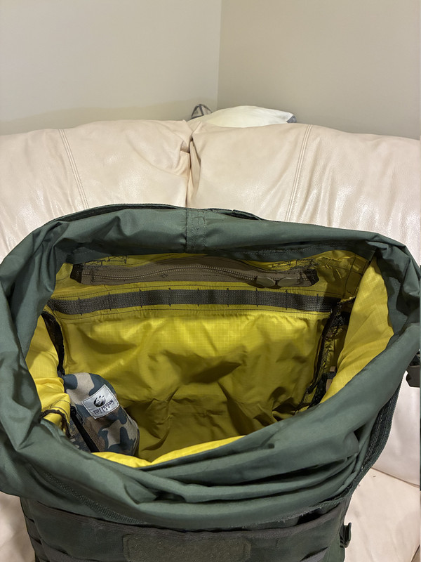

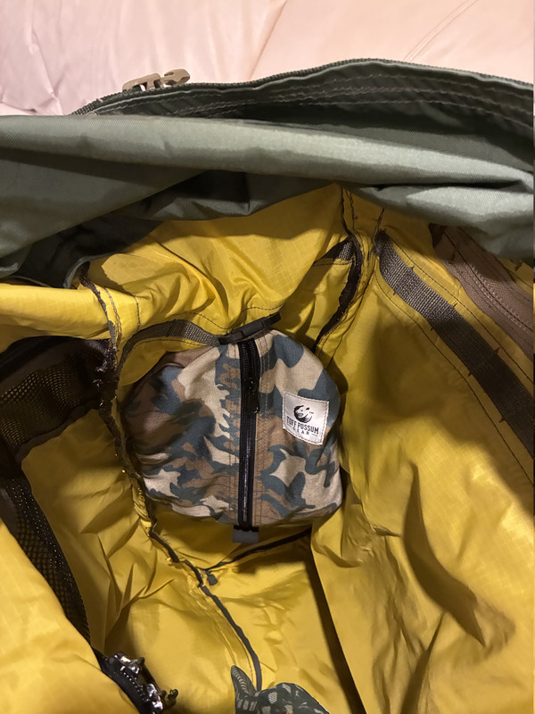

I'm planning on at least my packs for myself to NOT do a 'radio pocket' on the inside - and put a series of loops on the top to hold a water bladder if I choose to put one in there.  I can see doing more for hanging pouches like Crossfire does.  Good idea there.
Good idea…..
Webbing tabs and Molle Tee clips work perfectly here.

https://i.postimg.cc/qMbMnjz2/IMG_0369.jpg" target="_blank">https://i.postimg.cc/qMbMnjz2/IMG_0369.jpg
https://i.postimg.cc/PfMqftH2/IMG_0370.jpg" target="_blank">https://i.postimg.cc/PfMqftH2/IMG_0370.jpg
Yea, I don't like bladders, and the sleeves get in the way when you try to stuff things down into the main pack bag, and that's super annoying.  Plus adds weight that you might not use.  BUT I DO want the option to hang a bladder if I wanted to - or other pouch / sleeve / whatever if I wanted to for some reason.  Like that pouch you have hanging there - that seems super useful as a pouch outside of a waterproof bag liner to hold various things that I might want to get at easily.  I do something similar in my hill people ruck.
