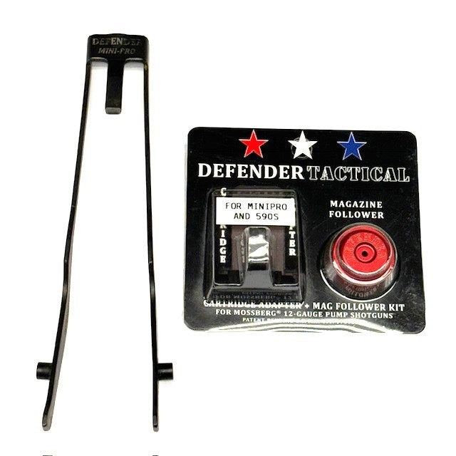

Mossberg makes the 590S that will do both but I could not find one in 18" so I got the 590A1 and put the Defender Tactical guts in it. this mimics the 590S lifter and plug. 100% reliable with "tator tots" and 2 3/4 shells. https://defendertactical.com/products/mini-pro ![]() Attached File
