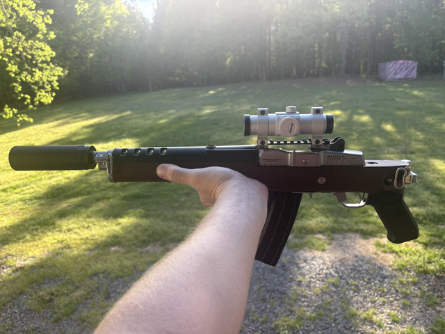

I cut mine to 11.5".  Cycled just fine with or without the suppressor even with some old weak Tula ammo.  I switched out to a .035 gas bushing and it smoothed out a lot but only cycles with full power 5.56 - I will eventually install a .040-.045
Plenty accurate for me - Im not shooting this for groups.
It has been my favorite rifle to shoot the last few months, it is so much fun to shoot.
