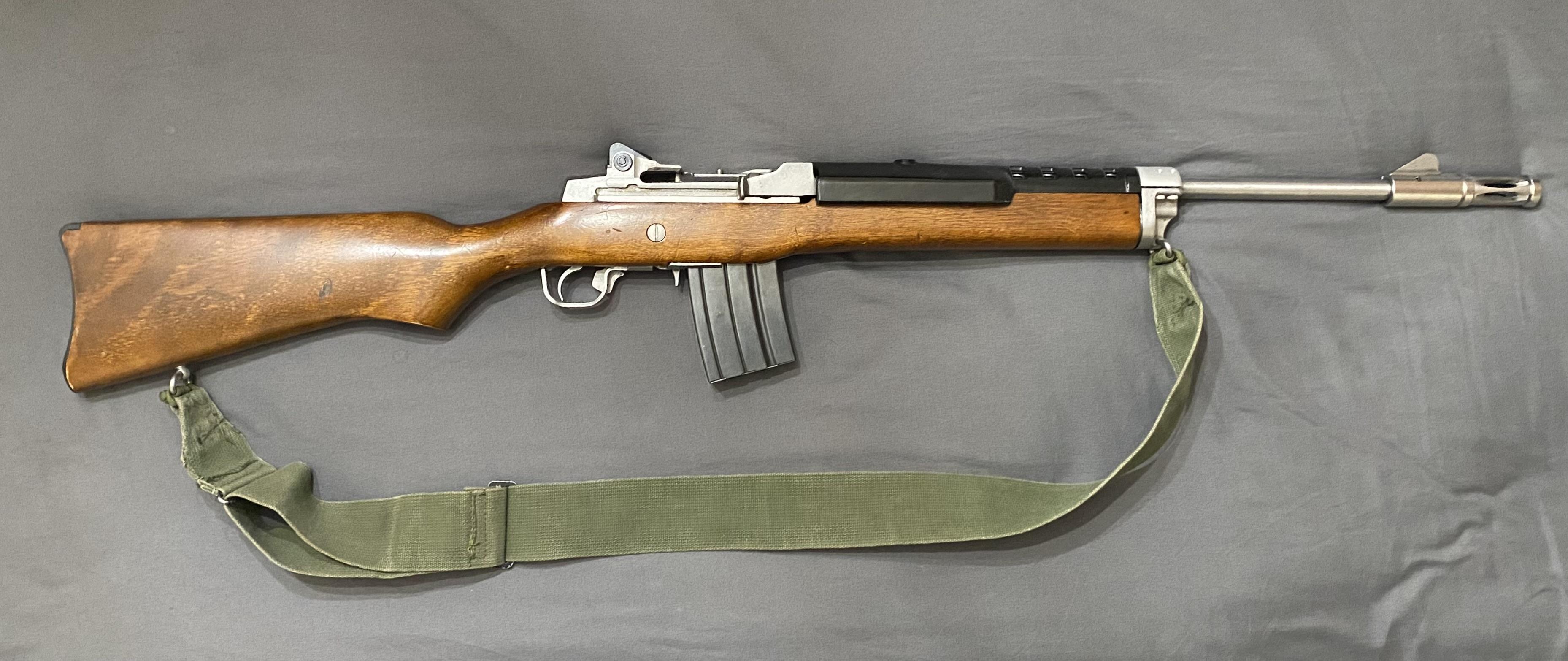

Is there a replacement buttplate option that can convert a crescent shaped stock into a flat buttplate?

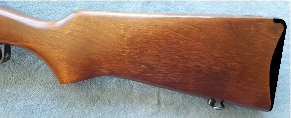

I got a friend that’s going to play around and see if he can 3D print me something like this. If it turns out I’ll post it up.
4/22/2025 9:09:41 AM EDT
[Last Edit: raf][Edited] [#6]
Originally Posted By Harperdr1:
I got a friend that's going to play around and see if he can 3D print me something like this. If it turns out I'll post it up.
https://imgdump5.novarata.net/onf8f3.png
Suggest making "thin" sections of butt plate (kinda touching curved "peak" points of wood stock) as thick as practicable, for durability.  Try to use impact-resistant printing plastic.
