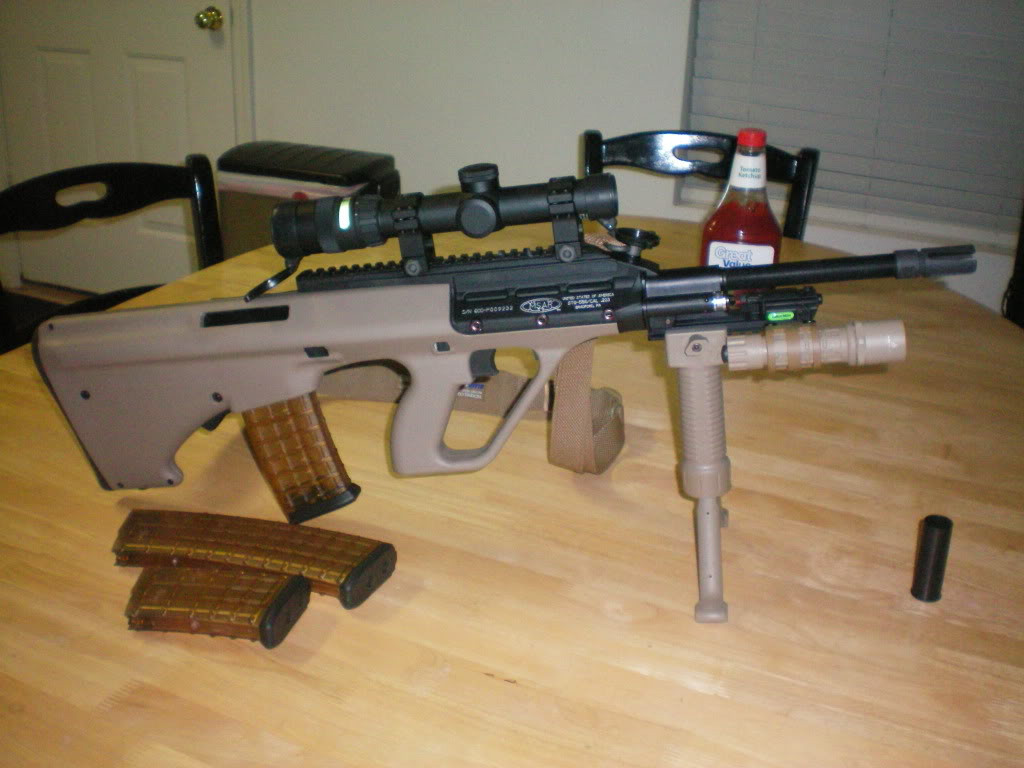

What is ment by squar or round lock? Does some one have pics they can post? It's the part that locks the stock to the receiver. Steyr's have always been squared-off. MSAR started out using a rounded lock, probably to keep their parts proprietary, but eventually switched over to the square lock. Do you mean rounded off at ther top corners? I have never held a real Aug for more than a few seconds before. I guess a better way to ask is , What kind of lock is this? Can this rifle use Cheap Aug mags , or am I stuck with the STG mags that are hard to find? http://i52.tinypic.com/k1atyo.jpg That's a square lock. When you see a rounded lock, there's no doubt about it. The shape of the lock has nothing to do with which mags it can take. The earliest STG stocks had raised ribs inside the magwell to prevent Steyr mags from being used, but 2 minutes with a nail file would remedy that. The best indicator is the forward assist. If the stock doesn't have the forward assist, it will take Steyr mags without modifications, but again, it's a super easy fix. |
