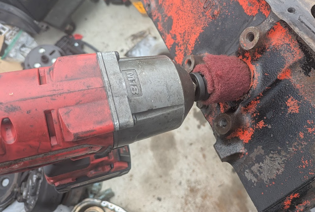

Personally, I'd just wrap some scotchbrite around a socket that fits well into the hole and spin it around with a power tool.
