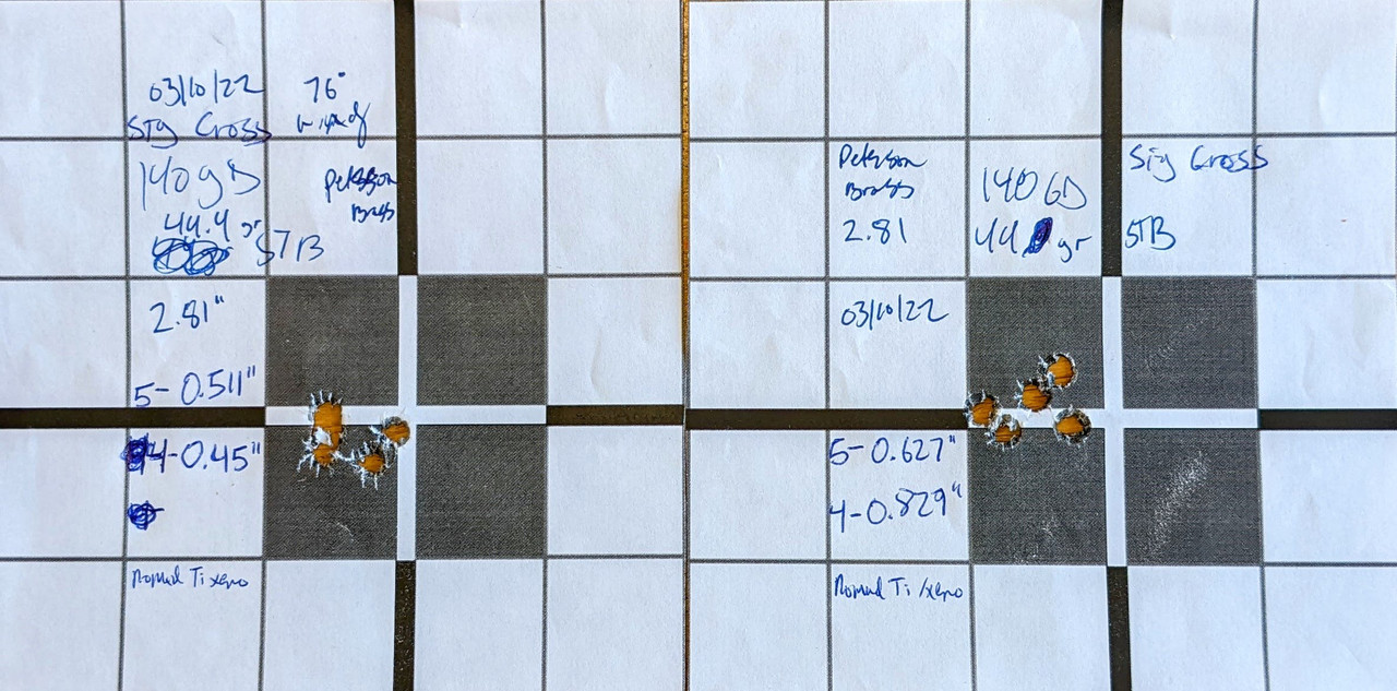

5/18/2026 6:14:16 PM EDT

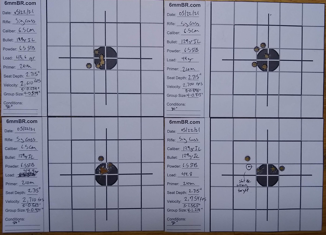

Let's see some groups and load data.

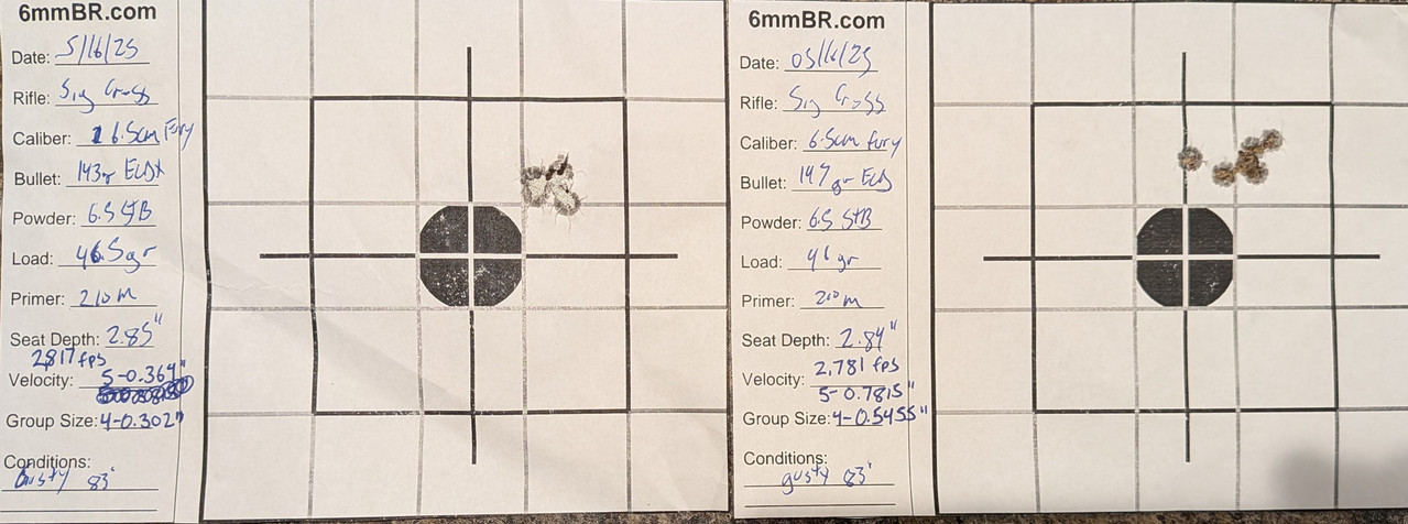

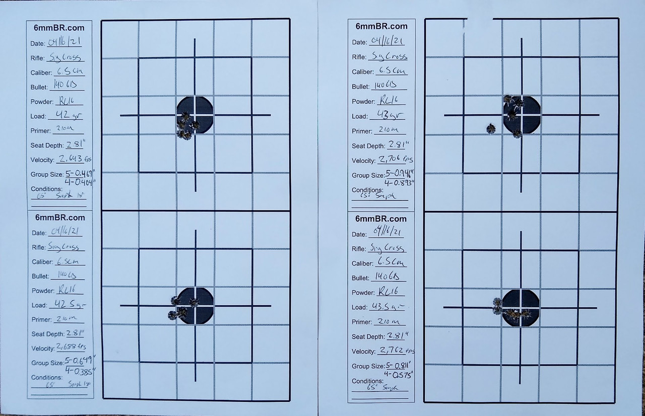

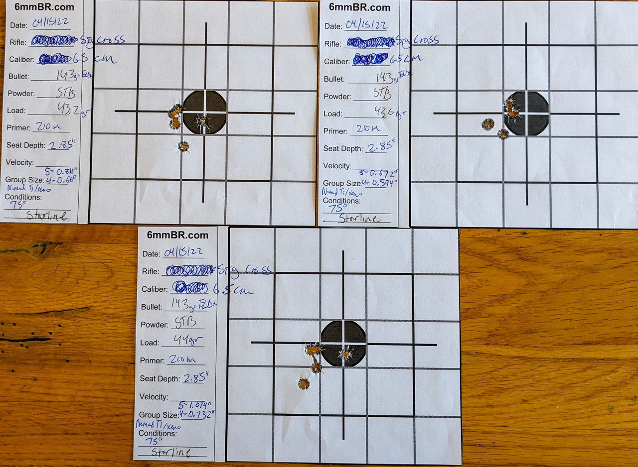

5/22/2026 9:07:40 AM EDT
[Last Edit: Gtscotty][Edited] [#10]

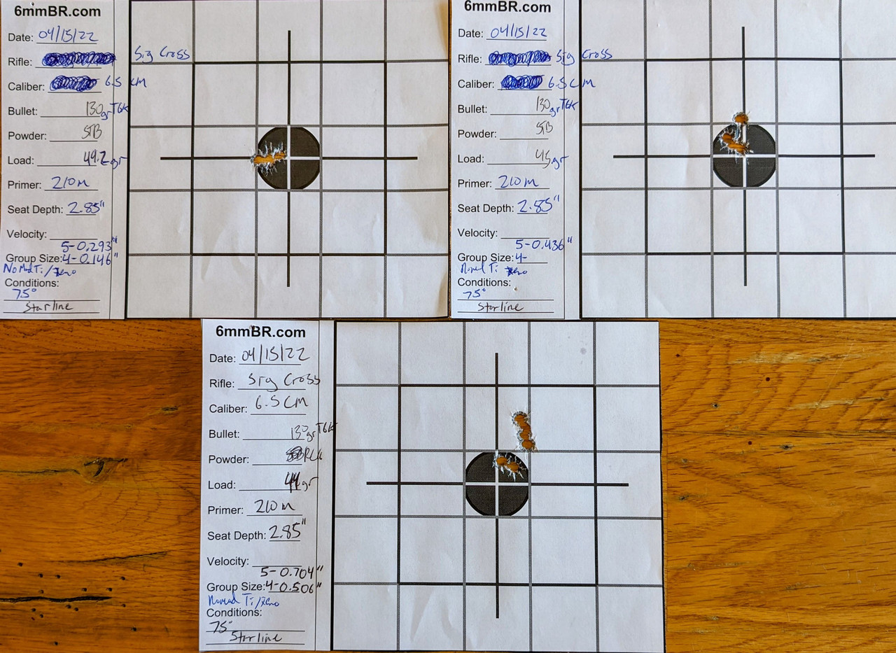

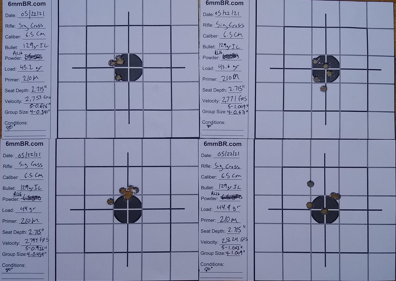

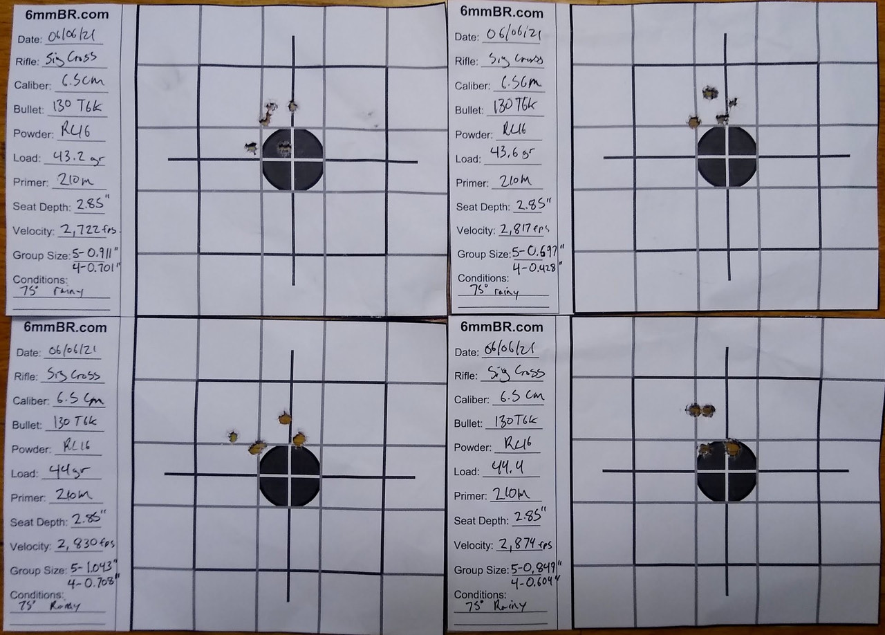

Here is some load development groups for my early version in 6.5cm. I actually bought it as a .308 right when they first came out, but swapped the barrel with someone who had the 6.5 but wanted a .308 a bit later.
Both barrels were good shooters and now I have another new .308 factory barrel that I'd like to try, but can't find a barrel extension for sale anywhere and don't really want to break down the 6.5 barrel assembly to swap in the .308.
I do think If the SBR engraving requirement removal gets finalized I may go ahead and SBR my Cross and get that .308 barrel cut to ~12".

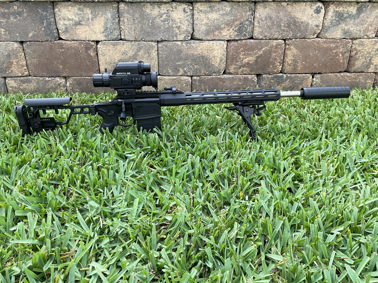

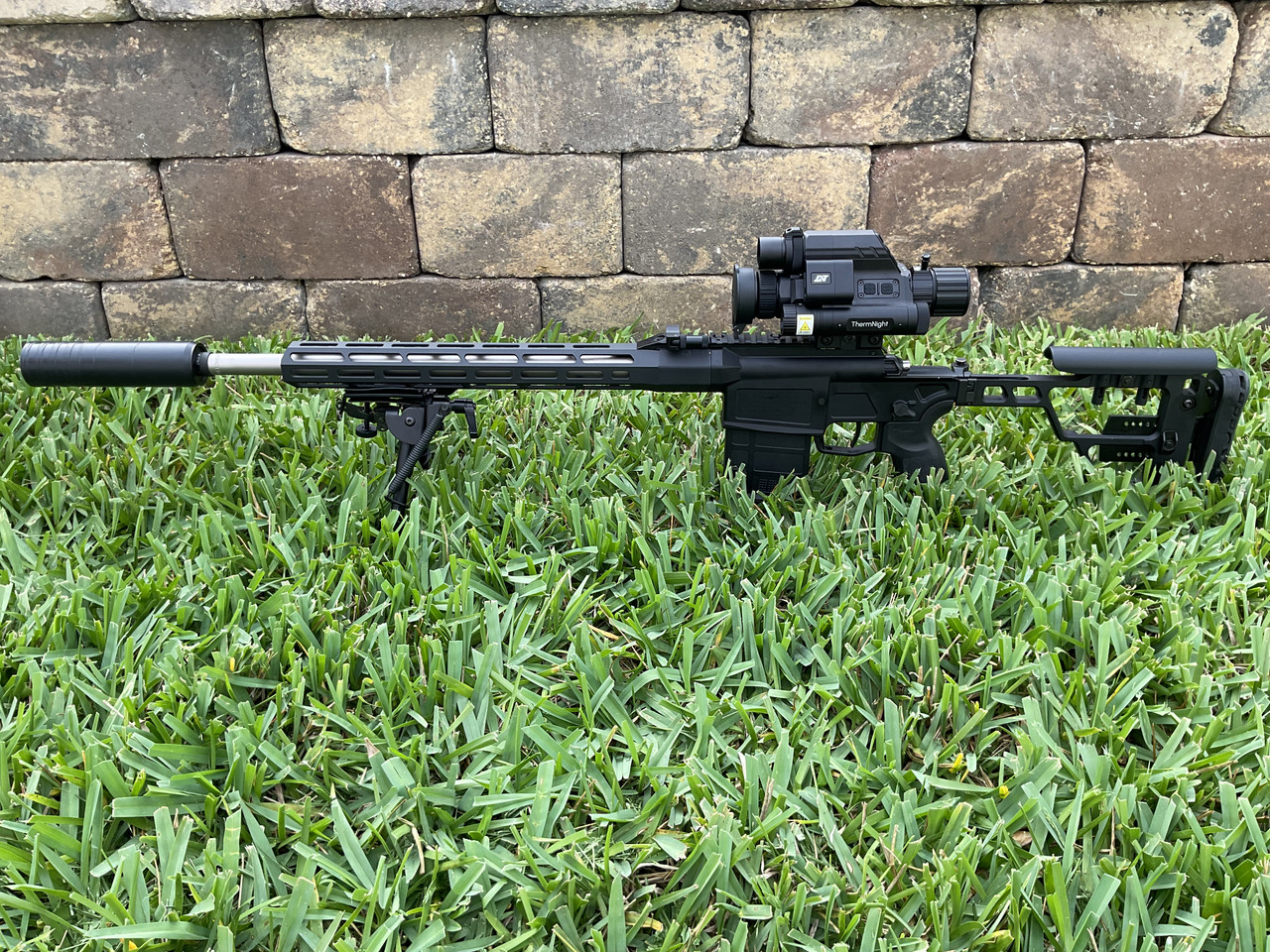

6/29/2026 10:41:28 PM EDT
6.5 Creedmoor, Otter Creek Polonium 30, DNT ThermNight 335R
