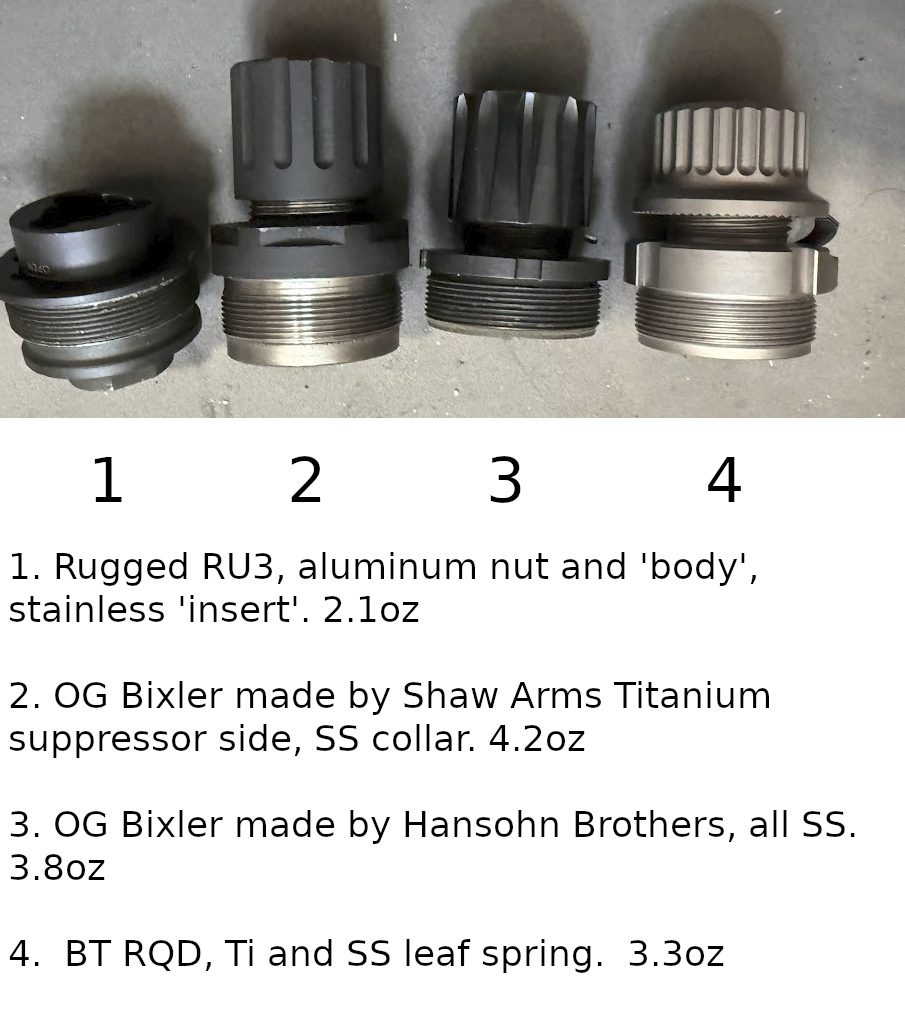

That was a great video but wanted to mention 2 things.
1.  Regarding being compact and aesthetics -   this is AR15.com and so I like to run a lot of 9mm M16's and prefer a slim rail that most cans will not fit under.  So with the OG Bixler, you can tuck the nut inside the rail like seen in my picture below:
With the can removed, you don't even know there is a 3 lug under there unless you look close.
So for the setup pictured above, only mounts 2,3 below would work.  The RU3 and BT are too fat to fit under that rail.  The BT will partially go under some rails but since the nut has a flange to interface the leaf spring, it can't go in as deep as 2,3.  EX: the  grooved section of the BT nut will fit nicely under a BCM MCMR but the flange is too big.
The OG Bixler nut is only 1.125" diameter so will fit under just about any rail in existence.
Now of course this doesn't apply if you are running a gun that has a completely exposed 3 lug like an MP5.

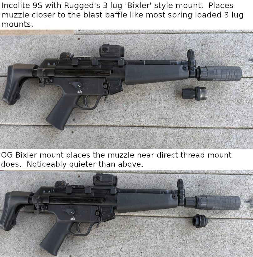

2.  Regarding the loss of volume.  This is can specific.  With some cans, I agree that you won't notice a difference but in my two examples below the difference in sound is noticeable.
I think the setup below looked great but it was really loud with the RU3.
I switched back to the OG Bixler for this can.
The RU3 being aluminum is a flaw, IMO.  Note the wear in this pic from a thread over at reddit:
Mount material probably should've been SS, or at least Ti. Weight savings was obviously the goal, but still, when it comes to the mount hardware, Al isn't going to win a friction fight with a steel muzzle device. Just saying.
Hansohn Bros Bixler mount isn't listed on their site, so I assume it's OOP.
