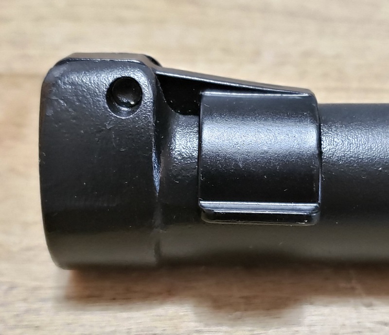

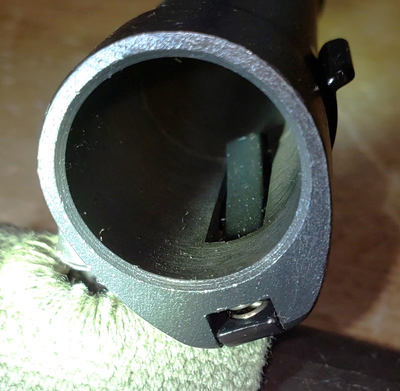

My DSA 58 Congo Para is bipod cut and accepts the Type 'C' tubular socket bayonet.
https://www.ar15.com/media/mediaFiles/766/dscn1317-3428788.jpg
How does it clip on and off exactly
I looked online for a video and ill be danged if there doesnt seem to be a single video for attaching a FAL bayonet. Granted youtubes policy may have nixed any that showed this
I understand it goes on the flash hider but didnt know how it locks/unlocks
Battle Of West Appalachia Survivor
Slides right on. At 6 o'clock on the back edge of the flash hider (combo device) is a notch for the bayonet latch to engage. Lift the latch and pull forward to remove.

1/10/2025 2:01:27 PM EDT
The piece on the rear is the spring loaded lever to unlatch it from the FH - pull up on it to unlatch the bayonet.
The internal spring loaded locking bar that catches on a slot at the rear of the FH.
HTH
