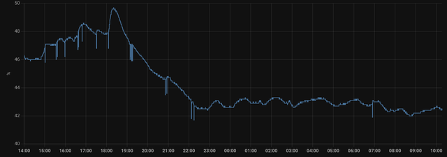

Here is the garage. The spikes you see are from opening the big door.
Shoot straight and tell the truth!
