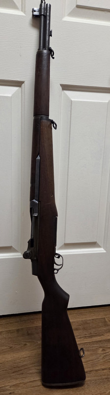

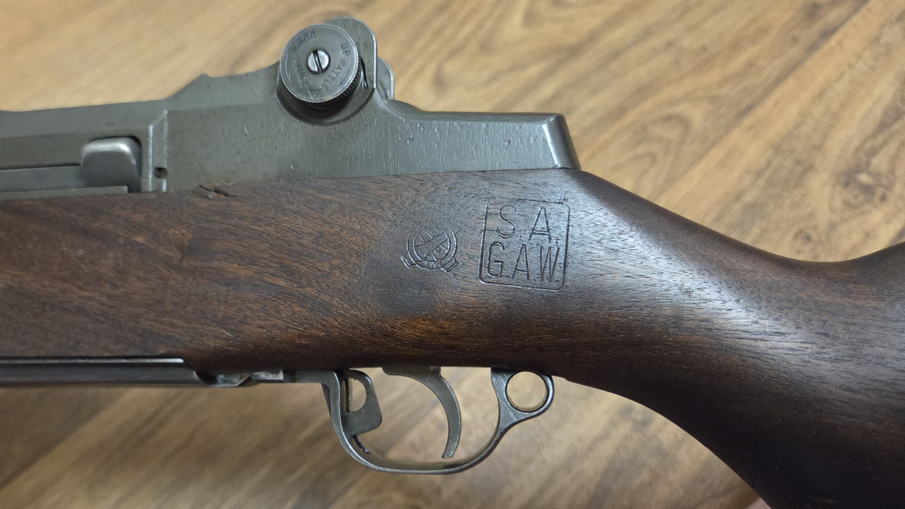

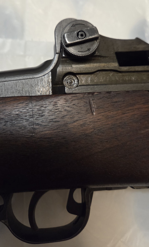

I have this m1 garand thats a winchester, serial number puts the production date at December 1942 to January 1943. It was rebuilt at the Springfield Armory in September of 1965. Thats all I know about it.
6/6/2026 5:57:55 PM EDT

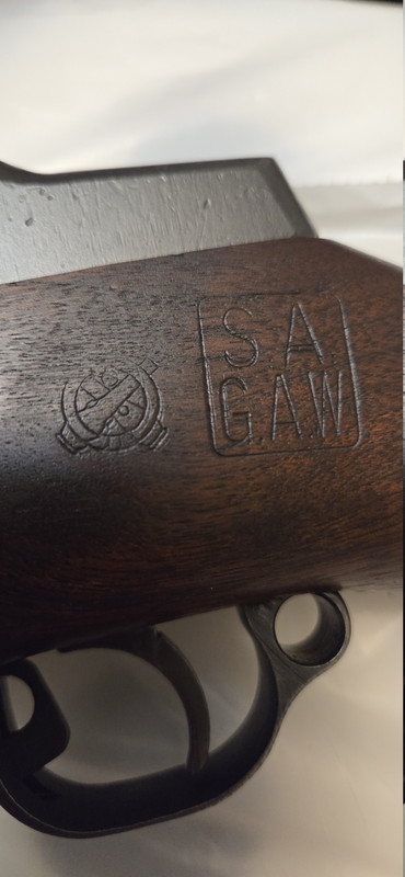

I know the SA/GAW stamp is the George A Woody stamp from Springfield Armory.  It is kind of a sought after stock.
6/6/2026 6:16:31 PM EDT
A wartime Lock Bar rear sight and wartime gas cylinder lock. The postwar lock had a poppet valve and a Phillips screw look to it.
The front sight wings look pretty flared.  Iirc, H&R and IHC's had wider flairs than Springfields or Winchesters.
I highly suggest Scott Duff's book "M1 GARAND OWNER'S GUIDE".  It's a 126 page guide that will teach you how to oil/grease and care fir your rifle.  Along with how to zero the sights and covers many accessories.
I'd link to Amazon but have never figured out how it's done.

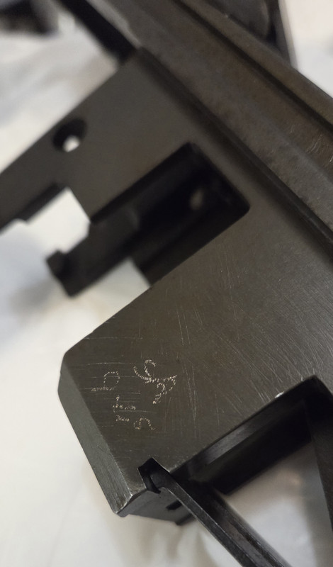

Your receiver heel has been molten lead dipped as a form of annealing. Thus the 2 tones of parkerizing on the heel. What is the serial number with the last digits as XXXX? as in 1,569,XXX as an example.

The serial 1,276,54X

The lock bar sights and the early gas valve would not have survived a 1965 rebuild.  I suspect someone "restored" this back to period correct.

Thats kind of my thoughts as well, the op rod is also cut but it is the right draw number for the year of production so I dont know if they completely removed them during a rebuild or just cut them and kept them
I believe the cartouche is "restored" too. Windage knob is Winchester, elevation is Springfield. Front sight is Winchester. Winchester and IHC had the wider wings. Springfield and HR has narrow. Winchester op rod for sure. Post some pics of the markings on the trigger group,op rod, bolt,and barrel and we will be able to tell you more.

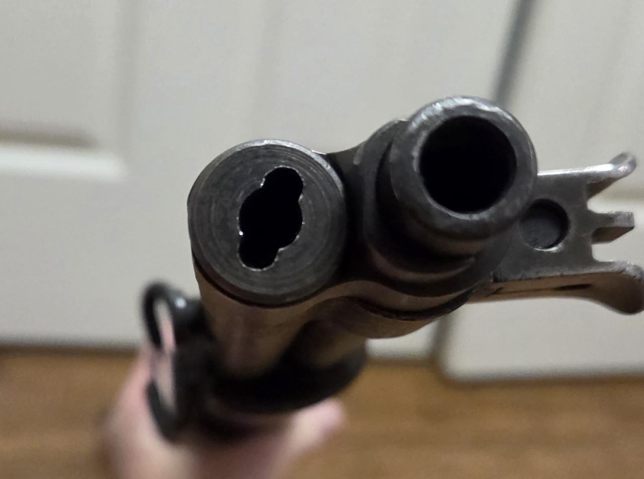

Yes someone has added parts that wouldn't have survived a SA-65 rebuild. Muzzle / crown looks beat hard. What is the bbl ? Wra or SA.
Stock looks ok probably also added later. Bit of a crack starting at clip latch cutout.

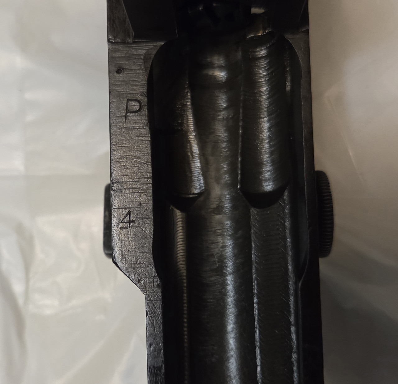

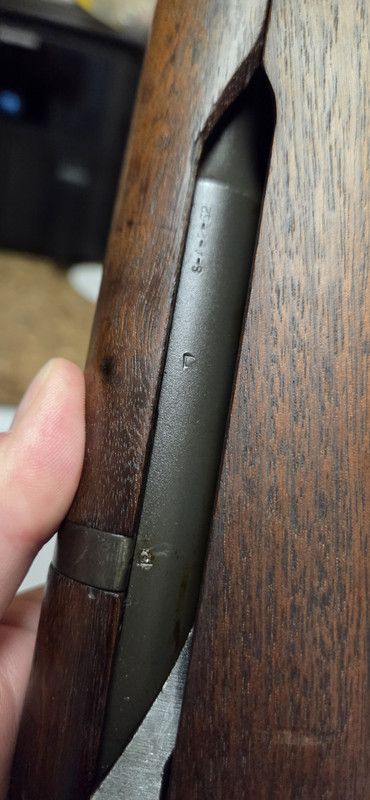

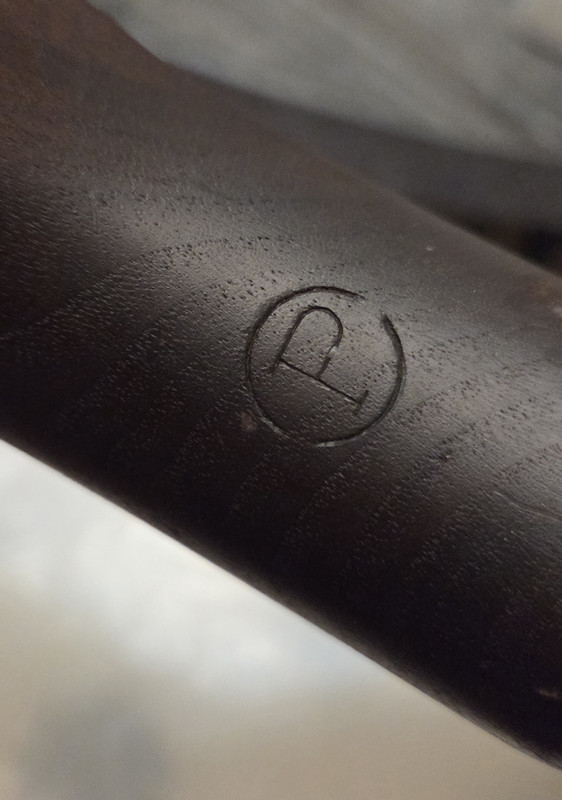

Barrel is a SA marked 9-52
ME - 1.5 TE - 4
Its apparently an imported barrel but I don't see any import stamps but I have NOT taken the front handguard off to see if its a blue sky marked barrel or what, i can only see SA 9-52 and the "p" pressure stamp

Import markings would be visible without removing anything,blue sky marked theirs like a billboard between the front sight and front handguard. What makes you think it's import?

Theres a marking underneath the pressure "P" the previous owner who i bought it from said it was an import mark so im just going off of that

52 barrels are a very common replacement barrel they made a ton though for a 65 SA rebuild I would expect a  1960's SA barrel. The P by handguard clip is punched not SA T stamped but not sure if they were still doing it that late . It could have been replaced in previous rebuild.
With as much parts that have been swapped with this one anything is possible but that muzzle bothers me..

What would that reading of muzzle wear indicate?
6/10/2026 6:14:15 PM EDT
A 1.5 muzzle is very serviceable. You may want to touch up the crown a little,but shoot it first.That barrel is not import marked ,most garands have that.

6/11/2026 10:48:16 AM EDT
Indicates wear. Garands barrels are soft and muzzles get easily damaged and deformed from abuse so a gage reading is kinda pointless without visual inspection of muzzle and crown. I can make any barrel read 1 with a dead blow hammer.
Like pointed out shoot it and see how it groups sometimes the most hideous muzzle and crown still shoot well. If it shoots bad a simple recrown might make a big difference.

But i do believe that at some point in its life someone did try to "restore" it back to factory parts and thats why it has the early style parts on it, it would be cool to track down if it was ever in an actual war but I heard that is pretty impossible to do. I mean as it sits, is this like a collectable rifle or just the same value as something the CMP has to offer?
It's a shooter,with a more desirable receiver. Mix of parts,fake cartouche,ect. In my mind still more desirable than current CMP stuff,but just a good example of a M1. Nothing special.  If you have a ww2 Winchester barrel with an actual 1/1 reading it's almost as valuable as the rifle. If you give the bolt and trigger group markings I could tell you more. You're never going to be able to prove it definitively,but a 1943 rifle not seeing battle would be unusual. We needed all we could get and stateside guards and such were mostly issued 03A3s or 1917s. Garands went to combat troops.
