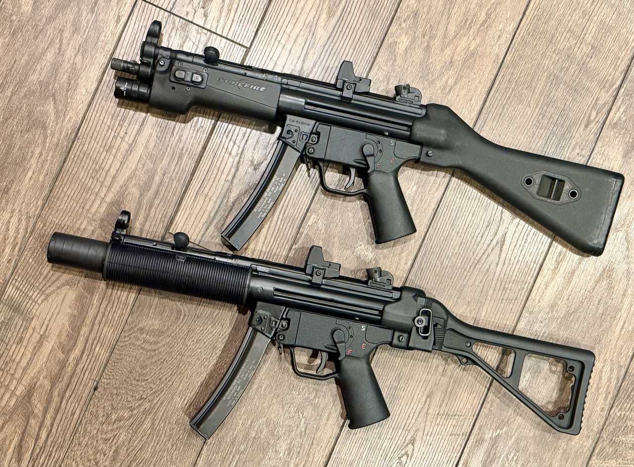

I'll play.  HK & MAC5K.  Both have RG packs.  OCL Lithium & Cat MOB.
6/18/2026 12:50:31 PM EDT
https://i.imgur.com/NuFVELX.jpeg
fancy.
I gotta get some straight mags for the aesthetic.

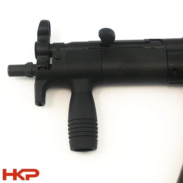

Does anyone have a lead on someone that makes a handguard/foregrip similar to this but for a full sized?
7/6/2026 11:33:18 AM EDT
Originally Posted By Dolor:
Should have my paper work back soon.
https://www.ar15.com/media/mediaFiles/418820/VFG_png-3790628.JPG
If you combine that K grip with one of these spacers you can use it on the full size:
https://hkparts.net/handguards-foregrips/hk-mp5-hk94-vertical-k-grip-adapter/
7/6/2026 12:18:45 PM EDT
[Last Edit: Dolor][Edited] [#19]
ooh I see now. I was wondering why they heck they don't make them haha.
Now a question if I just get the VFG and keep my B&T rail or do the spacer VFG combo.

Top:
A POF MP5 converted to a proper SD.
Bottom:
A DJ Getz SP-89
