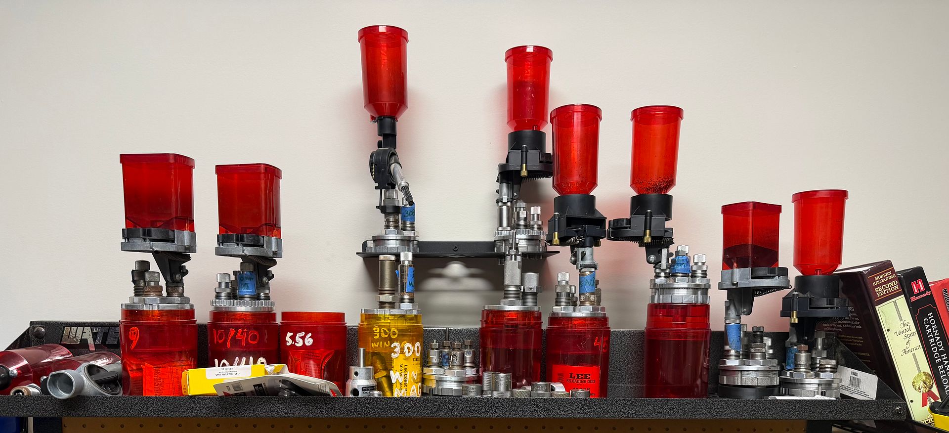

I started with one of their single stage presses ages ago.  I added two turret presses.  I use their load all 2 for shotgun.  I have a hand press for low volume stuff, etc.  I have their pro-1000 progressive.
A part wore out on one of their turret presses.  It has been completely changed and they will do a 50% off on another press.  I don't think I'll bother.
My pro-1000 uses their load three hole die holder.
I do my decamping/resizing on one of the turrets and a hand primer.  Over the years I have had issue with mil type crimped primers, it lets me check brass, etc.
My pro-1000 runs like a Swiss watch.  I fill the case feeding tubes with primed cases, they get powder, expanded, next station I seat, next station crimp, and out they come.
To switch from 9mm to 40 I change the die holder.  In a second, like nothing.  I use the handle on the left.  Easy to see powder and put bullet on with the right.
So, I decided I wanted another to do 357, and could just swap the holder and do 38.
It has arrived.  It is shorter at the base.  The bolt pattern is different.   You can't just drop a set of dies on it.  You have to change each die separately.  Half the reason I got one.  Just twist pull out my 357 set up, and put in my 38 die set up.  Also, the cases don't feed from the front anymore.
They first die is no longer at 6 o'clock like the old one and the turrets.
How the hell do you plastic man reach around with the case feeder in the way and see powder and put a bullet on to seat?  They have destroyed the versatility of the press, pissed on decades of die and die holder compatibility, and ruined the easy die holder quick swap out.  Plus there is the weird long throw of the lever.  Its bottom end is way lower than in the previous.
They have also replaced the powder dispenser.
The total abortion next to its predecessor.
What possible reason do they think people want to change out individual dies, desired to twist away orientation from first station at 6 o'clock, essentially have to buy a stand to bench mount, etc.
I'm sending it back.  I'm not taking them up on the 50% off on a new press.  If I was smart I would look for a lightly used old one, but I'm too pissed off.
I'll make a changeover to a whole new brand.

I've got 3 pro1000s.
First one I got back in mid 80s I got three turrets with universal decapper in #1 & #3 put dillon size/trim dies for 223, 6x45(mod'd 223 die) & 308w (for my ar's & sav99) so all I do is swap turrets, rt1200 & shell plate (#4 & #2) so I got a progressive decapper, full length sizer & trimmer.
Need to get a size/trim die for 06' so I can run my garand cases through it.
My bolt rifles cases are neck sized.
Other two pro1k I just swap turrets, One I load 38 & 357m on, the other 9mm & 40s&w.

I know.  I do 9mm/40 on one with just a quick change of the die holders.
That one has the same bolt pattern as my turret presses of their’s.
I bought this one to do 38/357.  I swear to God I watch a YouTube video of the “new” one, and it still took the three hole die holders.  It showed up, I removed a turret press, and it has a different bolt hole pattern, and it seems very iffy that I could get it mounted to the bench and work directly without buying a stand.
I sometimes adjust the case feeder on mine, put on a new die set, do 5.56, then swap die holder, and do a run of 300 BO.  I was going to get a third Pro 1000 for that.
But this is like loving your Toyota Tacoma, going to get a new one, and it’s a Hyundai Santa Cruz that says Toyota Tacoma on it.
I have dies and holders with full die sets and powder dispensers, either for 4 hole turrets or 3, etc. in 300 Win Mag, 30-06, .308. 30-30, .303, 8mm Mauser, 12.7x44R, 7.62x54R, 5.56, 300BO, 9mm, .40S&W, 10mm, 38, 357, 45 Colt, 44 Magnum, 45 ACP, etc.
This screws decades of compatibility for me.  Guess I’ll be looking at Dillon, Frankford, RCBS.
Their 4000 and six pack pro use the same damn swap out each individual die.
I never would have bought another 1000 if it wasn’t really a 1000.

Aren't those quick-change twist lock die holders.  You set the die depth just once.  Thereafter, it comes out and goes back with a small twist.  Am I mistaken?
Theoretically.  One of the points in their response to my-
"If you discontinued the Pro 1000 just make that clear.  This is not a Pro 1000.  Call it the Pro 1100.  Or the 1010, 1020, 1030, whatever depending on how many updates from the original.  You took a versatile press and turned it into a limited one and destroyed legacy bolt patterns, die orientation/position, and quick change die sets"
'Well, this way people can store their dies in the original boxes and quick change each one. "
And noted your point.
But it doesn't really work well that way when your die set is all perfectly set up with the powder device on one, etc.
It was fantastic to just do a small twist and change out the entire die set up.

I started with a single stage as well.
I have more than one 1000, turret presses, etc.
Under one turret I just swap out the 5.55/300 BO set, the others has die sets, etc.
Under them is a hole with a funnel that catches primers.
Let’s chalk my extreme discontent up to expectations.  If what had arrived was actually a Lee Pro 1000 and not some entirely new model that is called a Lee Pro 1000-
I pull the turrent press with the broken part they can’t replace, bolt my new 1000 directly into the holes, put a die disc on there, and start reloading.
Now I’m looking at new holes, reversing the handle with the new curve pattern - shit, with the new cruces it’s not really reversible, the throw is way lower, the new die angle has issues, it will kind of want to drop loaded ammo off the front of the bench?
If one of your older 1000s broke, you would be happy to get the new version instead of just straight swap?

I get the annoyance.  But I'm tangentially curious, is thr new design better?
Lee can go either way, their handprimer was the best  out there, and they screwed that up.
But sometimes they can surprise.  Their new micrometer dies are actually pretty great, for dirt cheap.
Curious the thought o. Their latest press designs.  Which they foolishly give the same model number to as before, that's nuts.  But I'm still curious.
Lee can go either way, their primers was ther best  out there, and they screwed that up.
From a purely objective perspective-
It used to be based on the strong, cast base of their classic turret press.
Now it uses a thin, non raised plate of aluminum as the base.
If you were interested in weight savings I guess that’s better.
I suspect it’s because it’s a much cheaper base.
It’s less suitable for mounting direct to a bench.  But I guess does that make it better for mounting to a mount?
New priming system is going to be better.  But I’m a hand primer.  I find split cases, there are not infrequently issue with priming on the press with brass with crimped primer pockets, etc.  As has been noted, they made their hand priming tools worse.  They went away from solid round trays to solid square trays to flimsy, bendy semi clear plastic.
The roller hand is nice, but it has a lot of bends and curves and isn’t completely reversible.
It’s looks like the new linkage mechanics will give more power on the strokes, but you either need it mounted high or orangutan arms.
Some companies use quick, single die change systems.
Others use a die holding plate or disc you change out.  That is my preference.
Looking back, they changed the base years ago.  But it still had the compatible top.
I had just watched a review of the “new” upgraded one before I ordered.  It had the top I expected.  The top change to single die is just new as of this year.  As is the crazy bends in the new handle, etc.
I didn’t catch the base change watching that.
So…
In my opinion - it’s on me that I wanted and expected another 2009 Lexus GX460.
And a 2023 showed up and I didn’t want car play, the new screen, captain’s chairs, etc. But - I still got a 460.
In this case, I did not get a GX.  I got a Lexus TX with a GX label on it.
Is a Lexus GX or a TX better?
People do choose a TX over a GX.
But…if you were expecting a GX you would be pissed.
If a GX550 had showed up…

Basically, if I was going to reload one or two pistol and one or two rifle calibers,
I’d probably have a pair of high end progressives and be done.
The beauty of Lee is to get a new reloader in the game on a budget.
The utility of Lee-
You can have a press that does 9mm and 40 and 10mm just swap the heads and go.
Another press that does 5.56 and 300BO with a quick swap and go.
And one for 44 mag and 45 colt- again just change the head.
And a turret for lower volume stuff like 300 win mag, 30-06, and 308- again, just swap the head and go.
And a cheap loader for bird shot for trap/skeet/3gun/sass.
I’m not by any means saying they are for everyone or the best.
But I’d rather have a handful of presses that work and require a single change to swap calibers vs a high end one with much more work to swap.

I walked up to my oldest Pro 1000, pulled the 9mm head, put on the 40 head-
Poured in some powder, and cranked out a bunch of 40.
As simple as can be.
Same with another press when I swap between 44 mag and 45 colt.
This press was going to be for my 38/357 swap.

Well if you want a more efficient decapping process, Lee make a great press for that.
Called the APP. Automatic processing press.
My APP in action.
Case feeder tube, when empty, you rotate to the next one.
Top of feeder tubes is a round hopper.
Dump handful of cases in shake hopper and cases drop base down into the tubes. Slick.
Every pull on the press handle drops a decapped case into bin.
Last week I decapped 1k of 10mm and 500 44 mag cases in less than 2 hours.
That includes bolting press to bench, changing over from bullet sizing to decapping.
Setting up press for 10mm, then changing over to 44 mag.
When finished unbolting press and placing it in storage for next time.
I use a Lee Universal decapper as I always decap before wet tumbling.
That’s pretty cool.  I have never looked into it.
I have turrets with 4 different depriming/sizing dies in them.
I pull the auto index rod.
Then run a container through.
I catch most casing with issues.
Then I hand prime the cases at some point.  I’ll get rid of a few more cases with issues-
And catch some more with priming issues.
Doing it on a press with a case feeder would certainly save some time.
I don’t know where I would squeeze it in.
9/20/2026 11:17:59 PM EDT
That's why mine is bolted down to some nut on the bottom of my bench.
Takes 1 minute to mount it or take it off to store.
