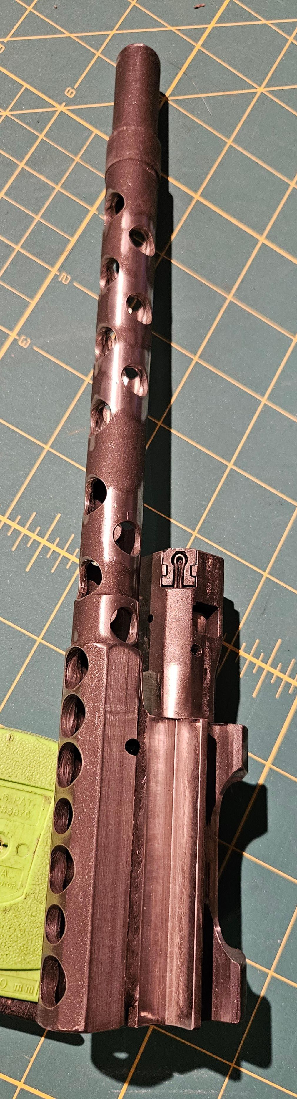

Back in the day I made one for my Cetmes.  I started with a Cetme BCG and removed the locking piece and rollers, made a fake LP from aluminum and pinned the bolt back against the carrier.  If I was doing it today I'd just tack weld it  but I wanted to be able to get the firing pin and spring out if there was a problem.  Then I drilled and milled  much metal off of it to get the weight close to the straight blowback training bolt.   It looked like shit but worked fine.  I probably still have 600 rounds of that stuff somewhere. The blue cases kind of get soft when things heat up.

https://media.fotki.com/2v2ZqRqF9xAjwmD.jpg
Very nice info!  Thank You.
For what you can get a CETME parts kit for might be worth it for those that have a need.
9/12/2026 7:07:13 PM EDT
Cetme BCG's  are not interchangeable with HK.  That's why I had to modify a Cetme carrier to shoot the blue stuff instead of buying an HK DAG bolt.
My point was that you can modify an HK BCG by removing the rollers and pinning the bolt head back and removing excess weight.  It's that or finding the proper BCG which sounds hard to find.
