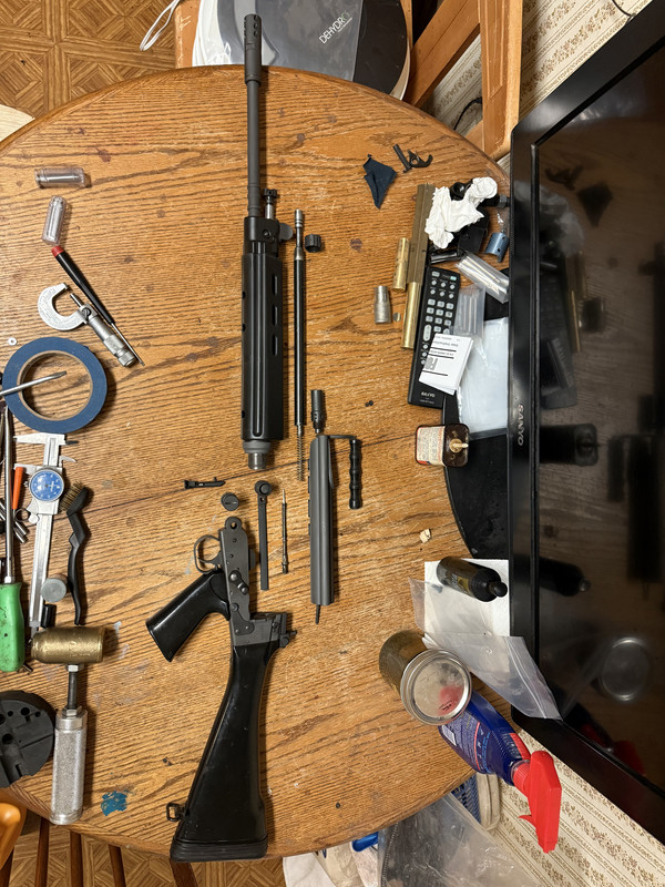

That’s a nice looking kit, I didn’t realize FAL parts kits were available in the $700-$800 price range. What is the condition of the barrel? If I wasn’t already overextended on gun stuff I’d put one of these kits away for a future build. Can’t wait to see how yours turns out. |
The bore and chamber look really good, the bolt carrier, firing pin, extractor, etc. were pretty much frozen up with old dried up lube. I don’t think it was fired much before it was put in storage. Edit: This photo is after I reparked all of the hardware and bought new handguards, not as the kit arrived. |

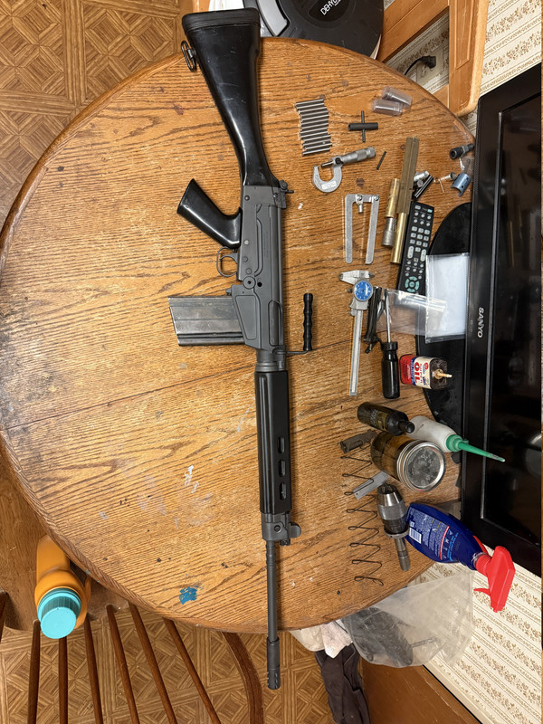

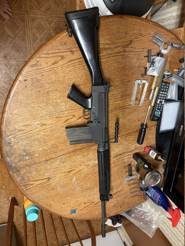

I built an Izzy a few years back. I’d built an AK before and used some of those tools to help with the FAL. Still needed others. My barrel needed a good amount of fitting. Ran into issues with some bent screws and needing the bolt tool. But I lucked out and headspaced perfectly with the same locking pin/shoulder. Ultimately, I’m no whiz with tools, so if I can do it, most anyone can. Attached File Attached File Attached File Attached File Attached File |
All you need are the correct tools, and a good eyeball for angles when assembling the barrel to the receiver (use alignment rods). A lot easier than an AK. Getting it to the clocking position it should be in prior to torquing is the part where you might need a lathe- or a file and a lot of patience. |
Originally Posted By BPR: Careful- it's a screw, not a pin. Originally Posted By BPR: Originally Posted By my65pan: I bought the tools I needed, and have a lathe if I need that also. I can’t get the mag release pin to move at all, I’m taking it to work to put some real pressure on it. Careful- it's a screw, not a pin. Checking my build notes, mine had been staked at both ends of the screw slot. But, I was still able to turn past them, so not terribly well. Depending on if and how well they staked, you may need to try to clear the staking first. |

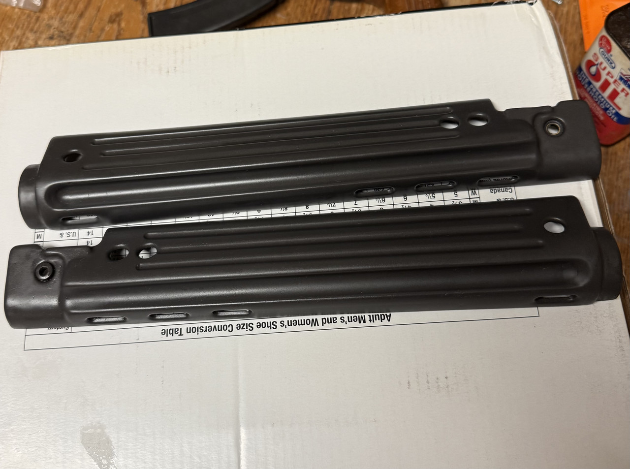

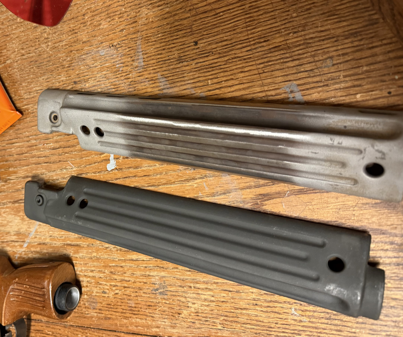

Originally Posted By my65pan: I didn’t care for the painted sheet metal at the gas block end of the handguards, so I blasted & parked them while I had my tank heated up for a different project. I realize this gun was originally painted over parkerizing, but I just have an aversion to paint on firearms. https://i.postimg.cc/tJ3FzKkJ/IMG-5095.jpg I never cared for the black enamel looking painted parts of the FAL either, always struck me as a cost cutting measure of a 2nd world government. Yours definitely looks better parked. |

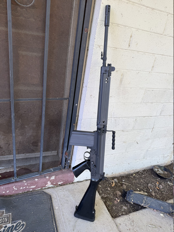

It’s done. |

Looks great! Used to have a local gunsmith who would blast and parkerize parts kits for a really reasonable price. He did a couple M1 Carbine kits that I built into complete rifles back when Springfield Armory was selling new forged receivers. Guns looked brand new when I was done building them. |
I made one off one of the L1A1 parts kits in the early 90's just before the AWB on an Entréprise Arms L1A1 receiver. Got lucky that it timed perfectly without removing any metal. Got unlucky that it took me five tries to get the right locking shoulder because I didn't take the time to understand how to measure for it. Lots of fun, but it stopped being semi-automatic for the second owner. He sold it on in straight pull bolt action mode without figuring out why. |
