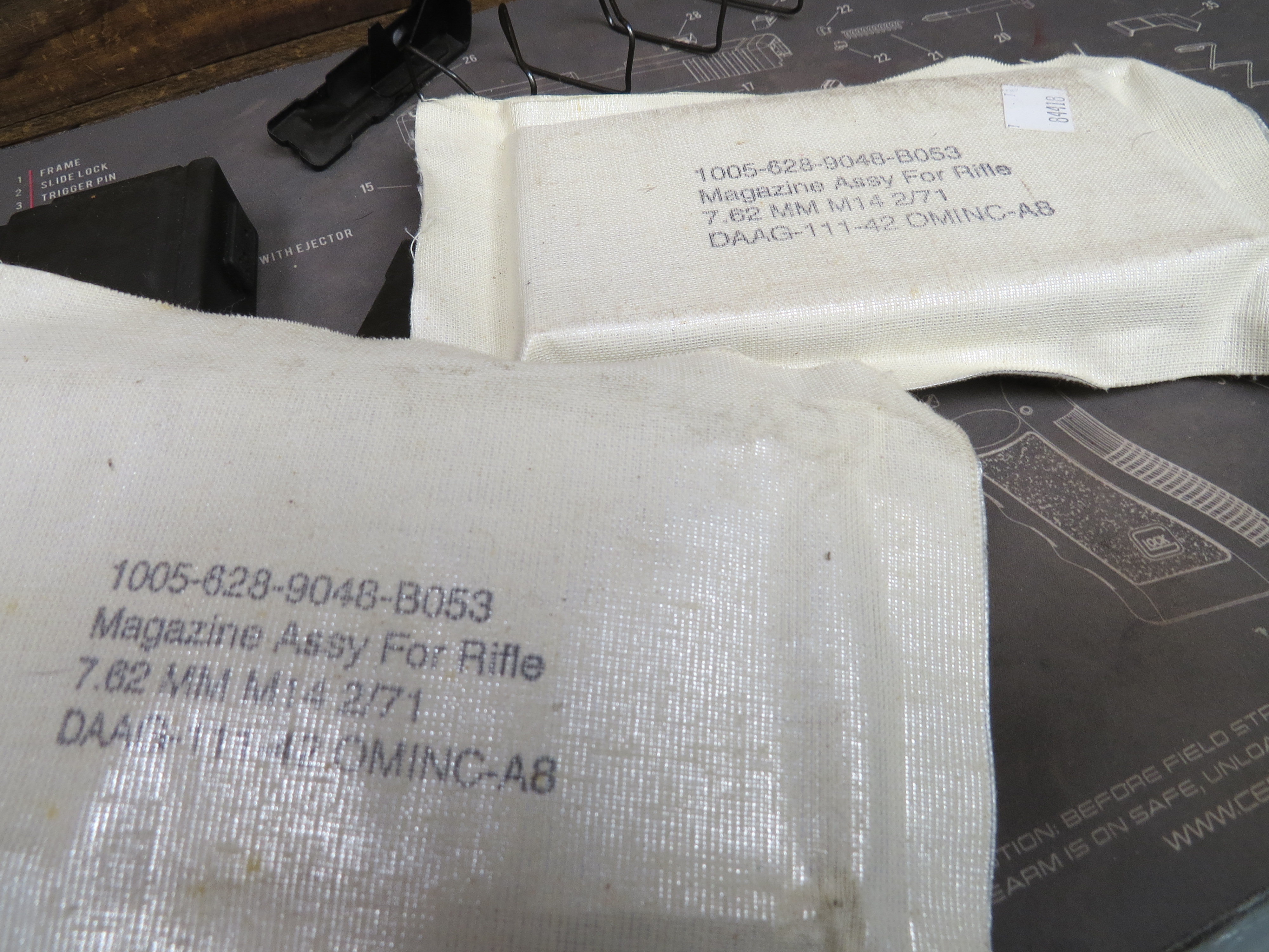

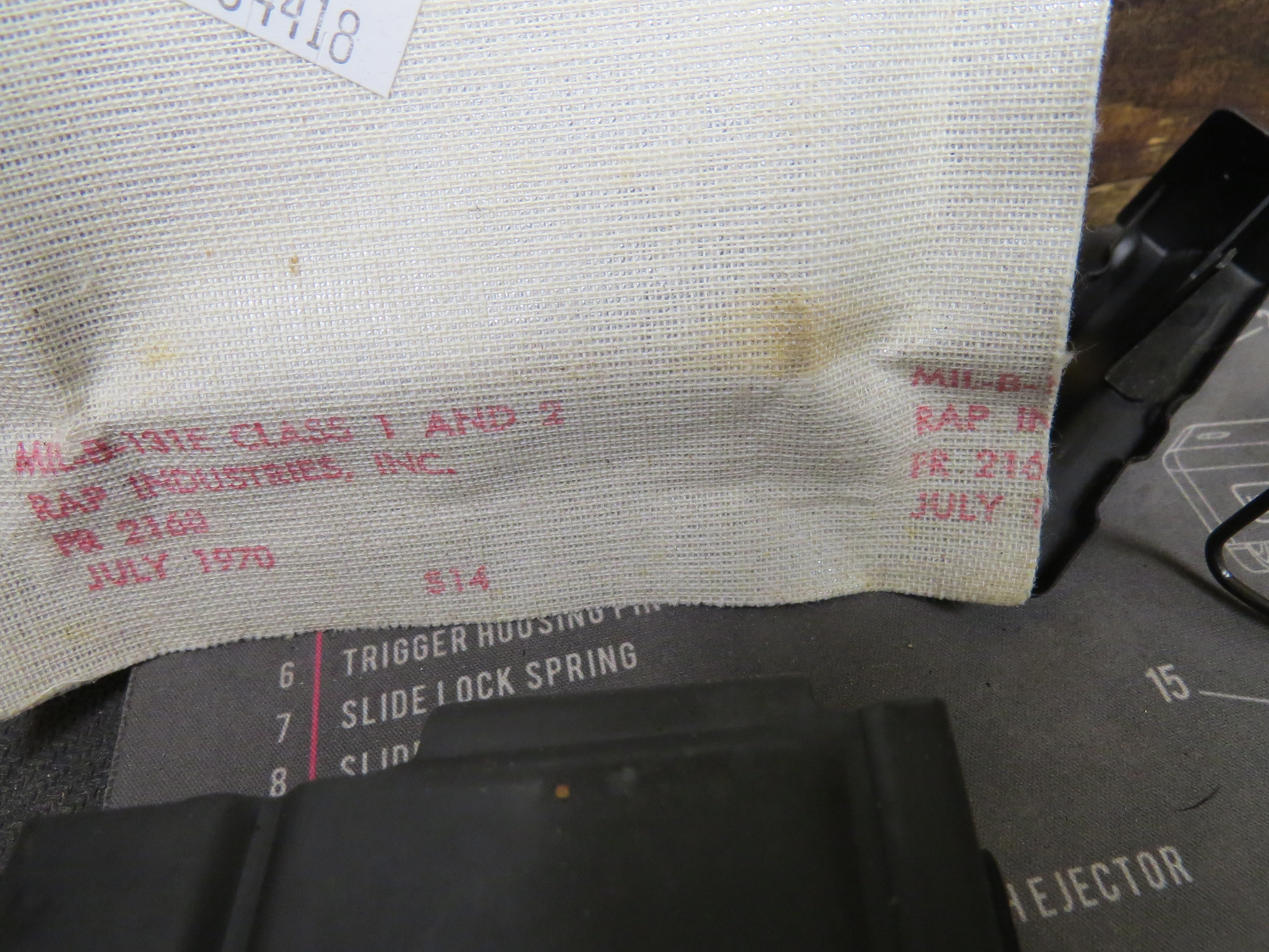

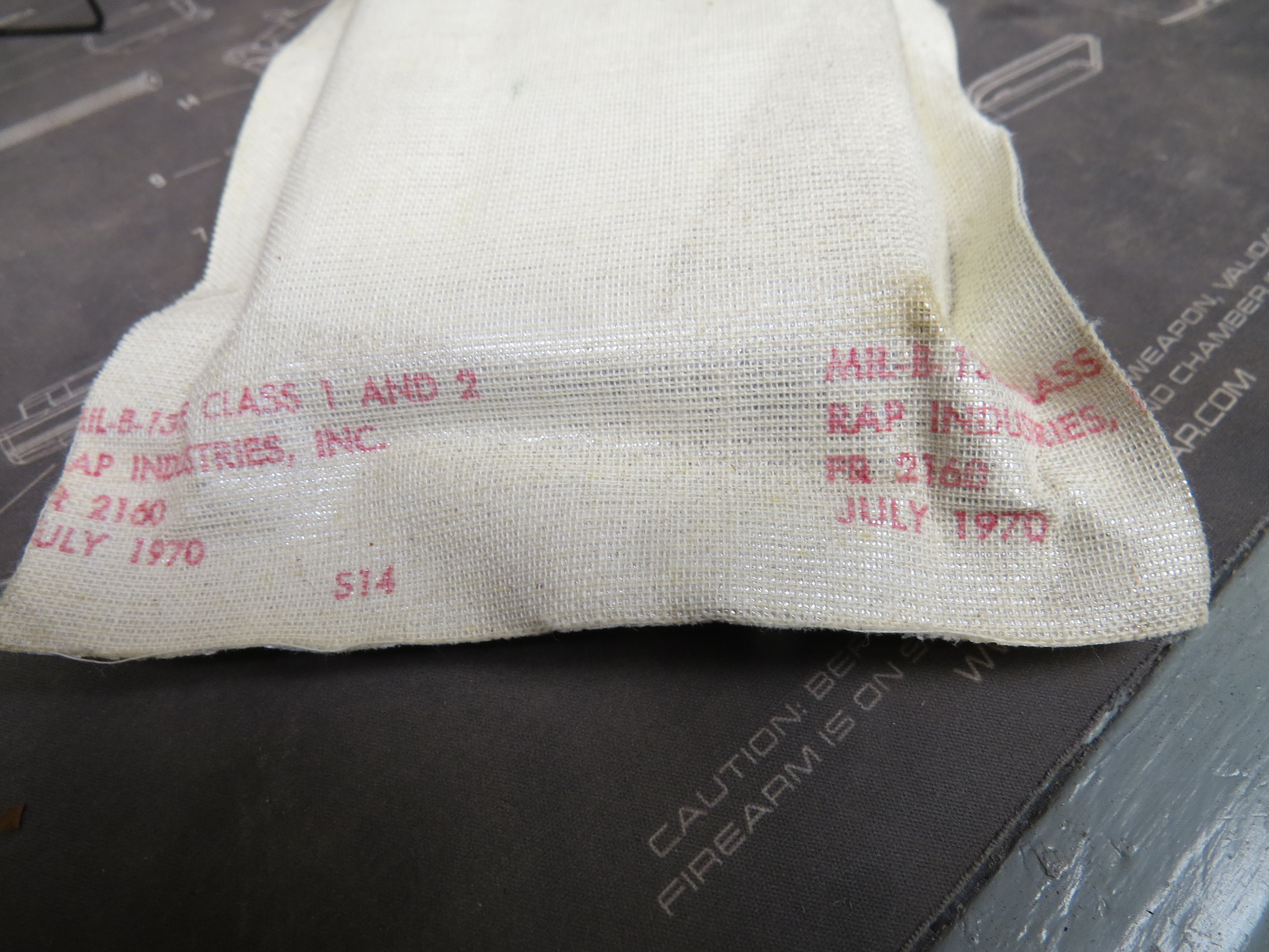

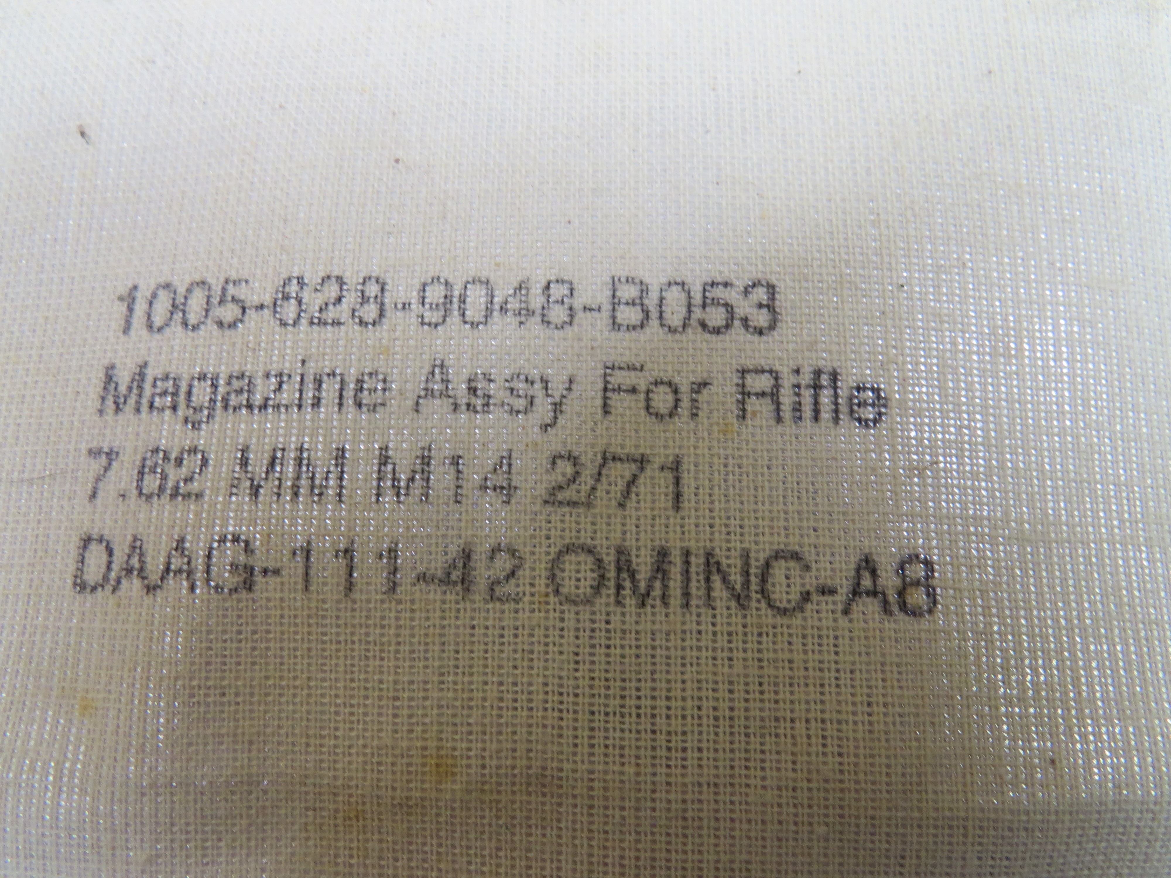

first the mags , one in sealed wrap , the other opened , wrap still present

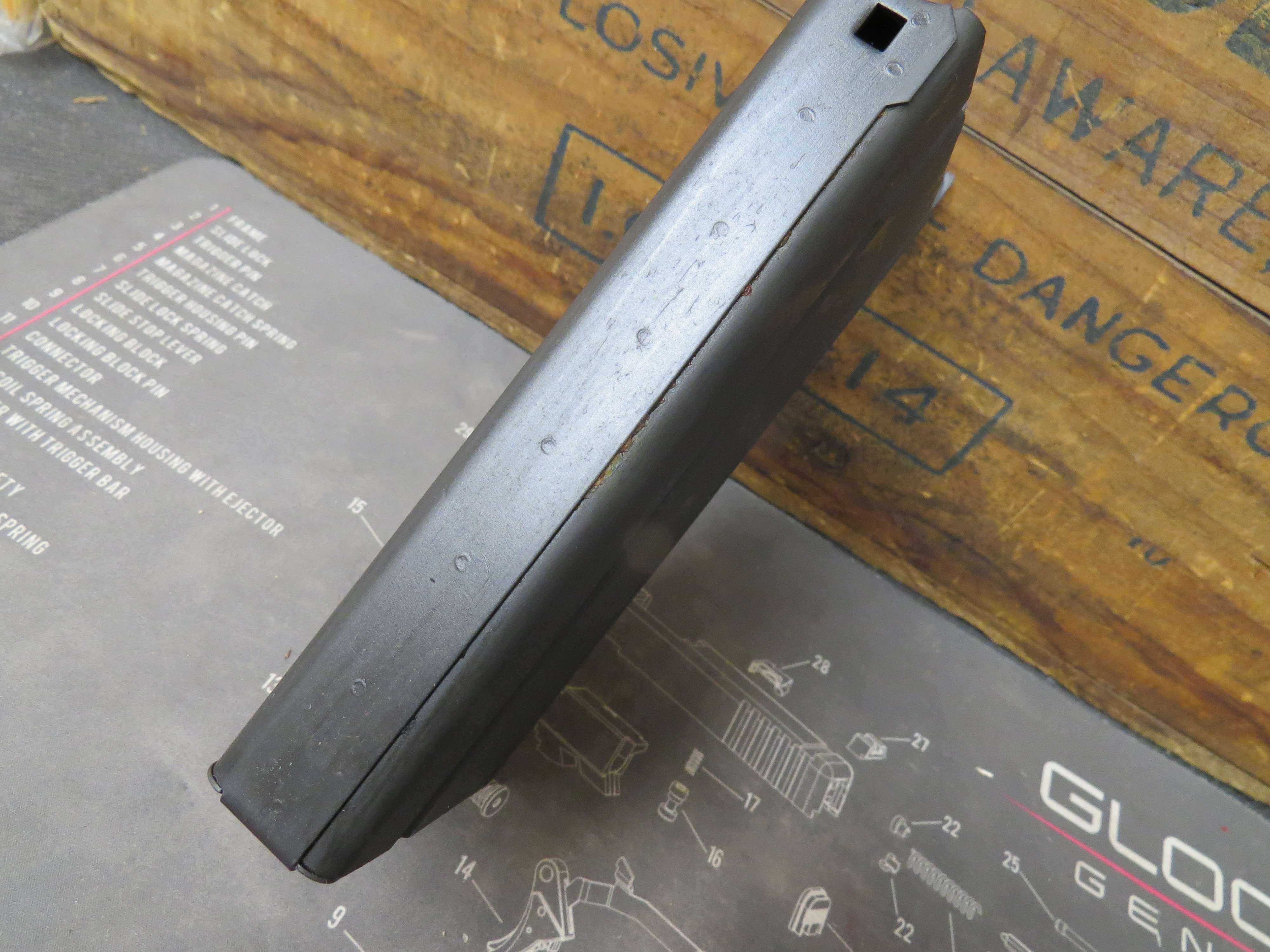

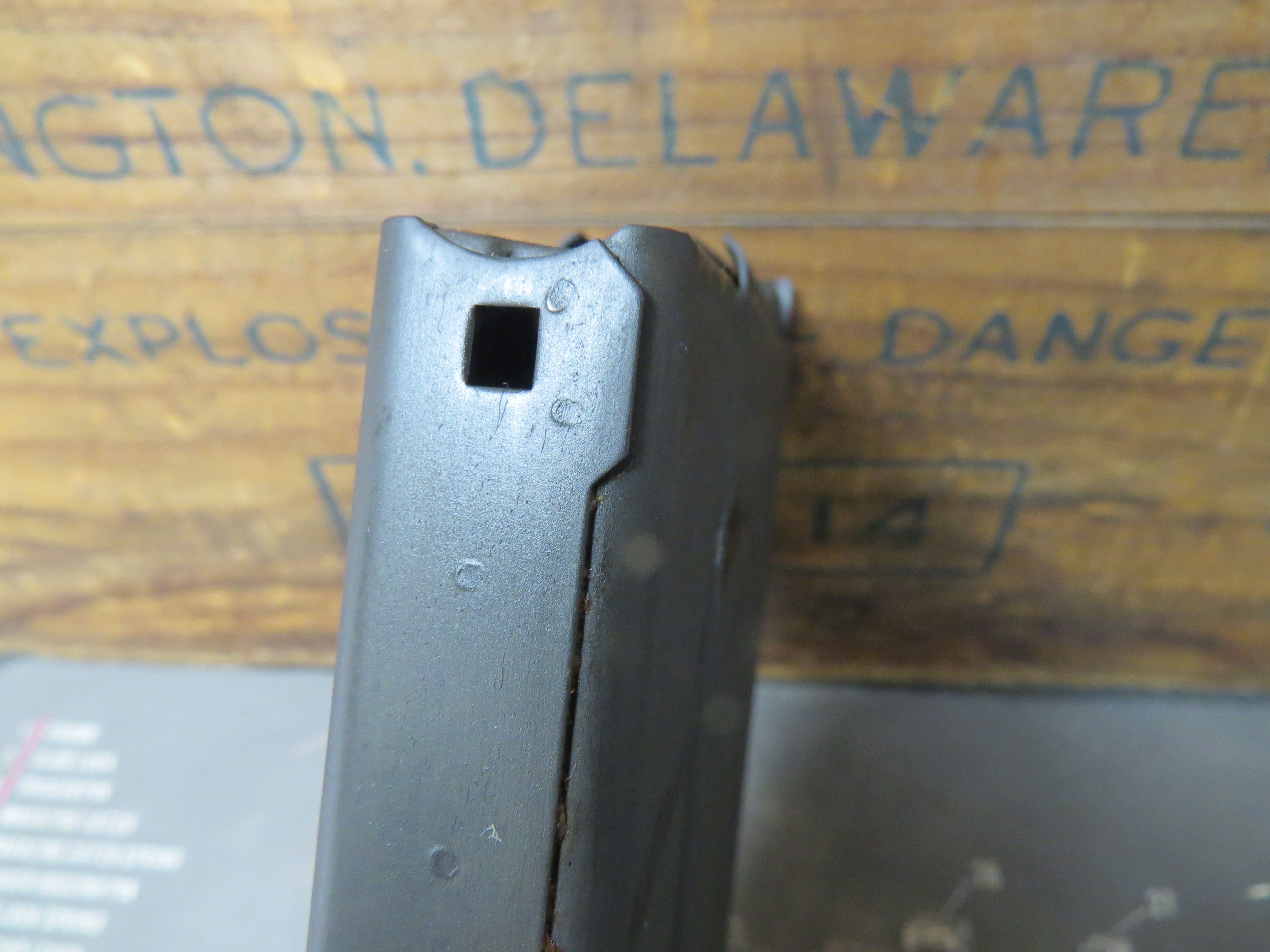

spot welds on the fold were one of the initial red flags , they were so faint i had to wipe a layer of oil to count , there were 7 , should be 11

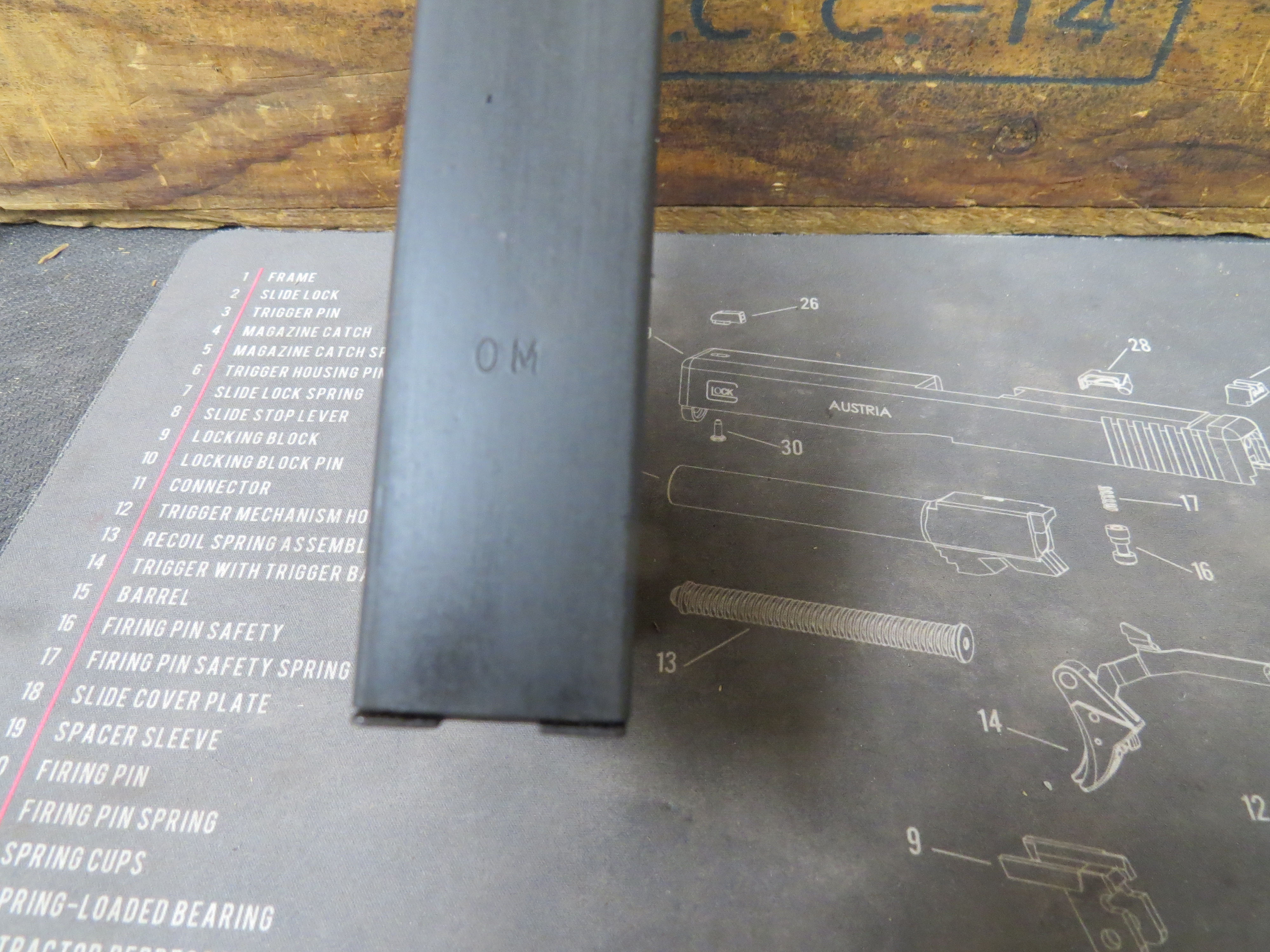

next was the placement of the OM stamp , it was higher on the mag than what i had seen on others
OM stamp on a good mag

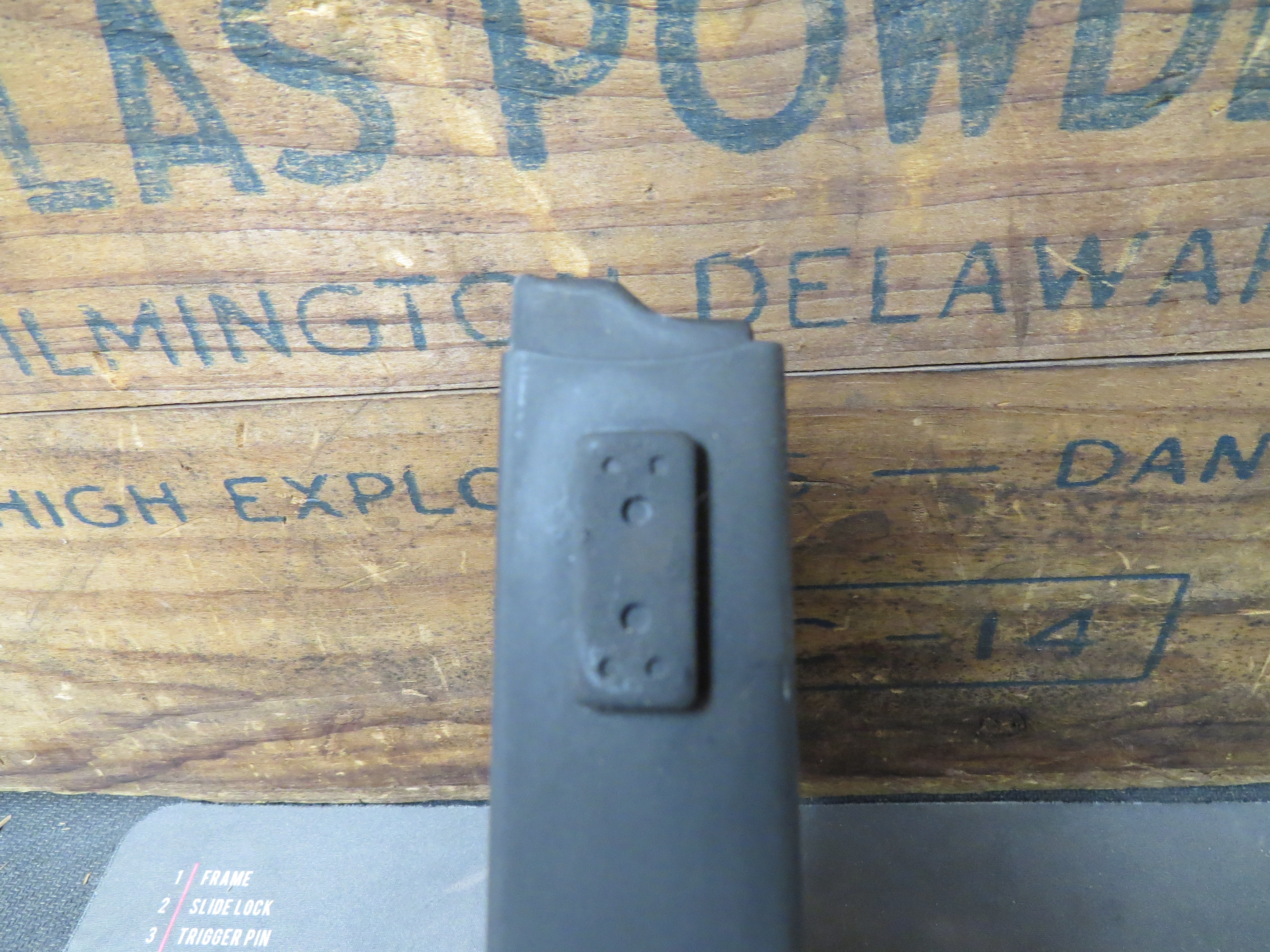

next the latch plate , should have 5 ,4 each corner then the 5th center low  , these mags have 6 , 4 each corner 2 center high/low

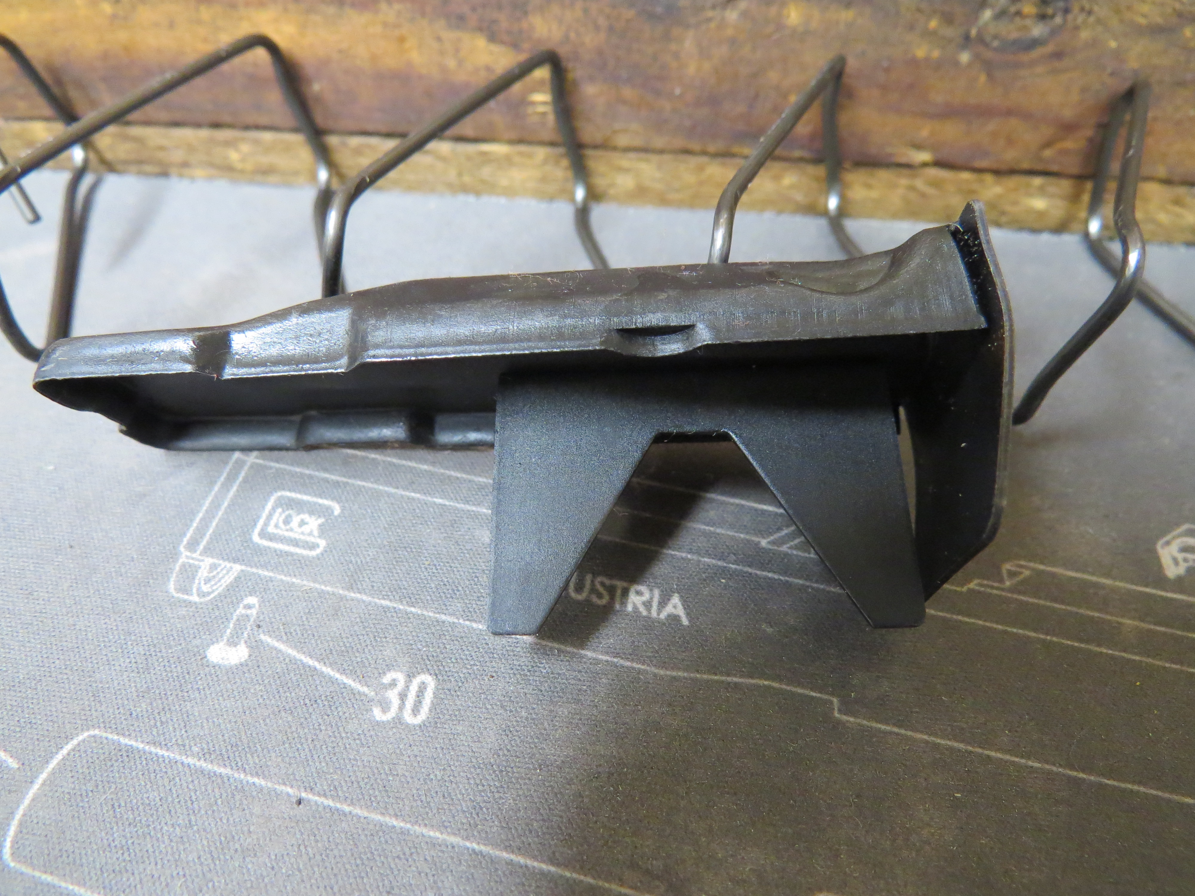

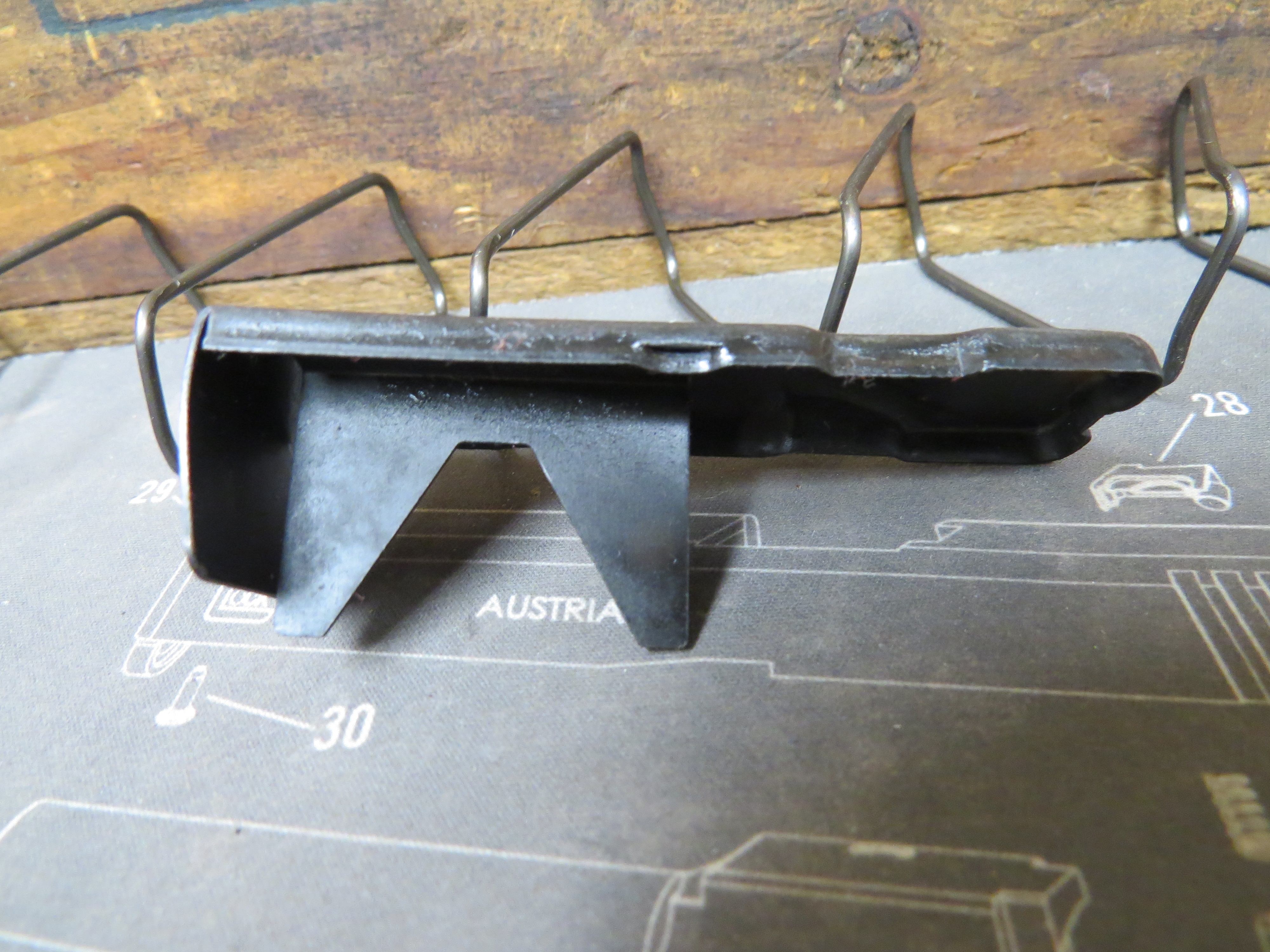

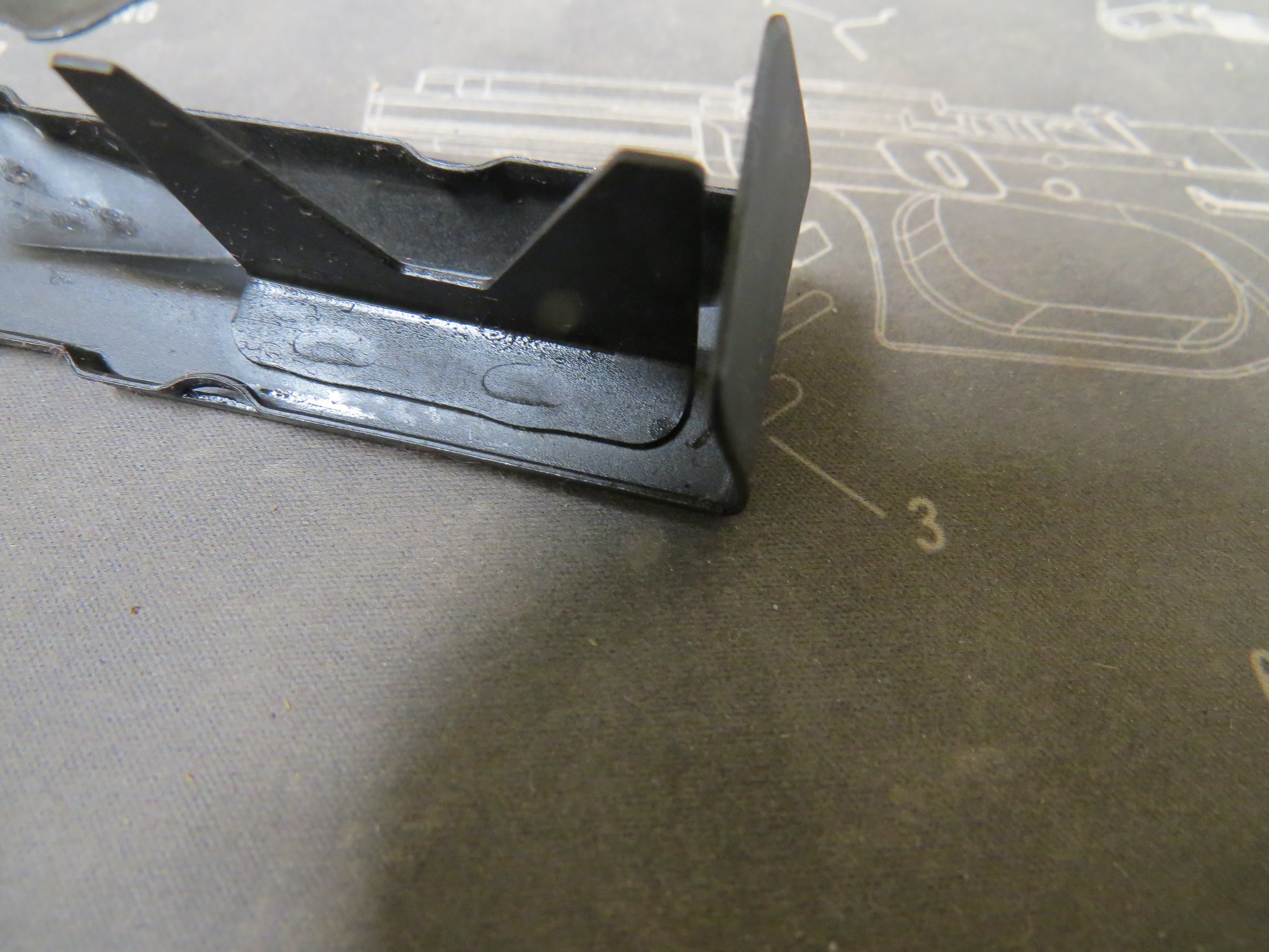

next the follower , should be OM marked left side  , also should have 3 round spot welds , this follower is absent the OM and has 2 oval spot welds

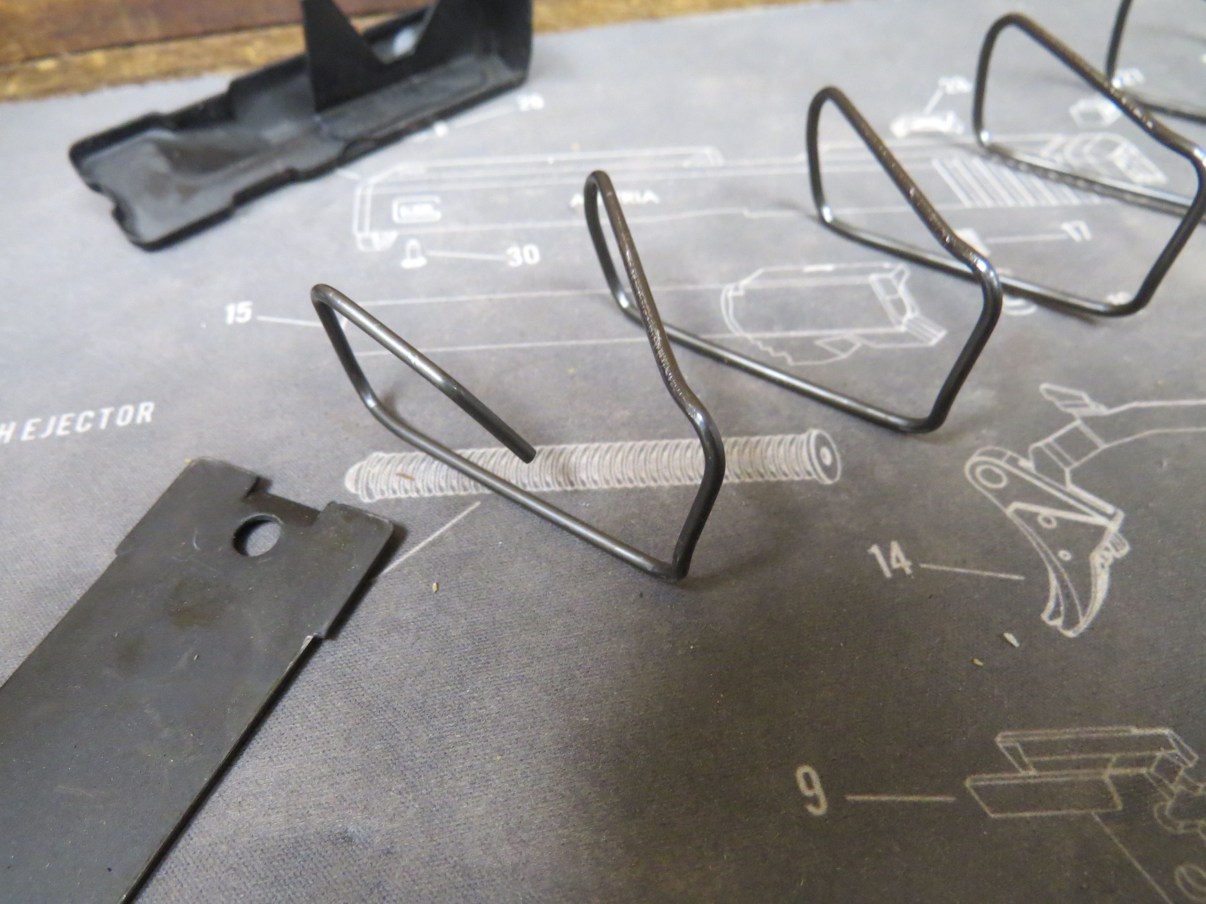

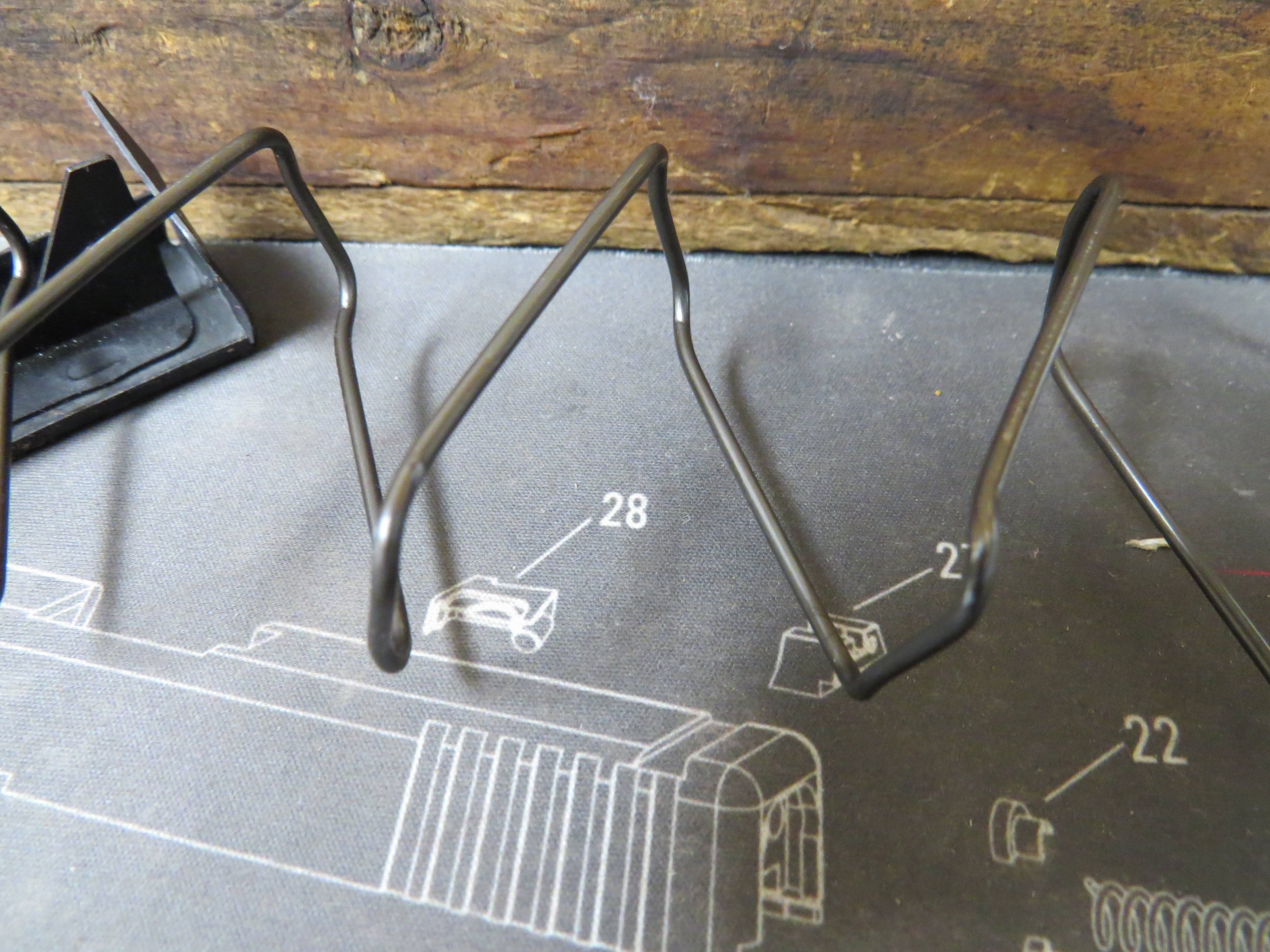

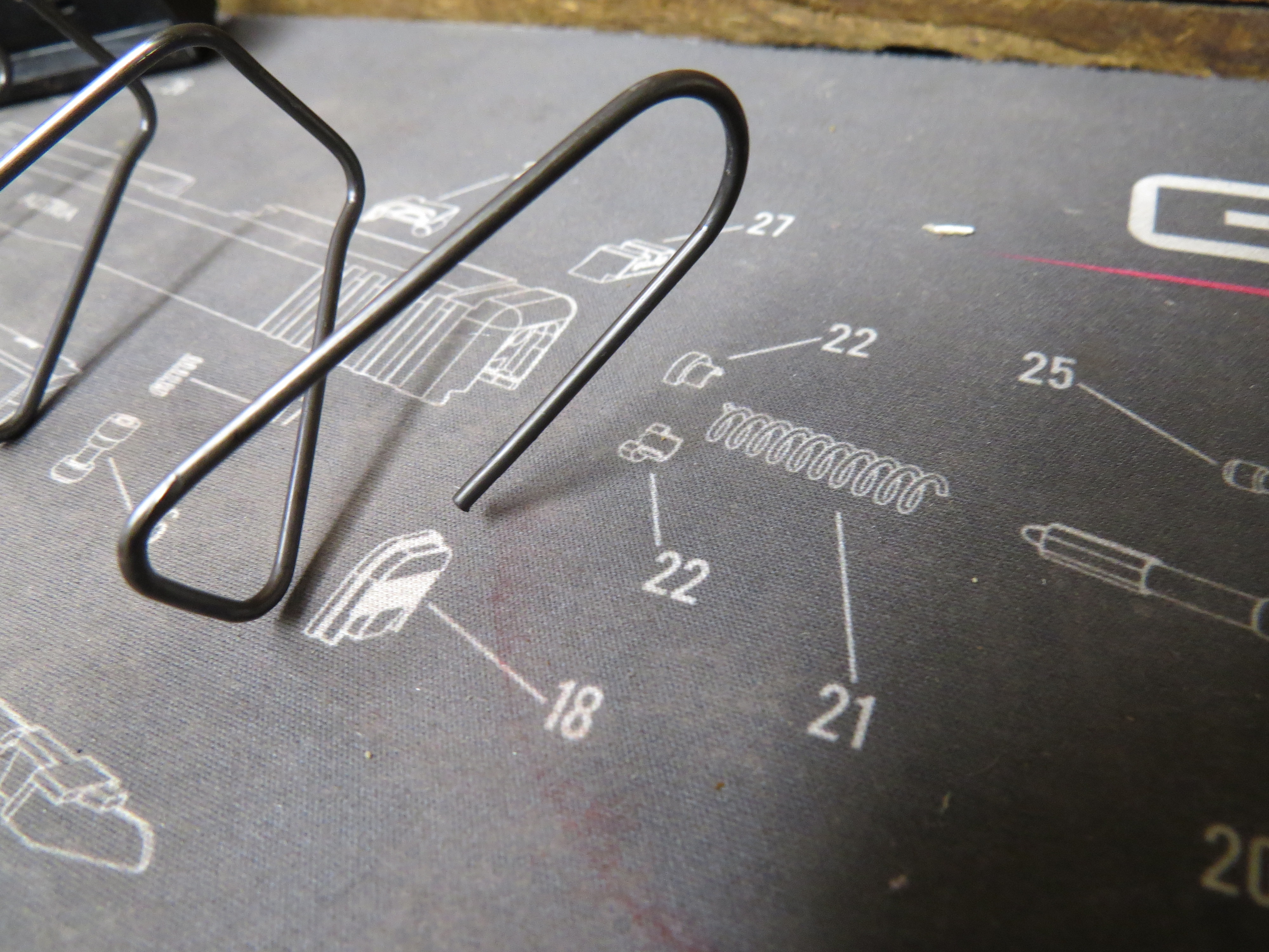

i have read that the springs are another tell tale however i do not see anything wrong with this spring , plenty of tension and does not appear "crude" as the fakes are described  , im including pics of the springs in case someone sees something they can elaborate on
