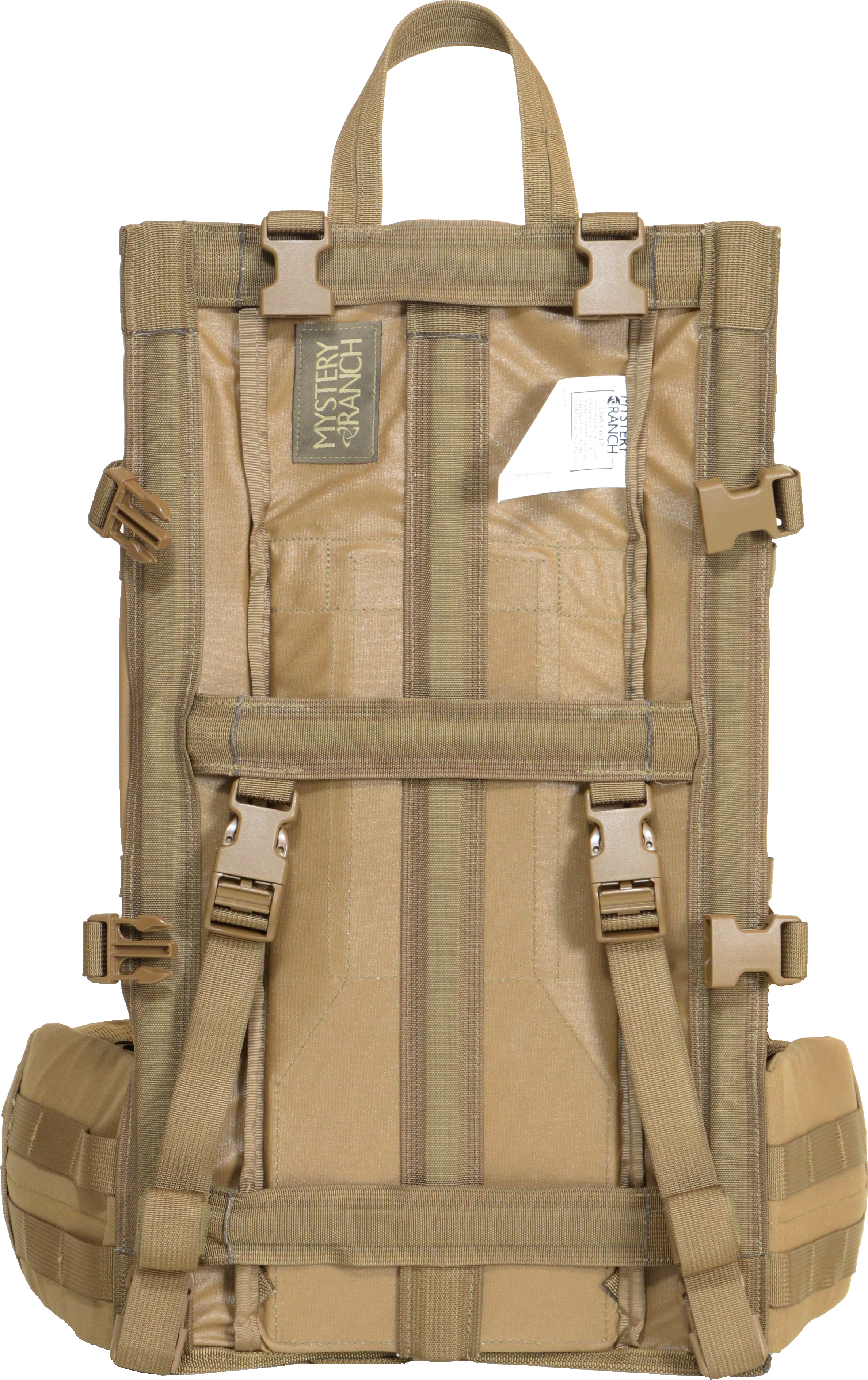

That's a lot of molle on the back pannel. Why don't you buy carbon fiber rods, cut 3 or 4 to height and shoot them top to bottom. Then cut some more to width and weave them horizontal to make a molle contained lattice.
If carbon rod is too hard or expensive to work with or created hot spots on your back, try 1" wide aluminum stock.
It would be like a poor man's internal nice frame from mystery ranch.
