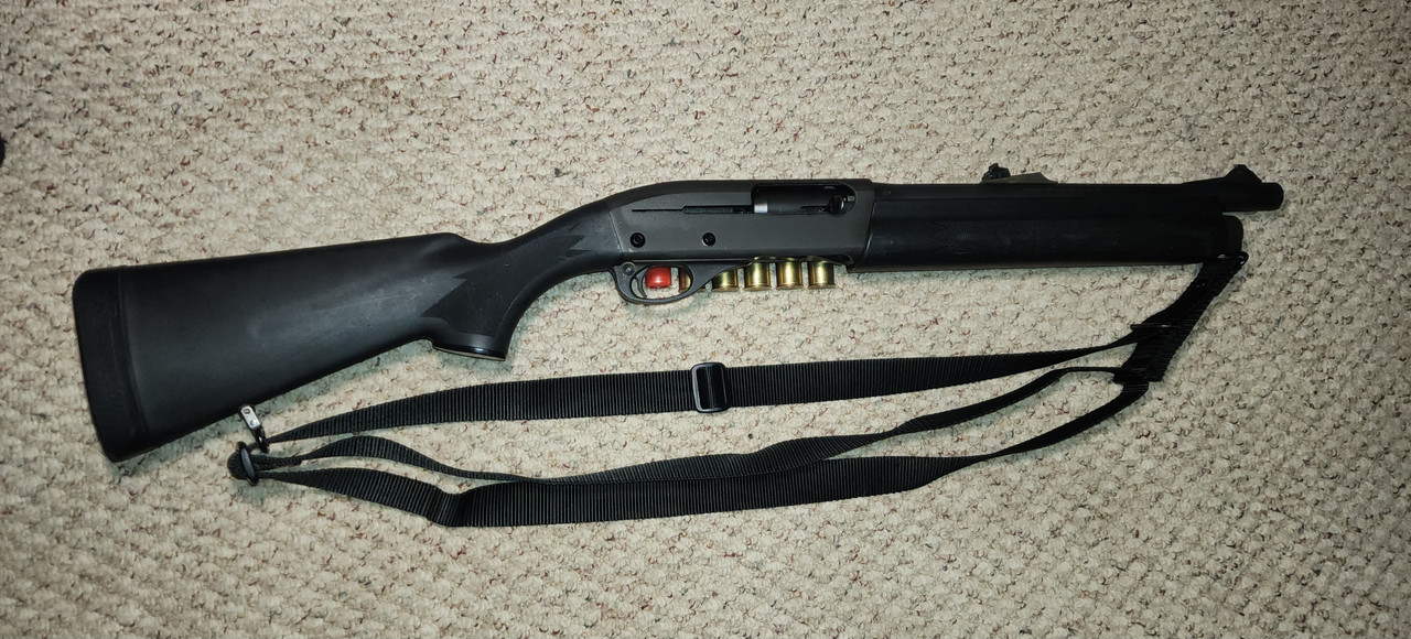

How effective are iron sights with short radius for slugs out 50 yards.

EDIT: Oh, now I see the photo (it was edited in). That's a different kettle of knives. You'd probably do just as well to ditch the rear sight (or install a ghost ring on the receiver).
BTW, that hardly seems like the best choice for shooting shit at 50 yards. That's more of an across the room sort of gun . . . which makes the whole sight set thing pretty questionable.
My original response:
Assuming we're not talking NFA type shotguns, the minimum barrel length on a shotgun is 18 inches. Compare the resulting sight radius of that gun to a 16" AR-15. If you can shoot an AR carbine effectively with open sights, you can surely shoot a shotgun effectively. That's especially true if you had a receiver mounted ghost ring.
Honestly, with a proper/consistent cheek weld you should be able to get pretty good results with a shotgun and slugs at 50 yards just using a bead front sight. We're not talking one-hole precision groups (slugs aren't really meant for that) but good enough to hit big targets.

I probably wouldn't have commented if the photo had loaded.
The best way to know in this case is to shoot the gun.  At a pie plate, I suppose.

Thanks, i didnt want to get too detailed but i should have given some more info.
It will be an SBS. Doing a Remington 11 with probably about 13" barrel. On the 11 the barrel recoils about 3". So best i would have is about 10" sight radius.
I would like to use it with slugs or 00 for deer in a shotgun only area of heavy brush. Plan is to send it to Rose and have it done by them with chokes and some type of sight. It has a rib and a bead or fiber optic front would be easy. But i have also seen where they have put a nice adjustable rear sight dovetailed into a rib. Seeung that is what got me thinking about having real sights even if they have a short radius.
The Remington 11 has a thin reciver and mounting a red dot or rear sight to the reciver presents some problems. But could probably be overcome with some work. I also have 2 barrels and would like be able to swap them. So avoiding putting things on the receiver would be nice.
Just exploring options.

I think they work fine, much better than just a bead sight.  Obviously a short sight radius doesn't give you the precision of a linger sight radius.   But that SBS barrels sight radius is twice as much as most pistols, and I can easily hit a deer at 100 yards with iron sights.

Found a picture of my 11-87.    Its sight radius is about what you are proposing on your model 11.

Folks hunt with handguns with shorter sight radii.  Sometimes up to 100 yards.  With a shotgun you have an advantage of having a stock for stability and a consistent cheek weld.
