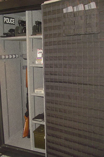

I am looking for a way to store handguns that is attached to the inside of the safe door. Something that uses minimum space (flat), won't mar the handguns, but is very secure.
Modularity would be a plus. I saw a thing with velcro which would be convenient as I have several different sizes from a small 380 to 1911's to a S&W 629 and Anschutz Exemplars with large scopes.
The panel on the door has something like carpeting and is 50 3/8" high, 20 1/4" wide.
Thanks!

Not sure what safe you have, but have you looked at those door organizers that use Velcro and clips to install to the inside of the door?   I know Liberty makes some and a quick Google search showed a bunch of different ones on Amazon.
12/21/2024 10:55:30 AM EDT
[Last Edit: SteveOak][Edited] [#2]
I have looked at the velcro ones. That would give me that maximum flexibility as to placement. I am wondering if the velcro is strong enough that they will stay attached. Industrial velcro is certainly strong enough. Will is be able to properly grip the material on the inside of my door?

My safe's door had a thin piece of carpet covered pressboard on the inside.
I pulled that off and replaced it with 1/4" plywood and covered it with marine carpet. Transferred the mounting hole locations from the press board sheet, then checked to see that the door would still close and lock properly.
Then, I put the plywood panel out and laid it horizontal on some sawhorses.  Next, I laid out a bunch of handgun hangers from Vertical Gun Racks (with guns placed in / on them to check for clearance etc). When it all looked good I drilled pilot holes and screwed the hangers down.
Some larger revolvers don't play well with those holders, in those cases I use two screw in hooks covered in several coats of PlastiDip. Same idea as the VGR hangers (pivot point in the trigger guard, and another pin to let the barrel rest against and set the orientation), just more clearance at the expense of your time and a not as professional look.
The VGR stuff works quite well in my experience, for the rifles and carbines also, and if you are a little creative can be very flexible. (E.g. screw them onto a few big magnets and you have a movable rifle holder.) But they have apparently gotten quite a bit pricier from when I did my safe door.

I just tried some industrial velcro. Does not hold at all to the 'carpet' on my safe door.
I don't think wood inside the safe is such a good idea due to flammability.

I found a big molle panel specifically for safe doors.
It came with some Pouches and cheap holsters, I bought more molle holsters from condor to addhttps://www.amazon.com/dp/B01KUBK3LY?tag=arfcom00-20
12/21/2024 9:36:37 PM EDT
Molle looks like a good answer. Unfortunately the one on Amazon is too wide. I  only have 20 1/4" so whatever I add will need to be narrower than that.

You miss the width on the medium by about an inch.  The next size down is 16” but the site says they reach out to33” wide door panels.
I’d feel better with molle over velcro by far.

They have lots of options and styles. Just look up molle safe panel, but here’s one that should fit.
https://www.amazon.com/dp/B01KUB2EFM?ref=emc_b_5_mob_t
