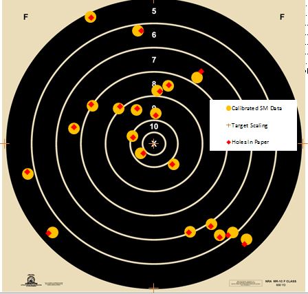

8/4/2026 3:33:43 PM EDT
[Last Edit: Trollslayer][Edited] [#15]
The paper does not "lie".
I did some more work on that target trying to better understand the ShotMarker error.
I manually placed a circle over every hole in the paper target as well as I could (yellow circles).  I plotted the circles' centers (cross hairs).
These are overlaid on an image of the paper target.
Also overlaid are the ShotMarker data for the shot locations (see the Legend).
The differences between the actual holes and the Shotmarker data are apparent.  Yes, the plot is very "busy".  There are 24 shots on the paper.
Mean value of offset in X direction:  0.12"; SD = 0.053";  n = 24
Mean value of offset in Y direction:  0.00"; SD = 0.056";  n = 24
The upcoming long range testing will be interesting.  It's also entertaining to shoot long range.  It is, hmm,... challenging.
Will the errors scale up on a larger target?
Are the errors a fixed amount no matter the target size?
Does calibrating a target reduce the errors?
I need to read up on the callibration procedure.

[Last Edit: Trollslayer][Edited] [#19]
The most difficult part of getting to an error estimate was converting the paper target to something I could process electronically.
You have to have the camera centered over the target and in a plane parallel to the paper.  Commercial places have a special camera stand to achieve that.  I got pretty close, but you can see a residual error if you look at the dead center - the photo's center and the plot origin do not intersect.
Placing the circles over the holes is a judgement call, especially for overlapping holes.
My error estimates has an error.  :-)
Nonetheless, it is close and shows what level of accuracy ShotMarker has achieved even though I have not had a chance to calibrate my system.
It's not yet good enough for a benchrest match but it is good enough for load development testing.

8/5/2026 6:49:47 PM EDT
[Last Edit: Trollslayer][Edited] [#21]
I had an opportunity to go to the range and I took it, uncalibrated electronic target and all.  I do have the paper target, which is all I usually get.
I don't know if you can understand doing that.
There is almost no information available about what the calibration process does.  If you, or anyone else, has information about exactly what the calibration routine does, please let me know.
From what little information is available, it seems like a translation of the electronic zero to match the zero on the paper target.  There is also discussion above that implies that.  Heck,
I can do that, too, and did exactly that.
Some have deliberately used that simple translation as a means of protecting the real center of the target.
Once I had the offset, the second step was to measure how accurately the corrected data matched the actual holes.  It was not perfect.
Any residual difference between the locations of the actual holes and the adjusted data would be a measure of the system error.
Going through this exercise taught me a lot about ShotMarker and the limits of it accuracy (which is darned good).
Its chronographing of shots at the target has also proven to be quite good.  It's much better than many people said.  That also took a bit of testing and analysis to confirm.

Your post #15 is perfect as an example:
-It shows EXACTLY what AI explains- the digital shot placement doesn't match the physical one.
-Why?  You didn't calibrate it.
-In fact, you could've used that very target you shot to calibrate it- "that is to say- adjust the system so the digital placement DOES match the physical one." (Maybe not 24 shots but say 10, because it is busy).
-If you calibrated it properly there would be no error.  (The digital and physical would match). (And also the basis for my comment of this being a waste of your time).
-now of course like any device the more carefully and precisely you set this up, the more precise result you'll get. Garbage in, garbage out.

I would guess that wind raises the noise floor and makes it harder to detect shots, although it would have to be one heck of a wind to completely obscure the supersonic "snap" of a bullet.
On the day I shot this target, all I was after was group sizes for the four different types of ammo.  The idea of an error analysis came later.
It was after I had evaluated the ShotMarker data and had extracted the group sizes that I started to think about errors in the Shot Marker data.
That started with a cursory evaluation of group size on the paper target vs the electronic data and an overlay of the data and the paper - they did not match.  That triggered a deeper dive.
They don't match exactly and likely never will.
Still, they're looking to be good enough for my purposes but I will keep watching the data.  Now that I have the spreadsheets set up, it should be a lot quicker.

Actually, my finding is that it IS accurate enough.  Although not perfect, it is good enough for load development testing.
When doing load development testing, if group size measurements are off by about 0.1 MOA, does that really matter?  If you shot 5 more or fired them on a different day, the groups are going to change by more than that just as a consequence of random variability.  In a ladder test, when groups differ by 0.25 MOA or more, I pay attention.  When groups go above 1 MOA absolute, I pay attention.
Reacting to a difference of 0.1 MOA between two groups based upon 3 or 5 shots in each is not wise.

I did some shooting yesterday at 600 yards.  It was an absolutely beautiful day up in the mountains.   The winds were breezy (~10 mph +/- 10 mph), a blustery day.
I never try to compensate for the wind, nor do I wait it out.  You'll see that in the image below (600 yard F-class target).
In no case was there any significant error in the Shot Marker data, relative to my requirements.
The scattered shots were deliberate.
The lower right string of 5 shots show the effect of the wind - all five were fired with the same point of aim, same ammo and same scope settings.  It is 6.75" wide X 2.25" high.  It is a benchmark showing my shooting and the day's wind and mirage conditions.
Between the setting up, tearing down, the shooting and a similar amount of work for chronograph testing over on the pistol line, this is all starting to seem like WORK.
At the end of the day, as I was driving away from the 600 yard line, I looked back and saw an array of steel plates and thought how much fun it would have been to have been shooting those, instead.
8/15/2026 12:53:42 AM EDT
[Last Edit: Trollslayer][Edited] [#50]
I changed the graphic used above.
The yellow dots are the Shot Marker data after calibration.  The yellow dots are 0.2 MOA in diameter.
The red diamonds are the actual holes in the paper.
I would say Shot Marker did pretty darned well.
I bet my error measuring the hole locations on a LARGE piece of paper was as large as Shot Marker's error, maybe more.  I need a better way to measure these.
Next time, I will do the test at 1,000 yards.
