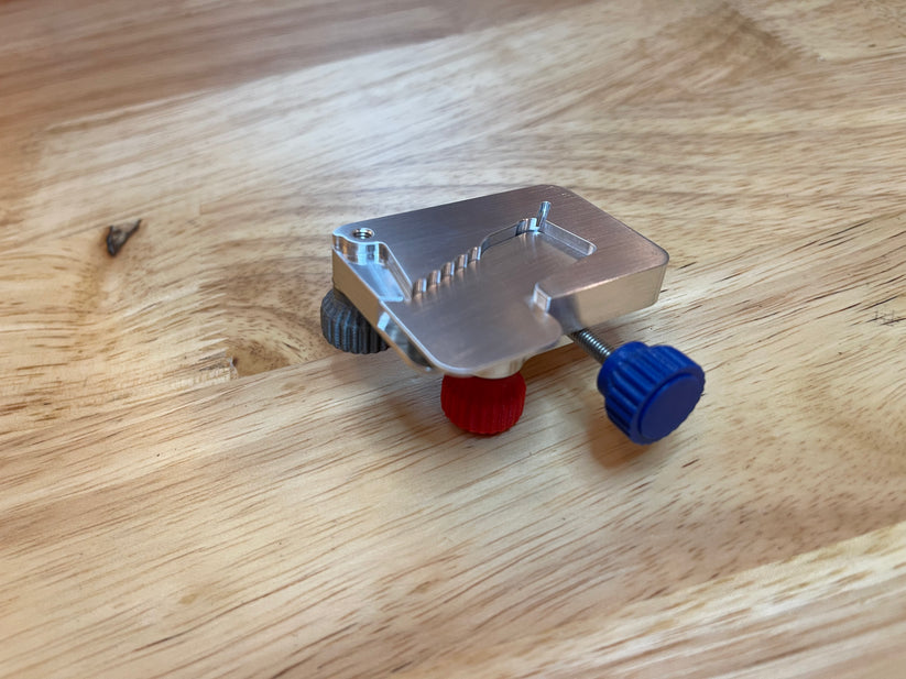

My Mr BulletFeeders run really well.  Not 100%, but I am not 100% either.
Once I added a Range Panda bullet feeder flipper guide, changing bullets became painless.  No more shims.
Range Panda RPG2
