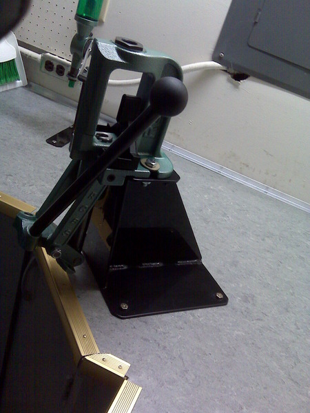

I'm using a RCBS Rock Chucker Supreme press; I'd like to raise it up a few inches so that I might move it more towards the center of my bench rather than have it hanging off of the front edge.
I've looked at the Dillon Strong Mount and it looks like it might do the job.  My question- have any of you used a Dillon Strong Mount with your RCBS and what were the results?  My other question- is there a substitute to the Dillon Strong Mount that I've overlooked?  Thanks in advance for your answers.

I made my own "strong mount" for my RCBS Ammo Master press out of some 1/8" mild steel plate.  It took less than an hour cutting it out with the bandsaw, bending it with a metal break and drilling the holes.  I couldn't use two symmetric pieces like the Dillon mount since the Ammo Master uses a three hole bolt pattern, instead I just made one side an 1/8" shorter and overlapped the two and it has worked great.  It is nice and sold, even resizing for the 50bmg.  Once I got it mounted and saw that it worked, I just never took it back apart to paint it, one of these days I may get around to it.
7/6/2009 9:42:19 AM EDT
[Last Edit: bartonmd][Edited] [#4]
Yep, that's me...
If you've got the facilities to make one, I can send you drawings...
If you don't, I can make you one... PM me, either way...
ETA: It's made of 7ga (0.180") HRS....
Mike

I can't comment on the RCBS but I modded a tall Dillon strong mount for my Redding T7.  I only had to oval the existing bolt holes in the mount for everything to line up.
4/11/2010 6:45:43 PM EDT
[Last Edit: TrapShooter05][Edited] [#27]
Another satisfied bartonmd customer! As you can see in the pics I had to get a top plate for mine. This was due to the differences between the RC Supreme and RCII (thought never crossed my mind till after the fact)... not sure about the other versions (I had to move my press out about 7/8 of an inch). If you request to have one made make sure you determine what version you have. Mike is a top notch guy to deal with! The mount is built like an anvil!

That adaptor looks good! Sorry, I didn't think to ask if you had the current model Rockchucker Supreme!
Could you send me a pic from the side, of the handle mount/base with the ram fully up?
Thanks,
Mike

http://i1097.photobucket.com/albums/g359/Warm_Garand/Strongmount%20for%20RCBS/StrongMount4.jpg
http://i1097.photobucket.com/albums/g359/Warm_Garand/Strongmount%20for%20RCBS/StrongMount2.jpg
A section 2' long weighs about 50 pounds, and I figured 50 lbs of steel would stay put all by itself, but I find that when full-length sizing brass it wants to lift, so I put the smallest of C-clamps on the end and that's all I took to make it rock-solid.
I'm going to sandblast off the rust, prime it, and paint it up nice.  I think I'll also add a couple pieces of angle-iron mounted lip-up, so I can hang bins to the right and left, like the Dillon Strongmount.
The one other nice thing about using I-Beam is that my mount is now totally portable––undo the small C-clamp and I can remove the press from the bench or put the mounted press on any tabletop.
Might be an idea if you don't have a dedicated full-time reloading bench or you want to swap out entire presses quickly.
––Eight_Ring
Now that's a great idea.
As a fellow scrounger / good deal hunter your solution looks great to me.
Nice pics.

Mounts for most presses ect.

[Last Edit: 808state][Edited] [#48]
You know I always thought the mounts were for progressive presses but after seeing all the single stage presses on them I'm starting to think I may go that route.  It will sure make finding or cleaning things that fall off the press easier to find or clean from the bench top rather than the floor.  And yes area lighting from the above link is a nice upgrade as well:
