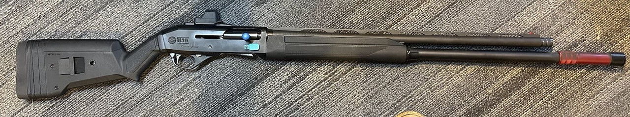

I was inspired to add a red dot to a shotgun so ordered a cheap Chicom mount $20 and my cheapest shotgun, a Mav 88.  Tools were a 8-40 tap/drill bit set for $10, a bag of better and longer 8-40 screws $6.  The first test was this:
I found an Osight C red dot at the local gun show and kept with the cheap theme.  The O sight is a Circle/dot which I prefer on shotguns.  I am impressed with the window size, mounting assortment and packing included.  It will be a torture test.  I was able to sight this in fairly quickly and with the 2 moa dot was able to hit a 12” gong at 100yds with mini slugs.  This is fun as a mini shell adapter will have this hold 10/11+1 shells.

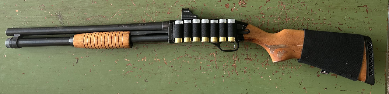

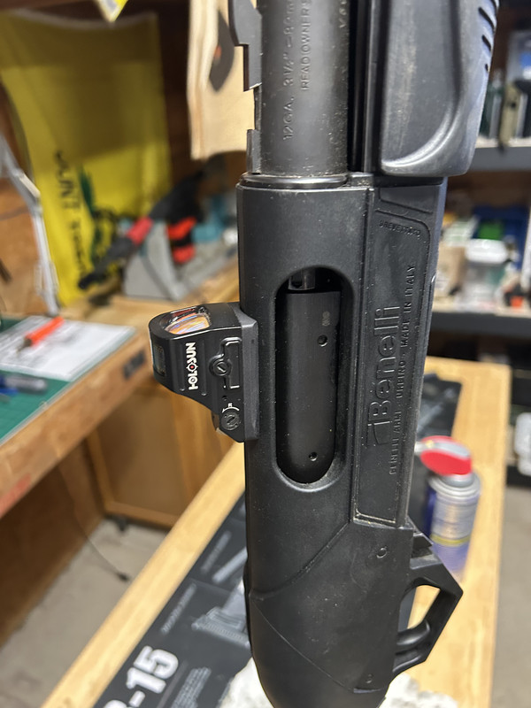

That was fun so I ordered some RDS mounts from GG&G which are more low profile.  Nicely made and packaged, screws and tools included, about $35.  Next was the Benelli Supernova:
Then today the mail brought some more GG&G RDS plates.  Win 1300:

[Last Edit: dogtired][Edited] [#2]
The GG&G mount is super low and solid.  Well priced I feel.
I used a Scalar Works mount on a D&T Benelli patterned receiver.  It is nice and low but at $120 I don’t want to go there.  The two aluminum receivers have a ton of length on the mounting screws so little worry of backing out.  The Supernova receiver I just copied the factory location and had nice purchase in the steel.
The nice part about the GG&G mount is you can install it without a dot and it is unobtrusive.
