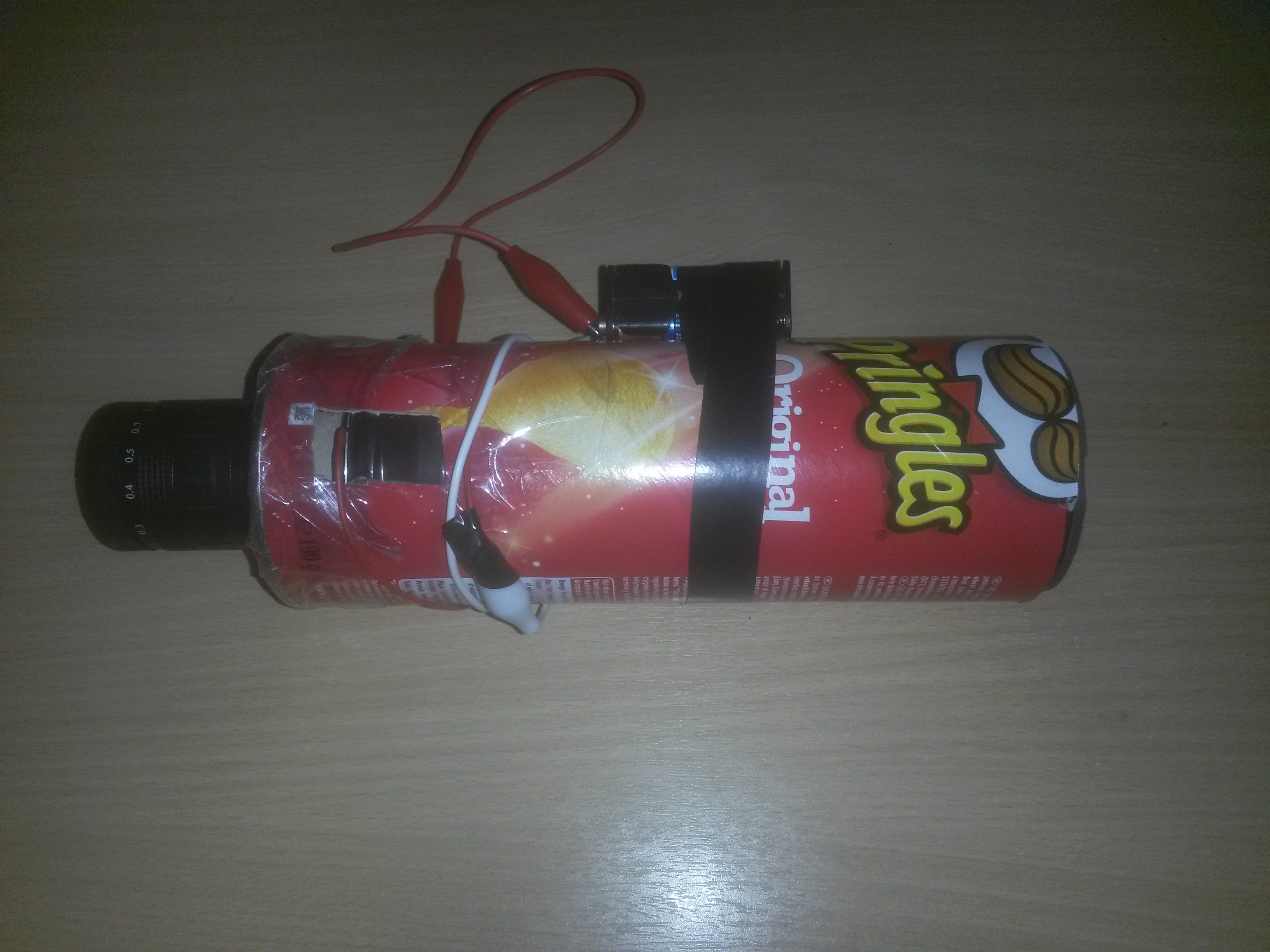

Link Posted: 11/12/2014 4:41:06 PM EDT
Hi Guys,
I have quickly rigged up my lens and my tube to see if it would focus correctly when powered up.
I used a Pringles tube because it was cheap and delicious, and seemed to do the job very easily.
I had a job with the soldering, even after cleaning and sanding the inner ring, the solder didn't want to stick, but its on there for now.
The only concern I have is that there is a crunching sound and I think that it dims a bit over time, I only had 5 mins to play so will try again tomorrow,
Here's a photo of what I have so far.
Hmmm i probably need to scale the image :)

hello Brucifer!
cross hairs are just two pieces of .024mm tungsten wire glued with epoxy to the tube retainer.
thicker .09 wire can be seen here,now it has been changed to .024.
this is old picture.
