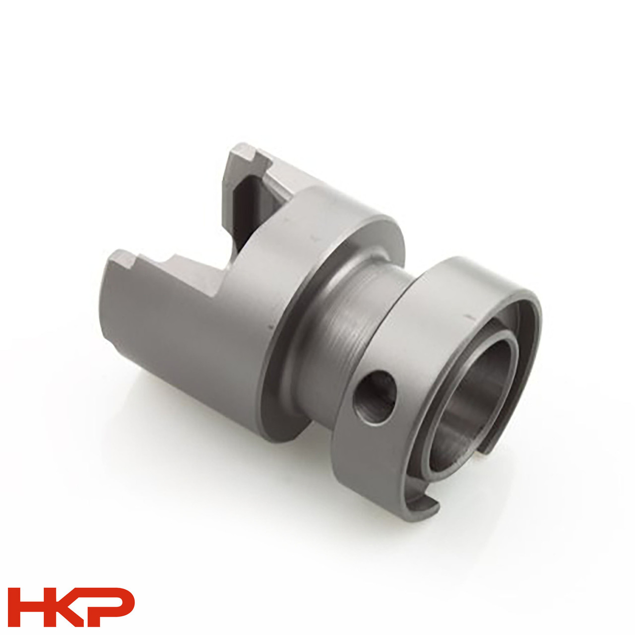

Doesn't the SD have a specific trunnion and bolt group aside from the barrel?  It quickly goes from "okay, swapping the barrel may not be too bad" to "may as well build it from scratch" with all the parts and work.
Support the Firearms Policy Coalition and help save the Second Amendment: https://www.firearmspolicy.org
11/14/2024 6:06:34 PM EDT
There is a SD specific locking piece, so that is one more part that needs to be corrected.

11/14/2024 6:25:40 PM EDT
No the trunnion is the same, bolt group aside from the as mentioned locking piece ( Which needs to be swapped for a 115 or 120. ) is the same.
Which is pretty simple part swapping and all available from RCM direct.
So basically, a no welding required swap.
Now swapping the barrel may be a little bit touchy for some but it is an unpin, press out, press in to bolt gap spec then re-drill ream and pin.
So a no weld no refinish SD conversion... Maybe.

It would be nice if the AP5SD came with the correct locking piece (fitted to the gun) for using a suppressor.
It also be nice if we could buy MKE #28/80 deg locking pieces.
Honestly, already owning a AP5 and AP5-P I don't see myself buying the SD model.

Re the correct ported SD barrel...
Personally, I'd rather just use my already existing Gemtech Lunar 9 suppressor on a short 3 lug barrel than having to buy another correct suppressor that uses the ported barrel.

So if money and availability of parts was no object, would you send a HK94 with an original German MP5SD front end/parts kit to get the cage/cocking tube/frame installed by a renowned builder (TSC Machine, RDTS, Murray Urbach, Fleming, S&H, Mike Otte) only to have your builder swap out the ported barrel for a K/trilug barrel in the converted final product?
Why would you even buy a MP5SD or any integrally suppressed firearm if you don't want the sound reduction/performance advantages?
Form 4's are taking very quickly to clear, some people have even spoke of same day approvals. If you can afford a $1.6-1.8K PCC, a $600 suppressor plus stamp isn't unreasonable, less if you are a wizard with a lathe and make your own F1 can (or convert a faux suppressor). Or you can just shoot it with the faux can on and brace and make it a no-stamp gun. It still puts holes in paper/rings steel and you still get the iconic look of the MP5SD, with the option to put a proper can on it if you change your mind.
The gun is also much more desirable/collectible with the correct ported barrel.
