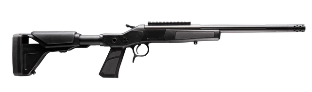

They are producing pistol grips from the factory now.  The pistol looks like it should be SBRed.  Mil Spec buffer tube.  No word if they sell the stocks separately
11.5 barrel on the pistol.

https://bpioutdoors.com/scout-xp/

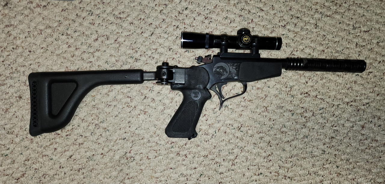

I did a similar build with my TC Contender.   Cut a 14" .44 mag barrel down to 8" and had it threaded.   Also cut a 10" .22 LR barrel down to 5" and had it threaded.  Used a Choate folding stock.   Nice compact little gun.

Niiiiiiice

First, really nice rig!
Want to do something similar with my Contender, am curious on where you engraved it. Was looking at putting my name on one side of the receiver that is covered by the grip & the location on the opposite side.
Thanks for the help.
